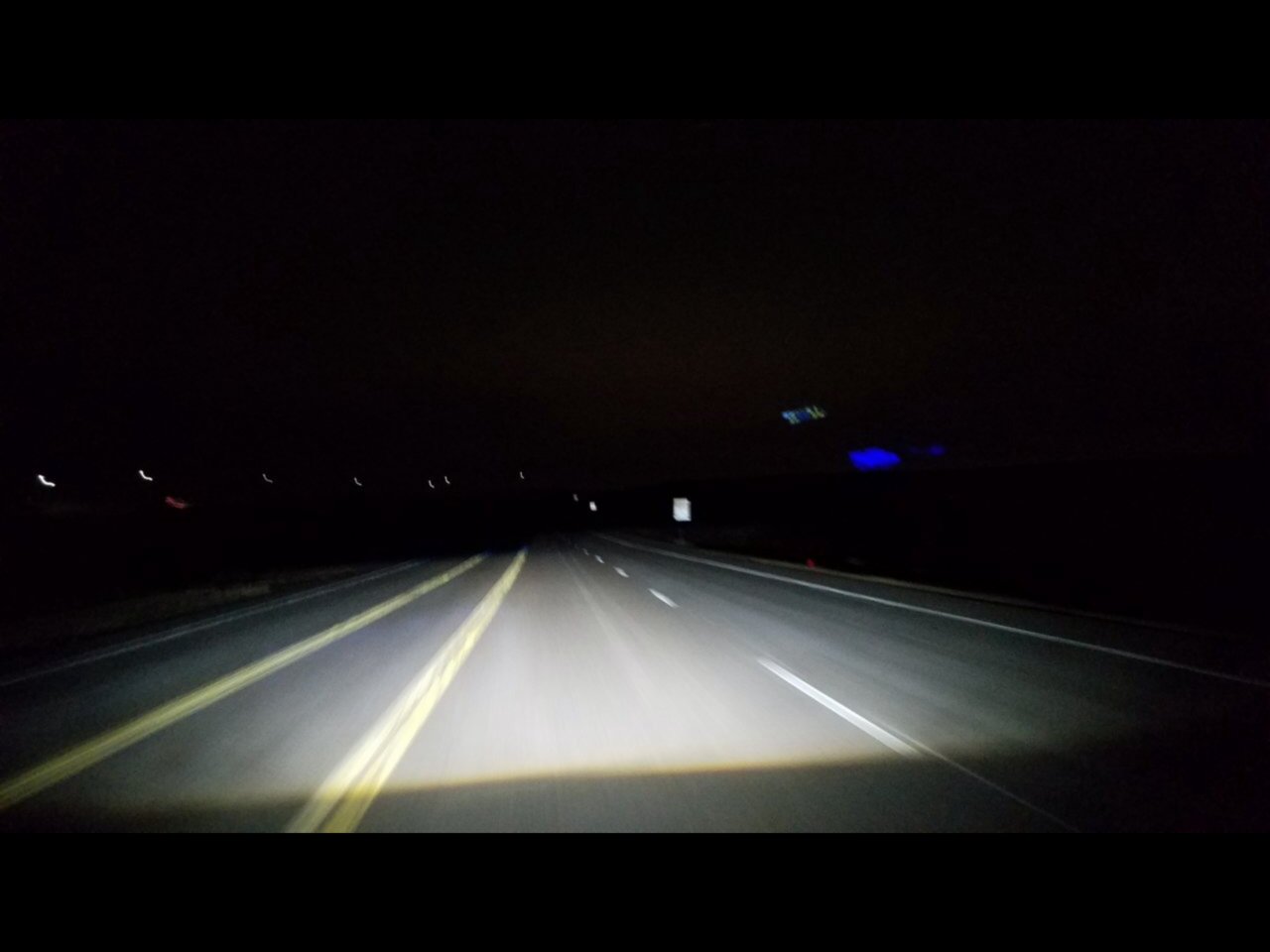

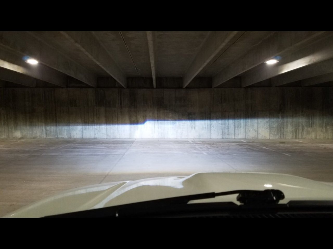

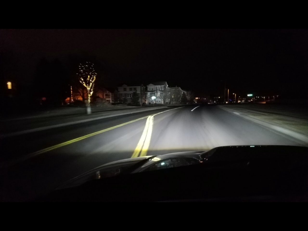

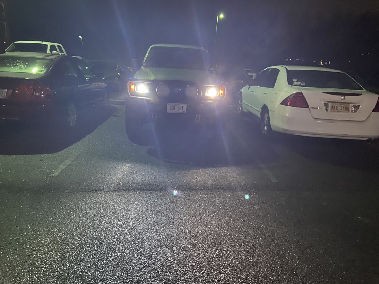

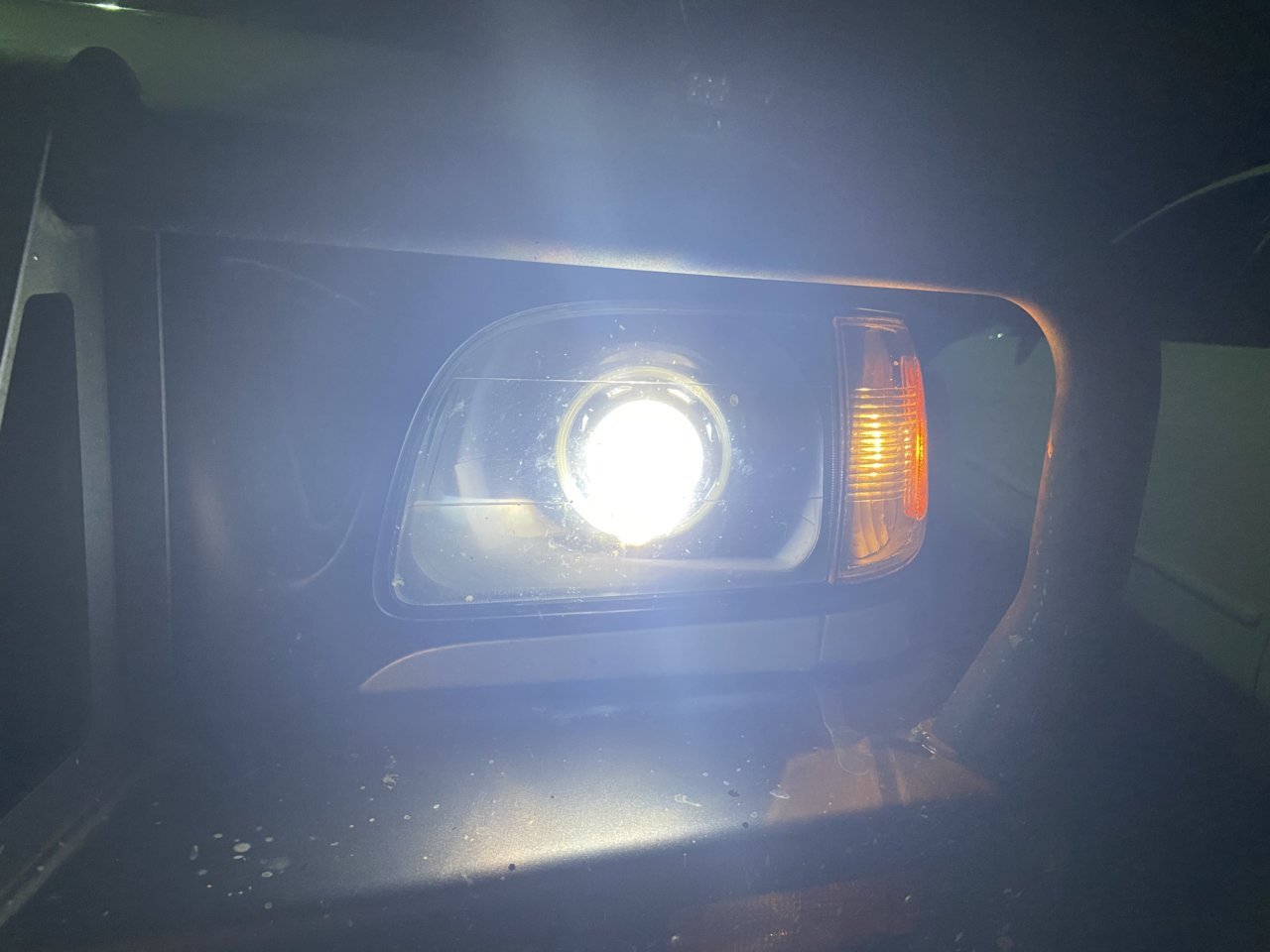

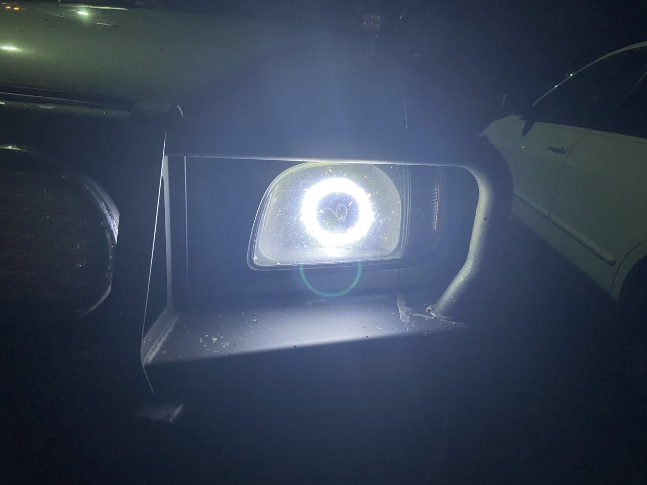

    @jdmstuff maybe one of these pics is what you are looking for. If you have any other question I’m more than happy to help all I can. Mine are wired so the halo is on at all times when the truck is on except when the parking lights or headlights are on. Bulbs are 35w 5000k.
    full front day:
    night beam shot on hwy:
    on a backroad:
    projector on at night close:
    10 yards away:
    Night halo close:

    does the niilight mini projector lens allow for you to do the halo? Also are you able to run just normal halogen bulbs with the halo as well?

    If the mini projector uses an H1 or H3 style bulb, then you should be able to run halogen bulbs, but then you lose out on some of the benefits of running projectors.
    I recently completed my retrofits, I used the D2S projectors from TRS, and Diode Dynamics halos. I also installed some new corner lights with a dual filament bulb to get the blinker up there, as well as have the halos blink with the corners, and act like DRLs as well.

    Thanks for the pics! Do you still aim them with the stock adjusters, or do you have to aim them before you seal up the lenses?

    They pretty much line up in the housings by themselves, and you use the stock adjusters to get them aimed after install.
    I do need to fine tune them now that I have them installed by loosening the nuts and rotating them slightly. In hindsight I should have set them in place and lit them up before sealing the lenses back on.
