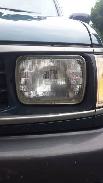

    These are the headlights that I have. Not sure what they are exactly or what bulbs I have
    How hard would it be for someone with no mechanical experience? [​IMG]

    Save your money and do it right. Don't waste your money like I did my first two sets off eBay. Plus you'll potentially be blinding drivers if they aren't mounted and aimed correctly.
    Either stick with OEM 5x7 sealed beams or do a proper full retrofit. In my opinion.

    You can't do a retro with that fluted lens. Has to be clear. So yes u need new housings. They are cheap anyways. The shroud description will tell u what size halo is needed.

    You have to. Your original sealed beams are glass and permanently glued together. You have to get plastic housings that you can get apart and cut on.
