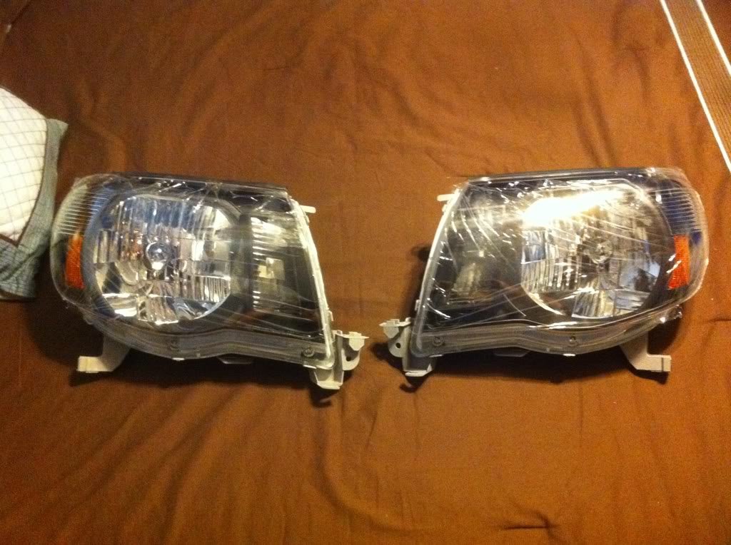

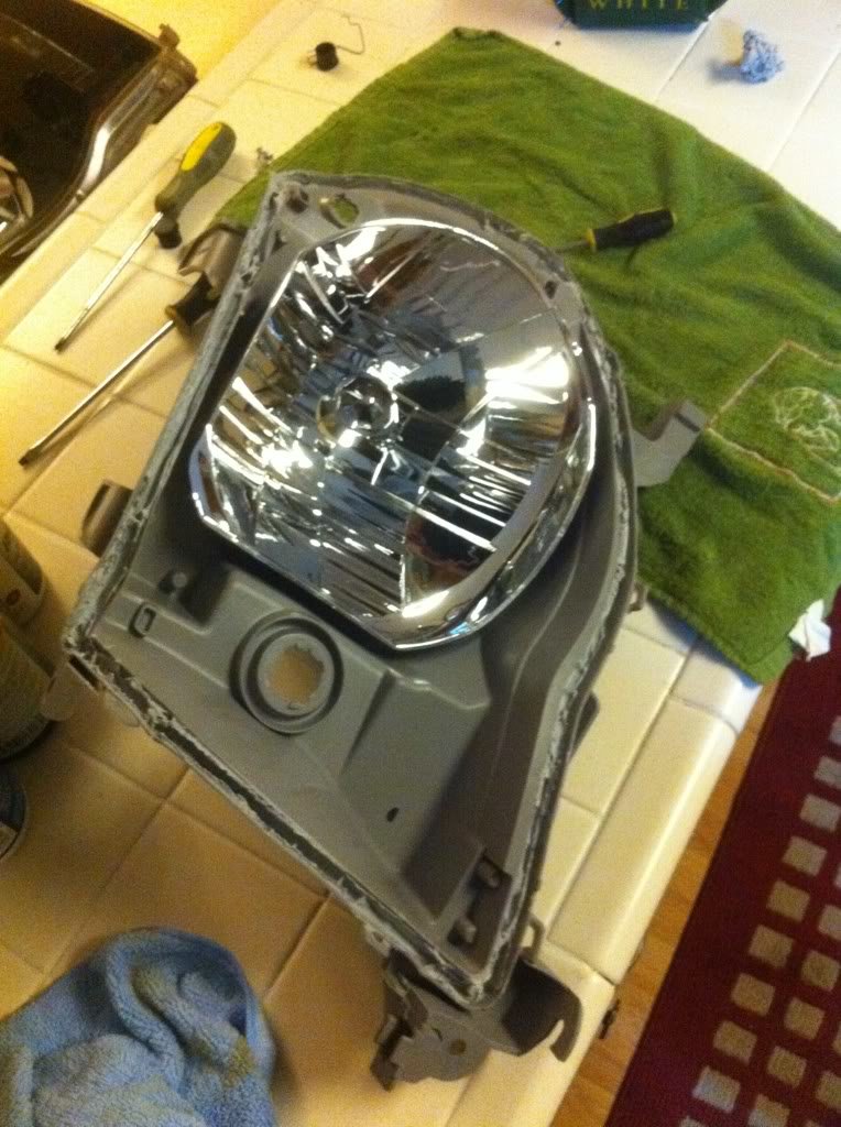

    RETRO!!!! just did mine today, literally lol
    new headlights
    open
    paint
    install
    glue and install
    adjust and be amazed! i did this in literally 6 hours. start to finish, i started right wehn UPS dropped of my new housings lol
    in a nutshell thats it man

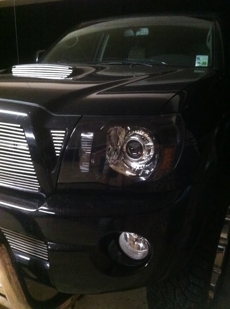

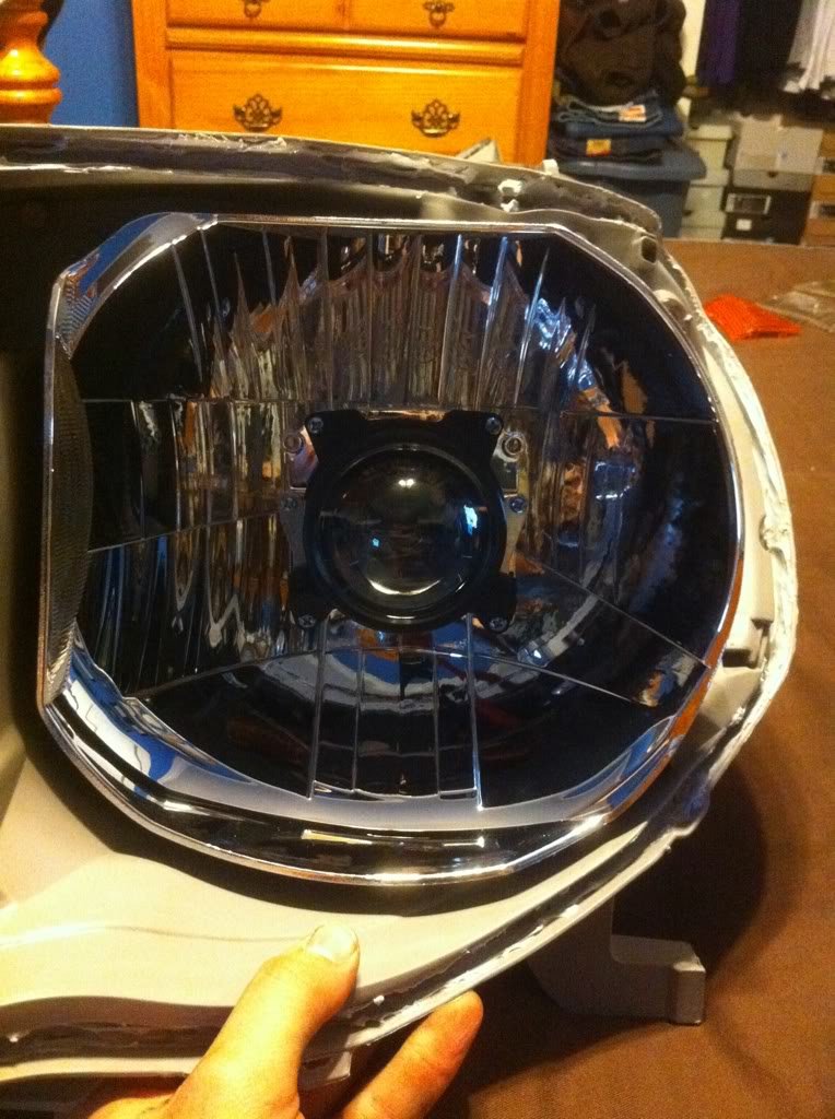

    morimoto mini DS2s with apollo shroud, five 5 ballasts 50 Watt 6K bulbs. not trimming at all, if i want to go back, litterally reverse everything

    morimoto mini H1 will be a superior projector in every single way compared to the projector you linked. not trying to bash the guy on here who is selling them but, they fail hard when compared to a real projector. this is not my opinion it is a fact.
    i will give you some links :) look these over and tell me if the mini H1 does not blow the G1 G2 and G3 what ever projectors out of the water imo you would have to be blind not to see the difference.
    http://jvxdriver.com/Mini H1 vs. Oem TL with Clear Lens.htm
    the link i just posted here demonstrates the mini H1 compared to the TL projector one of the best bi xenons money can buy and it hold it's own plus i know a guy that can color mod and tweak them to be even sharper and more colorful they can be made to be extremely nice!
    they are the best bang for the buck period.

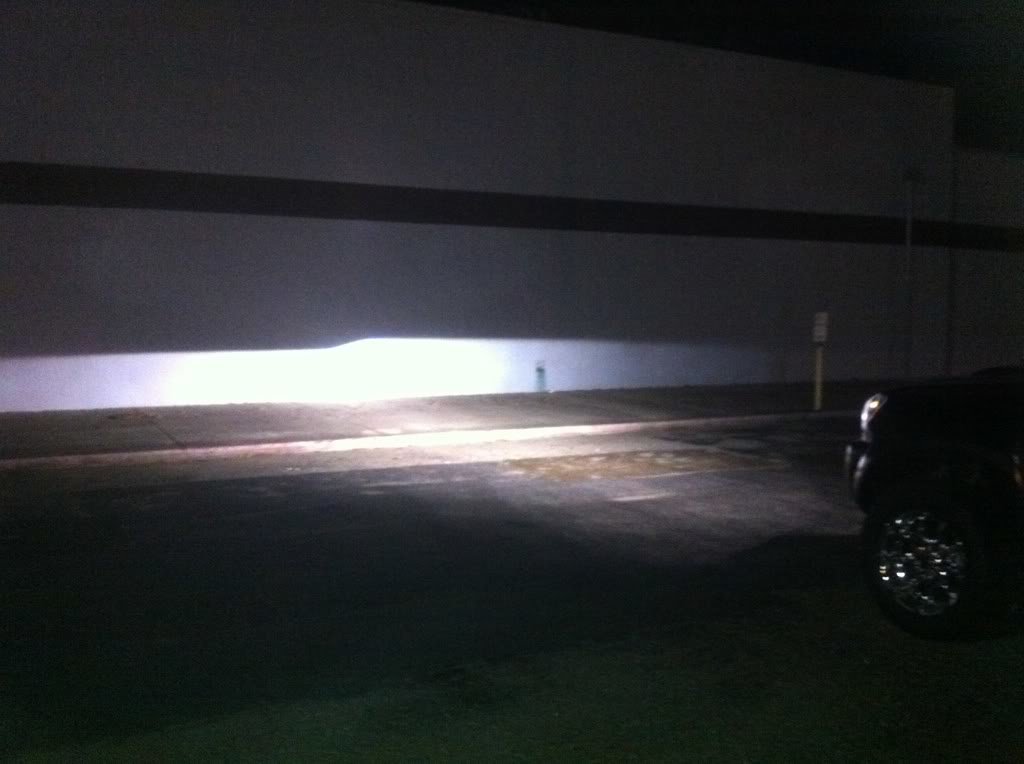

    looks good in the housing but, your alignment seems to be off a good bit unless the photo isn't showing the cutoff properly.
    imagine a set of eyeballs crossed in on each other thats what it appears you have going on just fyi. like i said though they look great and it may just be the photo either way grats the fx-r is bad ass man.

    I thought at around 25 foot you want the "step" to be straight on each other? I know if I got closer or further they start separating. How am I supposed to set it?

    I know old thread I'm just researching retro stuff. Just wanted to answer 4x4Taco09's question since I had the same one before beginning to look around.
    The beams should be perfectly parallel. The cutoff slant things should never join or get further apart at any distance. That plus the lower cutoff part 2-3 inches down from headlights and there is your aiming!
