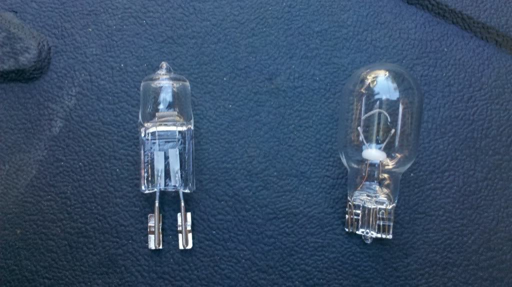

    I had my front windows tinted, and now have trouble seeing in side mirrors at night in reverse... i saw the reverse light mod that uses the sylvania 886 fog light bulbs. I wasnt quite sure how i was supposed to cut up that bulb to make it work. I looked for a while for a pic of the modified bulb. It was really easy to figure it out, but i thought it might help some of those who are unsure about doing this mod like i was. heres how the bulb gets cut, and it slips right in.
    (fog light bulb on left)

    I put the bulbs in from V-LEDS.com and besides the price they are great
