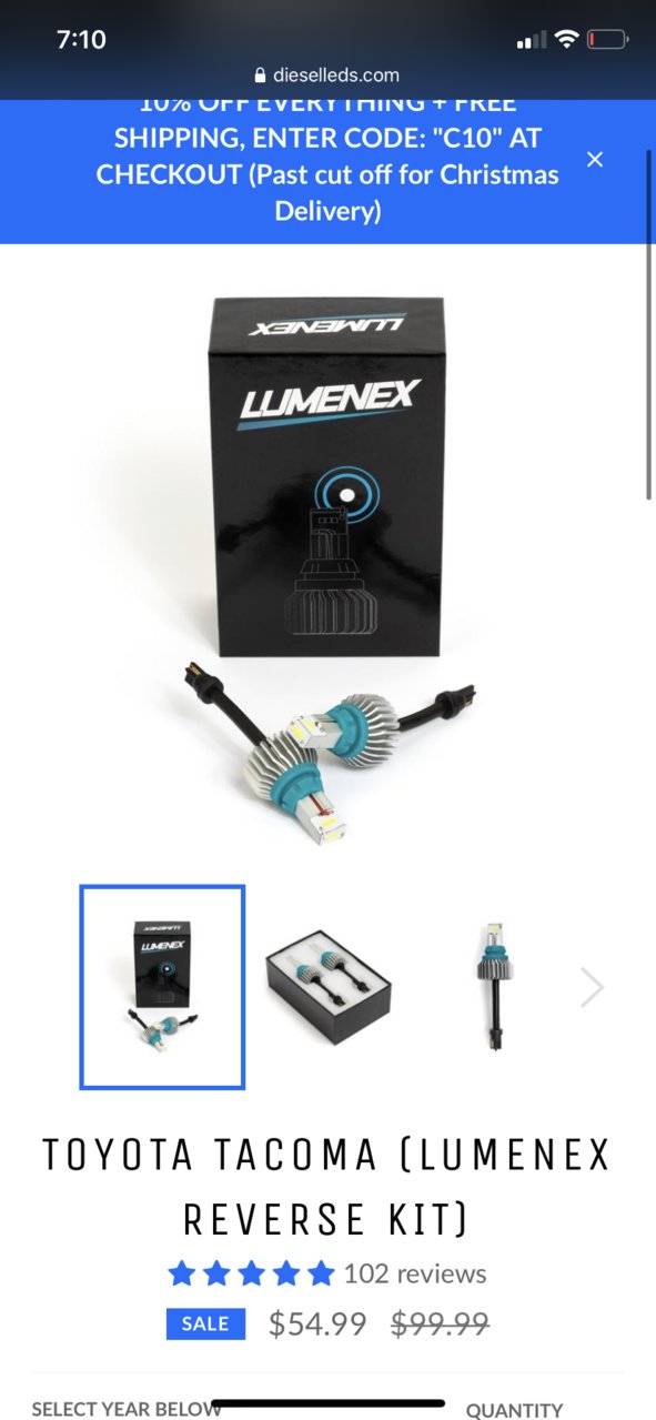

    I want to try these out. They work really well from what the pictures show but not sure if they last long.

    In addition to likely poor performance in the stock reflector bowl as @Tullie D posted, the Lumenex mounting scheme is very suspect. Instead of locking in place with four cam lugs like the stock bulb socket, it has a rubber grommet with some barbs. The electrical connector is left outside the lamp housing without any weather protection :facepalm:

    If anyone wants to give it a try, tape up the electrical connector really well, or the light may go wonky after the first run through a car wash. The back of the lamp housing is fully exposed to the ground underneath.

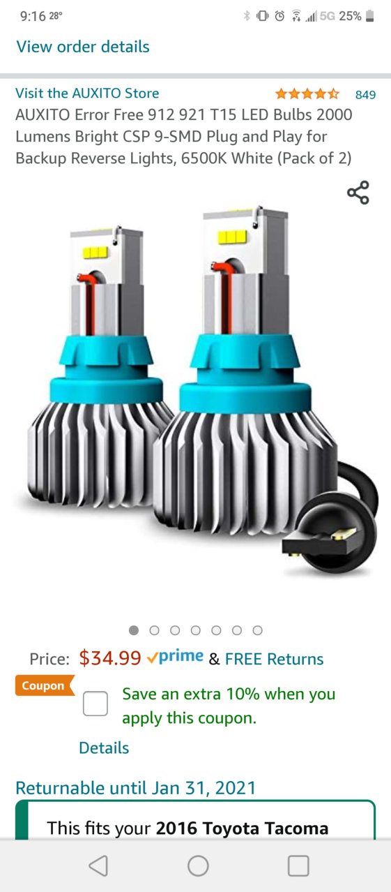

    I bought these last year. Very bright
