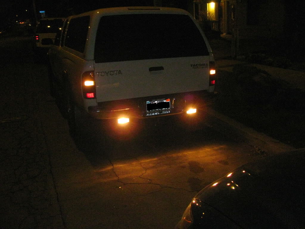

    well here was the end result of this one guys, :) :jerkoff::woot::bananadance::dancingbacon:

    Here's a street shot of my recent install of the "Navigator" kit:
    Definitely improved. . .

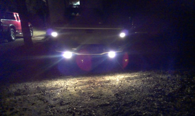

    Heres a pic of mine. At first I had them tied to the reverse lights but this past weekend I tied it to a switch so I can turn on whenever needed. I would like to have it tied to the reverse lights and the switch but with out using a on/off/on switch I am not sure how. Also I mounted them to the front of the towing receiver so I can just flip them up and they are completely out of the way when offroading, dont have to worry about dragging them off a ledge.

    Holy moley! Those are bright! :eek: Which lights are you using???

    They are some cheap 55w halogens from Walmart.

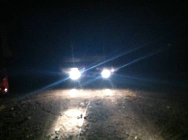

    These are the 55w Pilots from my writeup in the second post:
