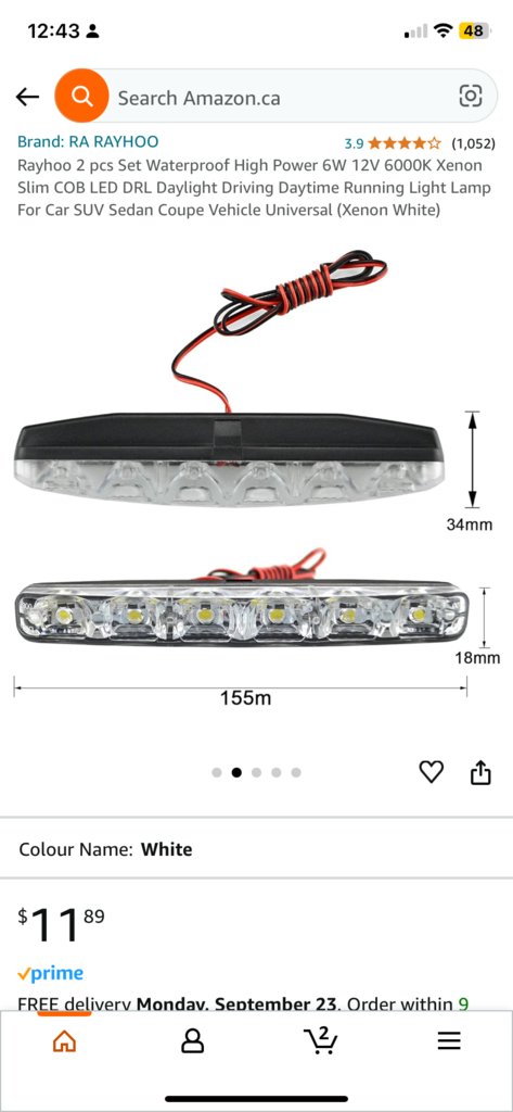

    2 options for something that won’t hang under.
    First, like the ugly 3rd brake light led strip between the tailgate and bumper, put a white one instead.

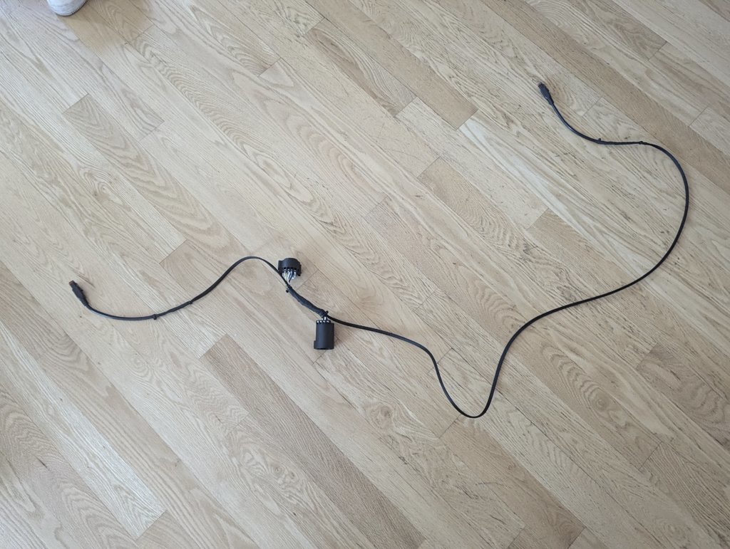

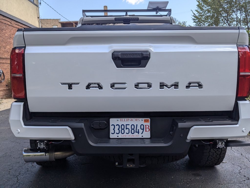

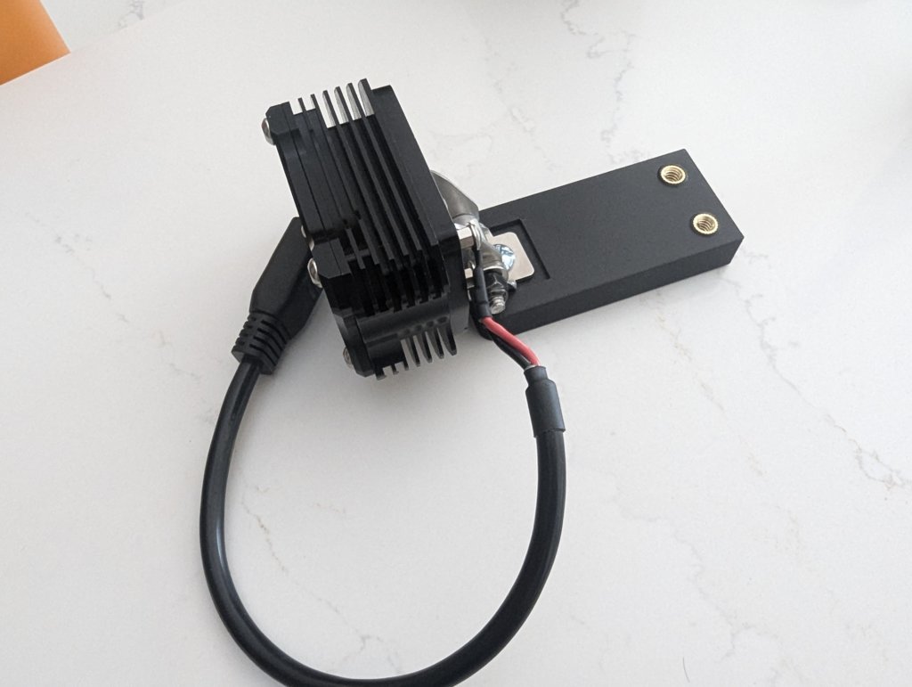

    I did the Heretic pods. Designed my own mounting brackets and made a custom harness using an 18" 7-pin extension.

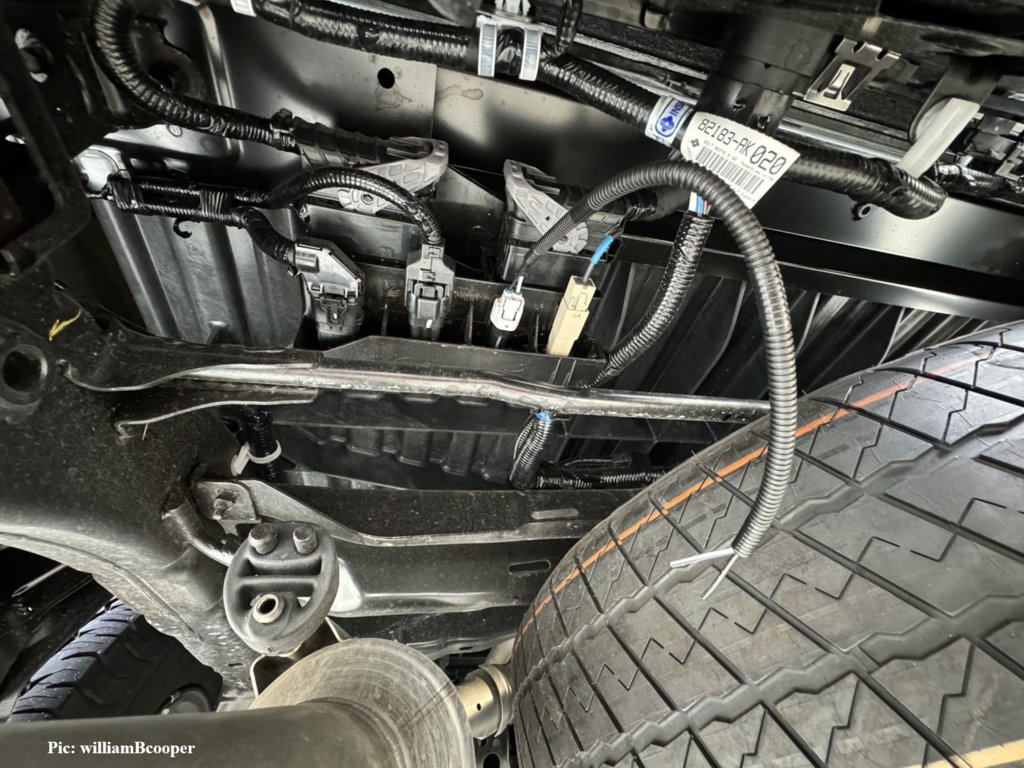

    @Gurvy522, did your Taco not come with the Aux switches on cab dash?
    Because the OEM pigtails provide for reverse lamps fused connection at rear bumper:

    Not so easy but versatile solution here:
    Modified OEM pigtail to Added Reverse Lamps

    Yeah, it's not an option for us, unfortunately. Just the OR Premium, TRD Pro, and TH get them.
    Interesting solution. Honestly the harness took me all but 30 mins to make and maybe less than 5 minutes to hook up. My trailer doesn't have reverse lights and the heretics pull about 1.5a so I felt like the 7-pin was the most straightforward approach. Here's a pic of the harness being made. I use non-insulated crimp connectors and just heat shrink over them. Then harness wrap and some zip-ties.
