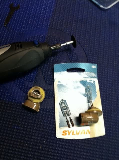

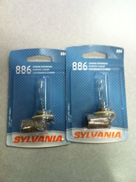

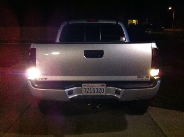

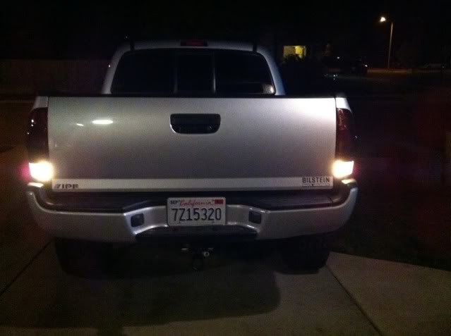

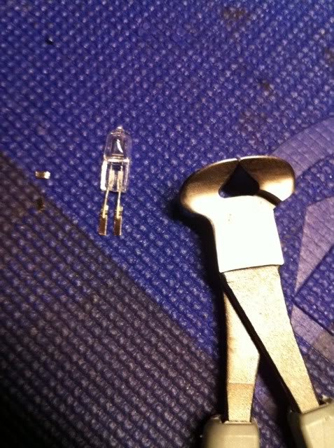

    Just installed the 886 bulbs tonight

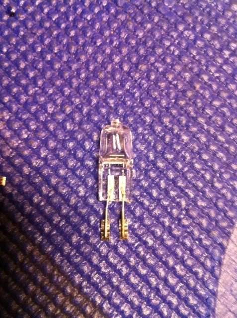

    Cut the bulbs from the plastic base with the Dremel

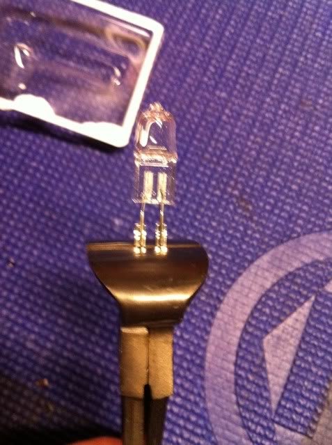

    I then shortened the exposed connections with End Cutting Pliers

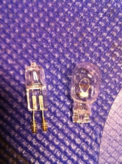

    vs. the stock bulb

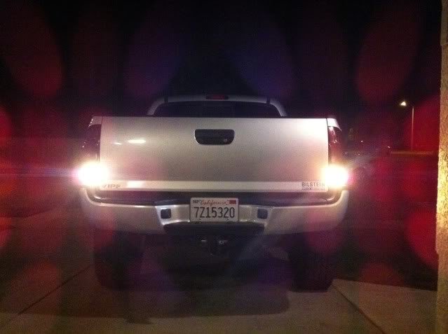

    Before:
    Comparing (Left = 886 <-------> Right = Stock)
    Done:
  20. Apr 4, 2011 at 11:13 PM
    #20
    sachou
    sachou Well-Known Member
    Sep 30, 2009
    #23554
    697
    Sam
    Richland, Washington
    2006 TRD Sport Acc Cab 4x4 V6 6spd
    Nice! looks pretty easy. Any heat issues?
