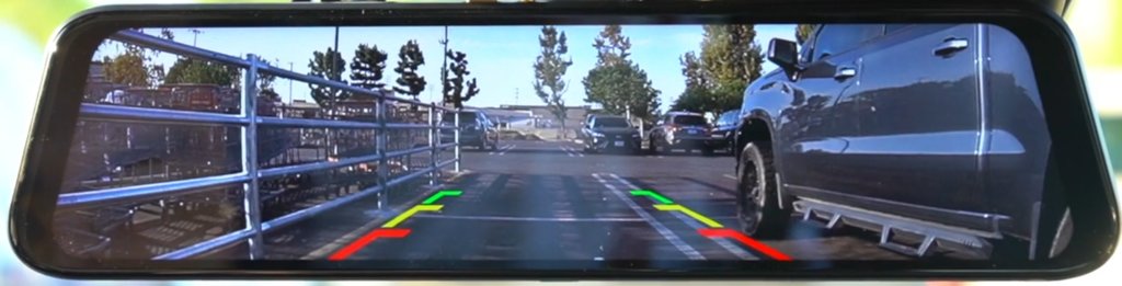

    Yes, when it's mounted high enough to be a suitable rearview mirror camera, the reverse grids don't do much good. When it's mounted low enough to be a suitable reverse camera with grid lines, it does not do much good as a rear view mirror.
    My wolfbox camera is mounted at the top of the window on my camper shell above my tailgate.

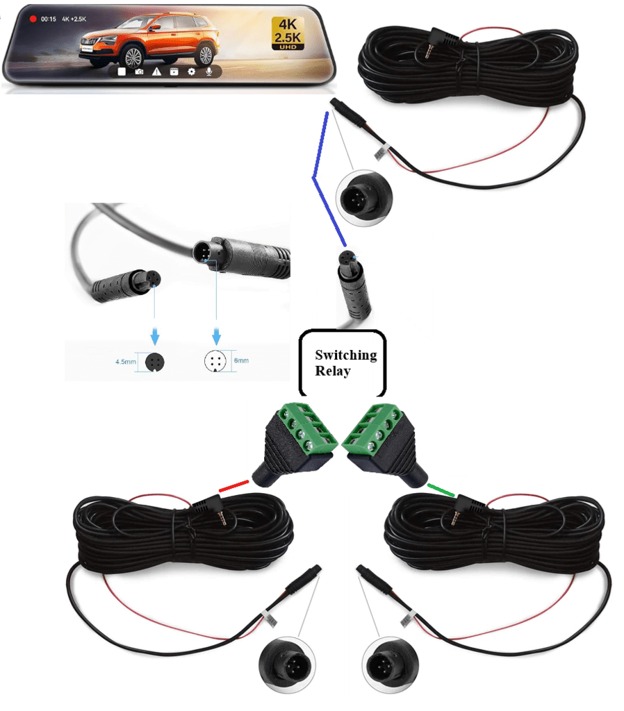

    Maybe two cameras, with selection switch would be a choice...$$$
    One with reverse trigger, the other not.

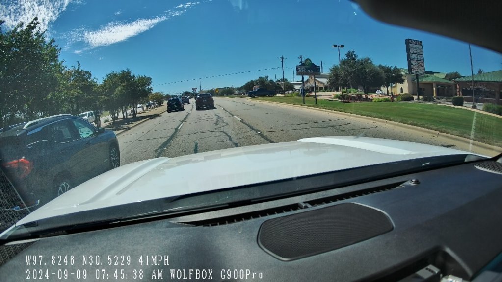

    I think adding an extra channel for a front camera would be better. They have a forward facing dash cam but it’s useless except for dash cam things. A true forward facing camera where you can mount where you want would be great. I’m sure it’s coming eventually.

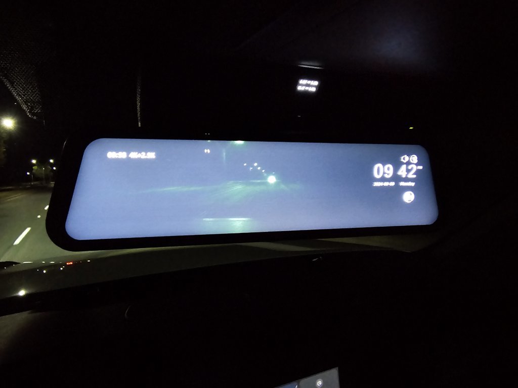

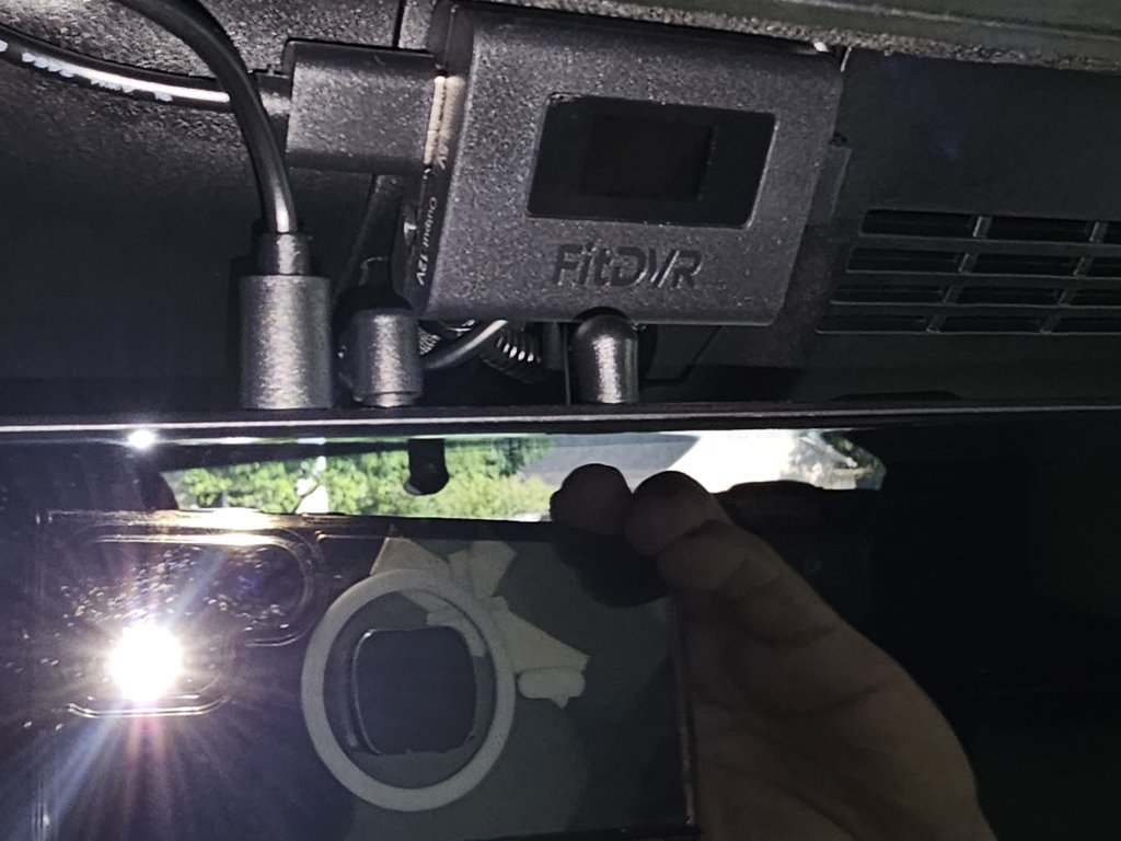

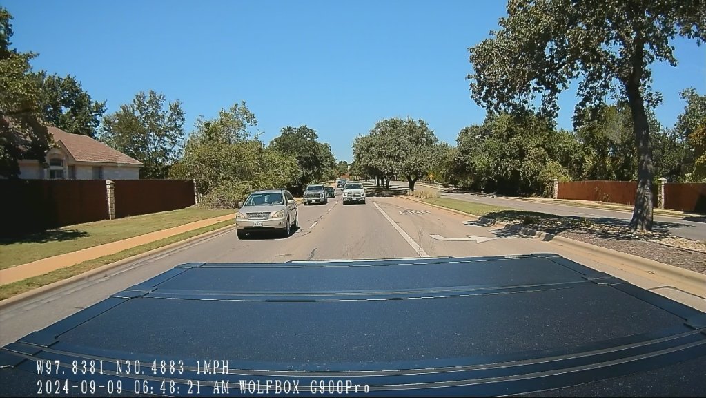

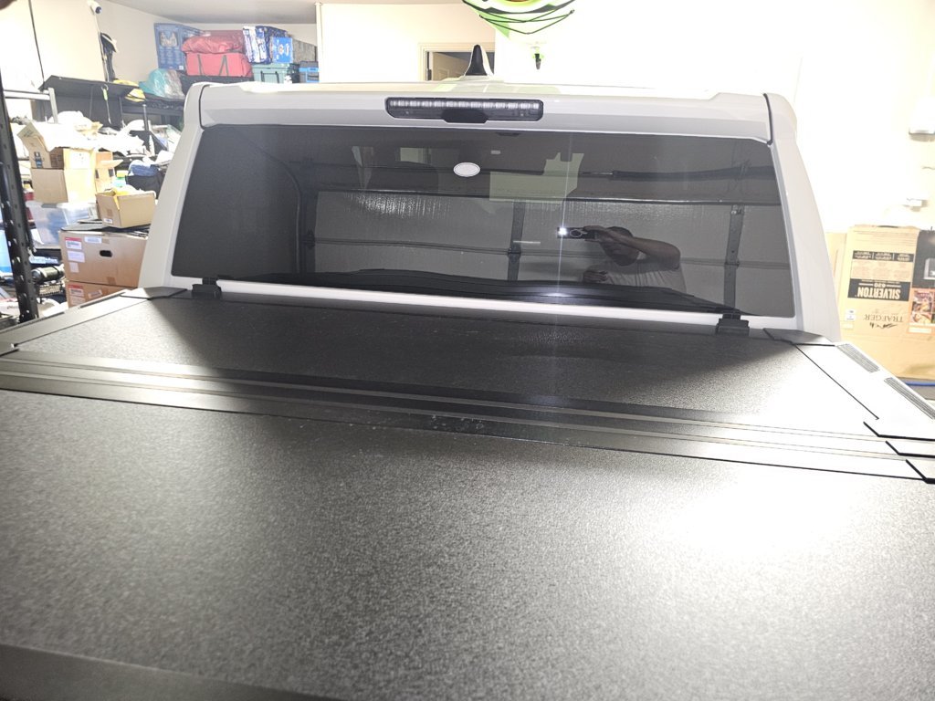

    The dashcam rearview mirror camera arrived and I installed the rear camera on the back window. The window has a 15% tint. The day time driving photo quality us very good for the rear and the front but I really care about the rear so I can see because I have a child carseat back there. When testing the night vision, I wasn't impressed with the rear and I am not sure who much the rear tint is effecting that. I am going to ask the tint guy to cut out a small peep hole for the camera to improve that. Alternatively the camera could be mounted outside, but I didn't even consider that as the complexity factor of routing outside the cabin becomes much harder. Hopefully I will not wind out with a botched up rear window tint and that works. I put a sticker where I am contemplating the peep whole. I also ppwered the camera using a fitdvr because i will also use it to ppwer the uniden r8 radar detector. I think it will make for a clean installation but i may not have parking g sensors powered on unless i hardwire it. Let me know your thoughts 20240909_214240.jpg

    I didn't do it because I don't need the 2 lines and it is permanently working as a rearview mirror and I can swipe to front camera or both if I want. So there is no rear need after all.
