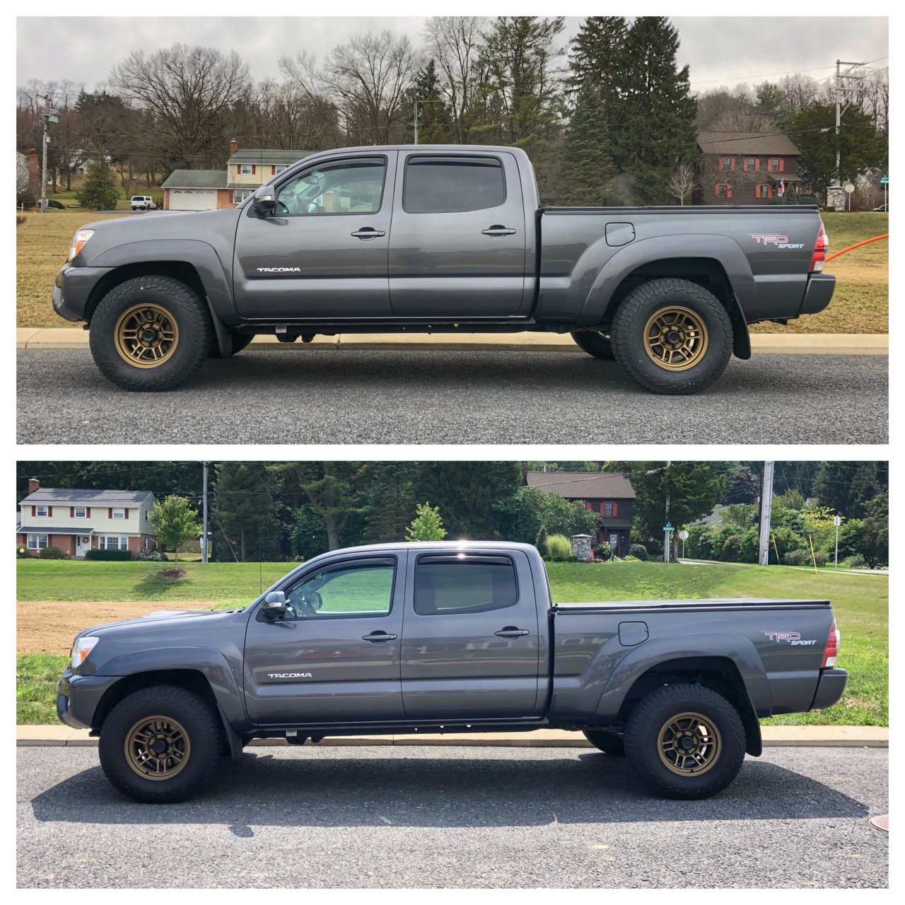

    So the 3rd gen suspension levels out a 2nd gen without a 1/4” spacer on the drivers side? I was planning on installing my 3rd gen stuff tomorrow but now I’m worried as I bought a 1/4” and 1/2” spacers. I assumed the 2nd gen is side specific too therefore still needing a spacer to fix the lean.
    *EDIT: Well I got the fronts on today and will do the rear with the AAL tomorrow. I ended up using just the 1/4" spacer on the drivers side. So far I've noticed the ride is a lot smoother. The truck now looks "level" or close to it, so I'm hoping the AAL will give me the slight rake I was after.

  2. Aug 20, 2019 at 8:41 AM
    #182
    thelate1
    thelate1 Well-Known Member
    Oct 8, 2018
    #268740
    195
    PA
    2013 DCLB Sport 4x4
    All finished. I hope the rear settles some, as the AAL raised it more than I expected it to. I went with the 1/4” spacer on the drivers side. The front is now even and exactly 1” higher. The rear is almost a full 1.75” higher even though it was only supposed to be 1.25”.

    Looks good but you may want to go to a 1/2 or 3/4 spacer in the front to match the rear. I have 1/2 on both side but would like to go to a 3/4.

    When you flip them, the notch/step in the seat should face rear of truck once installed. Most guys don’t worry about spring orientation, (myself included) but Toyota claims that is the proper orientation

    thelate1
    Oct 8, 2018
    #268740
    195
    PA
    2013 DCLB Sport 4x4
    Yeah, I wussed out on doing my original plan of 1/2" on driver and 1/4" on passenger. I already decided the rear AAL is coming off as it gave me way more than I wanted. I'm just going to do a 1/2" spacer in the rear, which should give me about 1" difference from front to back.

  11. Aug 24, 2019 at 10:22 AM
    #191
    thelate1
    Oct 8, 2018
    #268740
    195
    PA
    2013 DCLB Sport 4x4
    So I took the AAL back out and installed 1/2” blocks in the rear. I now have right around 1” of rake which is what I wanted.

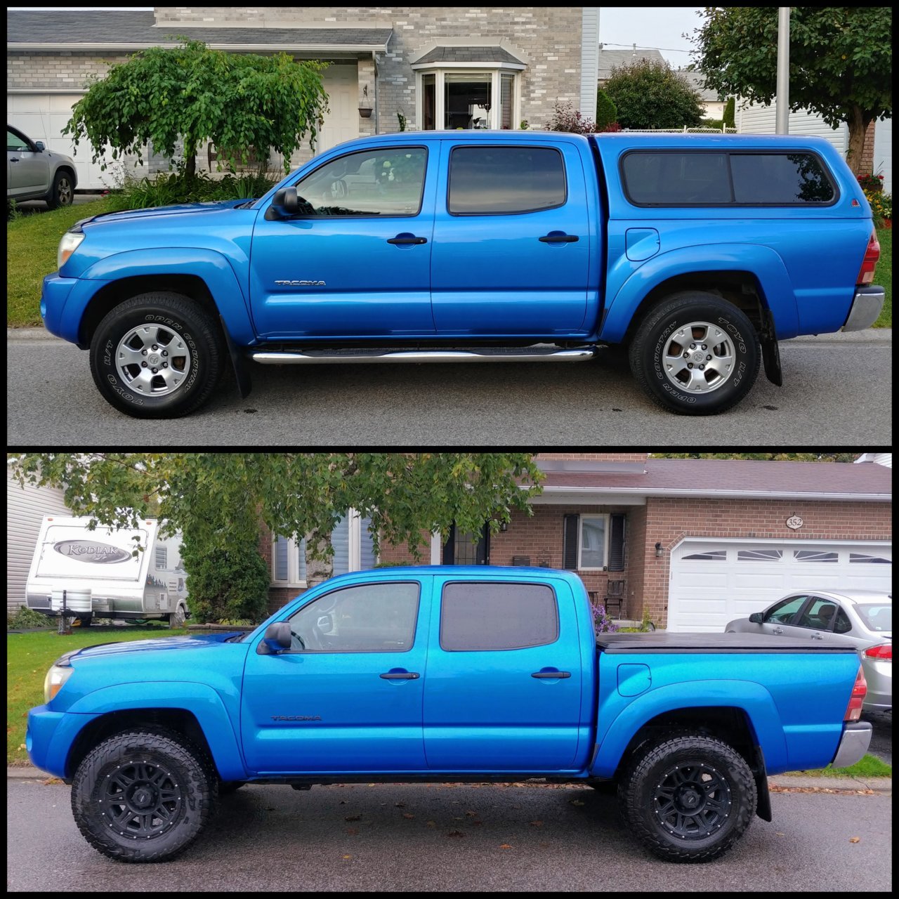

    DLillest
    DLillest Well-Known Member
    Jul 3, 2018
    #258200
    756
    Quebec, Canada
    2007 SBM DCSB 6MT 4x4
    2007 V6 4x4
    Overall about 1"-1.25" lift depending on how the truck sits.
    Front: Installed 2018 TRD Sport coil assemblies w/ drivers side 1/4" lean spacer
    Rear: Installed 2019 TRD Offroad shocks
    The truck now rides really smooth, tighter up front with the sport shocks, making cornering more fun but softer in the rear with offroad shocks making it less bouncy.
    Last summer vs now with the new shocks
