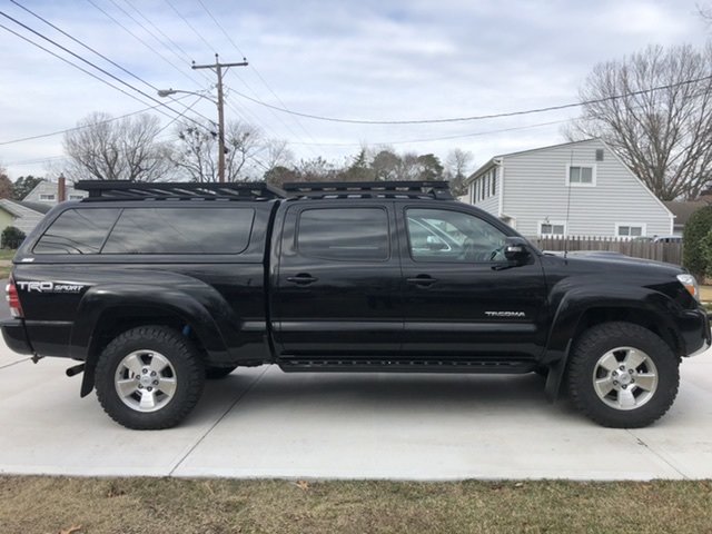

    Just installed 3rd gen Bilsteins on my 15 DCLB thanks to this thread and @jtaco11 for the take offs
    installed 1/4” spacers from wheelers and netted 1 1/2” up front based on existing conditions of 100k suspension
    21” front
    22 1/2” rear (firestone air bags)
    Rides like a new truck and the added 1 1/2” up front looks much better. Couldn’t be more pleased. Great deal. Great upgrade. Thanks
