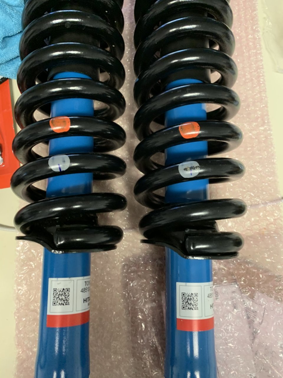

    Was 1/4 driver side spacer needed? Is it cuz 2nd thing? The 3rd gen OR front shocks (green dot) are side specific which compensates for the lean but Hitachi fronts both same color dot unless you marked which side it came off from.

    Yes the 1/4’ spacer is needed on the driver side. Hitachis are not side specific. They come with green and blue dots or blue and orange-ish dots. I’ve seen individuals with both colors, two blue and green, or two blue and orange (I have two blue and orange).
    and some who have one of each, like this guy.
    It doesn’t matter if you receive them marked of not, the driver-side will lean without a 1/4’ spacer. They were not designed to compensate for taco-lean.
    Cheers!

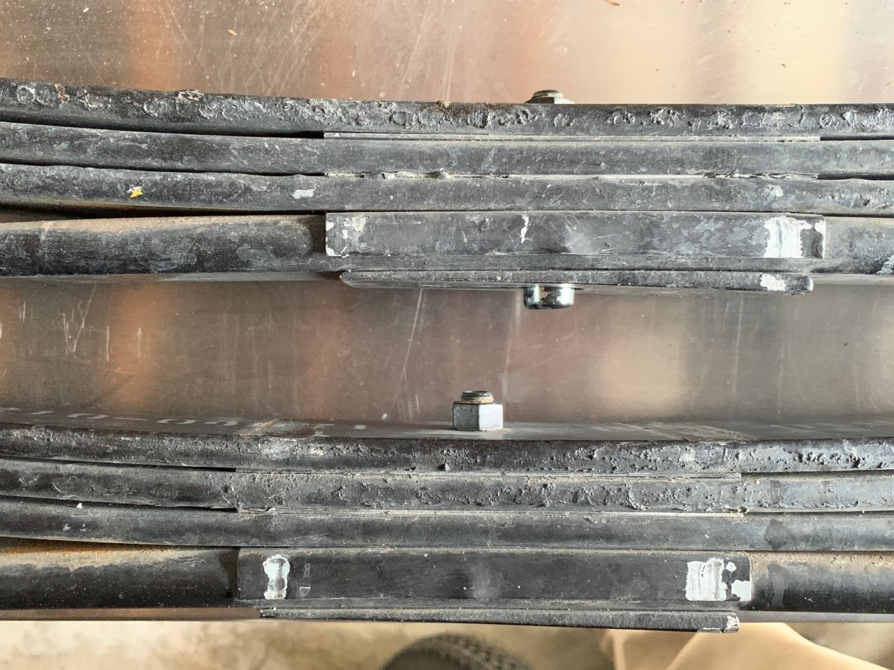

    Can we talk about 3rd gen leaf springs for a sec?
    I've read that the 3rd gen leafs are "identical" to the 2nd gen (TSB) leafs. I knew this wasn't technically true because they are a different part number. But, figured they may be functionally identical or maybe just "identical" in the amount of lift they provide. If anyone has any better info about this I'd love to hear it.
    I received the leafs along with my 3rd gen shocks but didn't bother installing because my TSB leafs are only months old and figured it wasn't worth my time to do the install. Just recently I noticed that the stock 3rd gen leafs have tapered shims in them:
    I know that tapered shims are often used when lifting so I thought it was very interesting that Toyota decided to use them on a stock TRD OR. Coming from sports cars I'm still very new to trucks and wanted to see what y'all thought. Would it be worth the time swapping these into my truck? Is there a worthwhile benefit to having this shim? My truck currently has a 1" steel block in the rear so I'd need to confirm that I could even run both but wanted to get this info out there as I hadn't seen anyone post about this shim on the 3rd gen leafs.

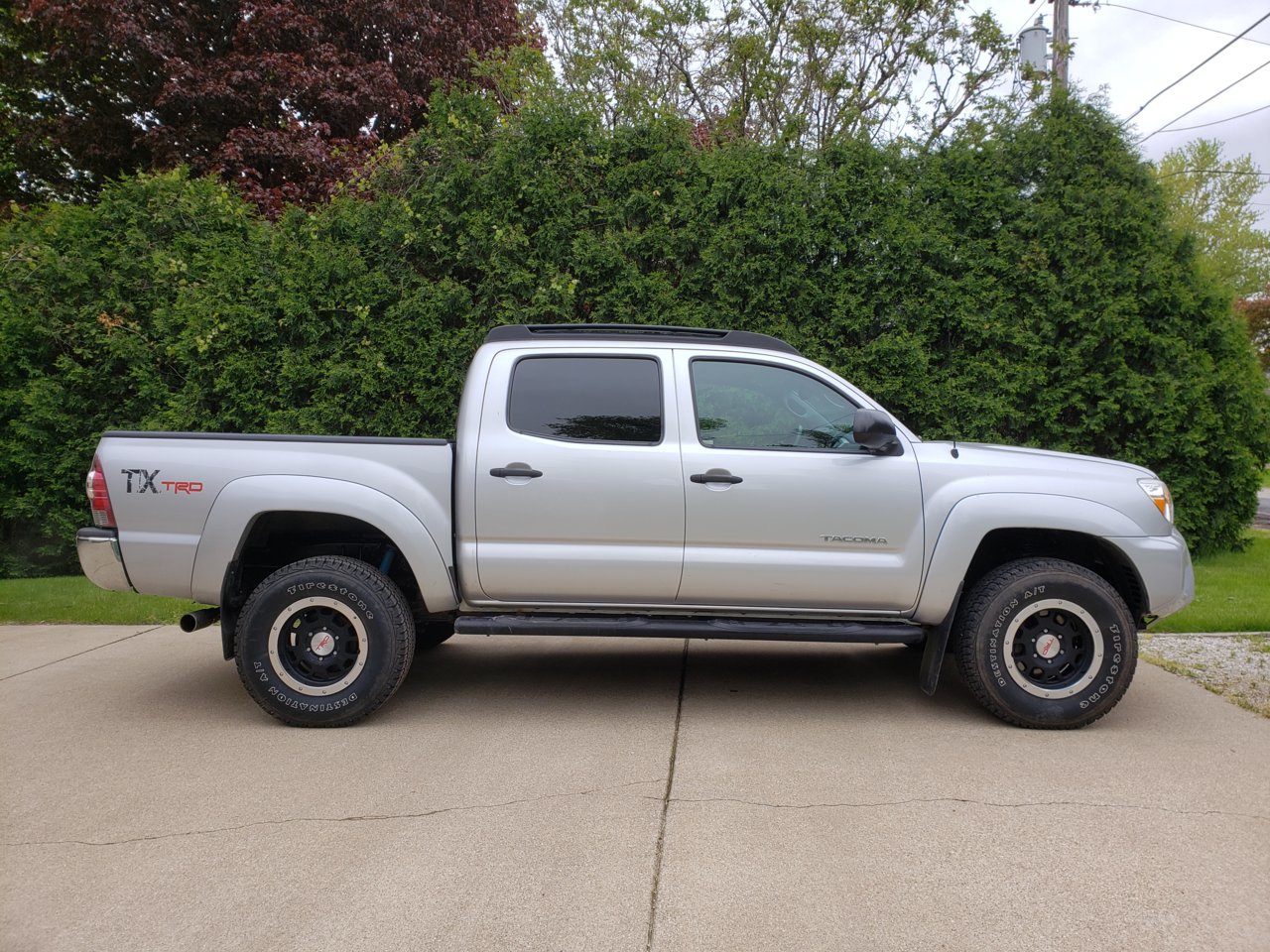

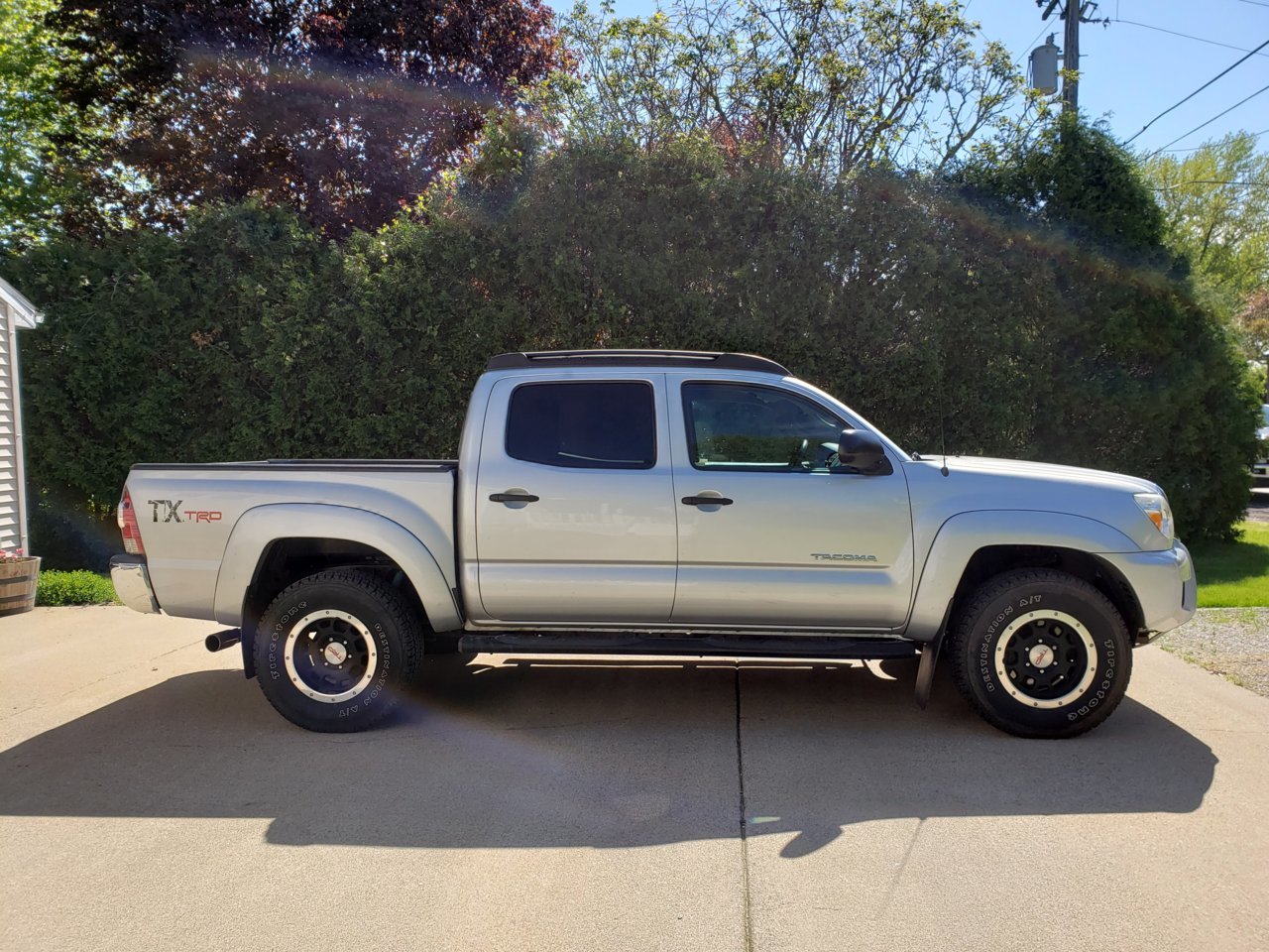

    Got a set of 2020 TRDOR shocks/coils with less than 100mi on em. Installed with 1/4in toytec spacer on driver side and deaver add-a-leaf in the rear. Top pic is before, bottom after. Net lift was 1.25'' in the front and 1.875'' in the rear with the truck now sitting perfectly level side to side (no more taco lean). Might be a little too much rake for some but I'm very happy with how it turned out. Ride is much, much better and it wont be riding the bump stops hauling a 40lb bag of mulch.
    Before:
    Driver front - 33.75''
    Pass front - 34.25
    Driver rear - 35.5''
    Pass rear - 36.0''
    After:
    Driver front - 35.5
    Pass front - 35.5
    Driver rear - 37.875
    Pass rear - 37.875
