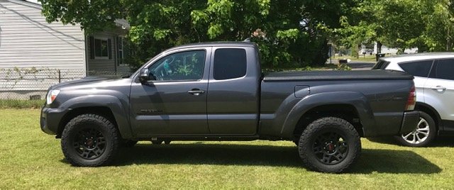

    I got a set of 2016 OR Front coils and shock assemblies that I haven’t had the chance to install yet. Down the road I intend to swap out the stock 2016 Bilsteins for 5100s. since I have 2016 coils do I need to get 5100s for the 3rd gen Tacoma’s or just stick with the 5100s for the 2nd gens?

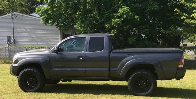

    Installed 2016 Front TRD OR coil assemblies on my 2015 TRD Sport. Slight lift, between .50”x.75”. I like the ride, especially less body roll in curves. Very easy job, my advice is hit all bolts involved with PB Blast several days before. I was lucky, the previous owner must off regularly hosed off the undercarriage regularly because there’s very little corrosion for a mid Atlantic state that salts their roads like a pretzel in the winters.
    Before:
    After:
    Joker8824, Ryan2103a and tinker_troy like this.

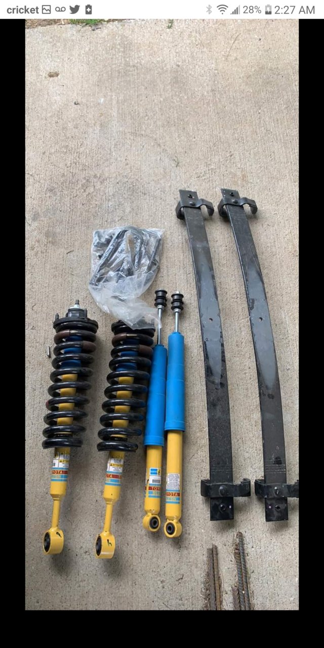

    Have a 2015 Tacoma xspx got it with 60k think it still may havr original suspension. Found a 2020 tacoma off road suspension for sale. Do i need just the front and back bilsteins in the photo or do i need the bottom leaf springs and stuff too. Thanks in advance

    You don’t need the leafs. The front coil assemblies give you the lift, so if you grab the coil assemblies and the rear Bilsteins and your good.

    Thanks Micbt25. Can i add those leafs to mine still for a little extra height from everything I've been able to find these should fit and add an 1in about of front lift

    I’ve seen that too, most people like the swap while a handful of folks don’t. I actually like the ride better, although stiffer, it’s much better cornering. When I went into curves with my 2nd gen suspension the body roll was annoying. To me it seems a little more sure footed and solid, which I prefer.

    Yeah add the leafs. I did happy with it not sure if I like the struts yet

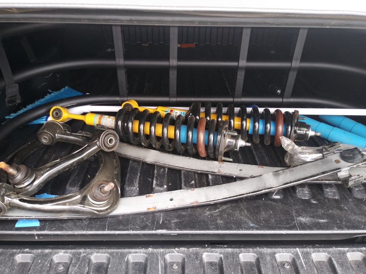

    Thanks micbt25 and maxwell1234 and Joker8824 . hope i can pull this off. I just drove almost 2 hours and picked all of it up for 175 has 500 miles on 2020 trd offroad. He did mention he had all hardware ecxept one bolt they used to put his new set on said mine would fit. Not positive what he was talking about tho
