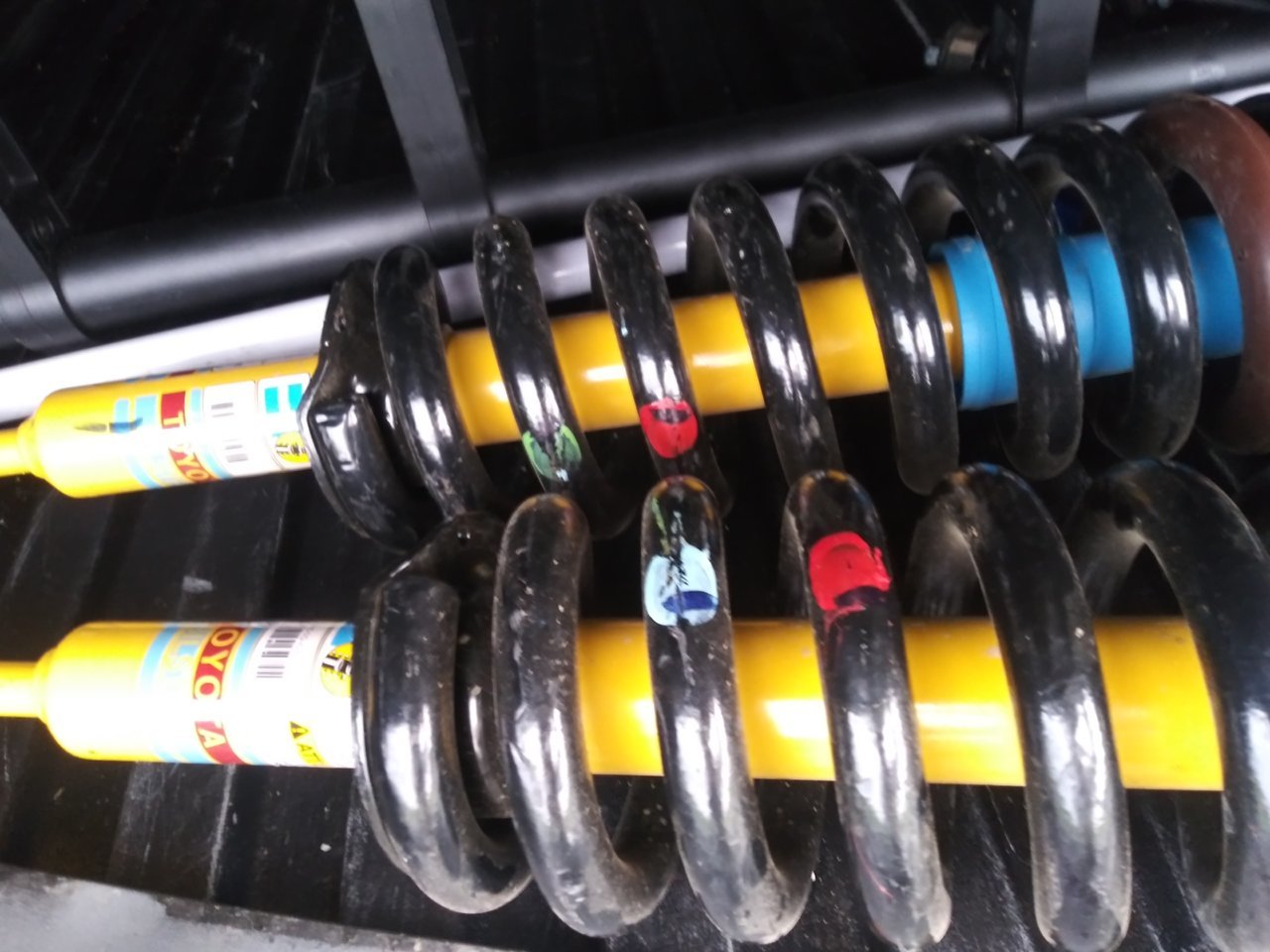

    Can i use the hardware he gave me and my hardware to get it all on. He mention when he took off and put his icons on they used some bolt out of his he said i could just use mine for the ones he sold me.?

    Which is driver and passenger they both have red dot one green one blue

    As far as I know, red/green = drivers.

    Doesn’t matter your hardware will fit. It’s a direct replacement minus the lift

    I never really found an answer on the dots and their meanings. I wonder if it's something similar to how OME Dakars have a +, 0 or - that indicates whether it is above spec, at spec or below spec for tension. If I remember correctly I had the red/green on the drivers side. I do have a little lean, but I wonder if it has to do with worn leaf springs and the AGM battery I have.

    I searched hi and lo for a definitive answer to the meaning of dots to no avail. What I did was to orient the coilover (predicated on the coilovers being "intact" and never have been disassembled) with the end of the lower end of the coil towards the rear of the truck as per the manual. I did this and don't have any issues....

    Yea got lucky researching and found a thread where a bunch of 3rd gen guys checked there's to see. Green red Driver
    Blue red passenger

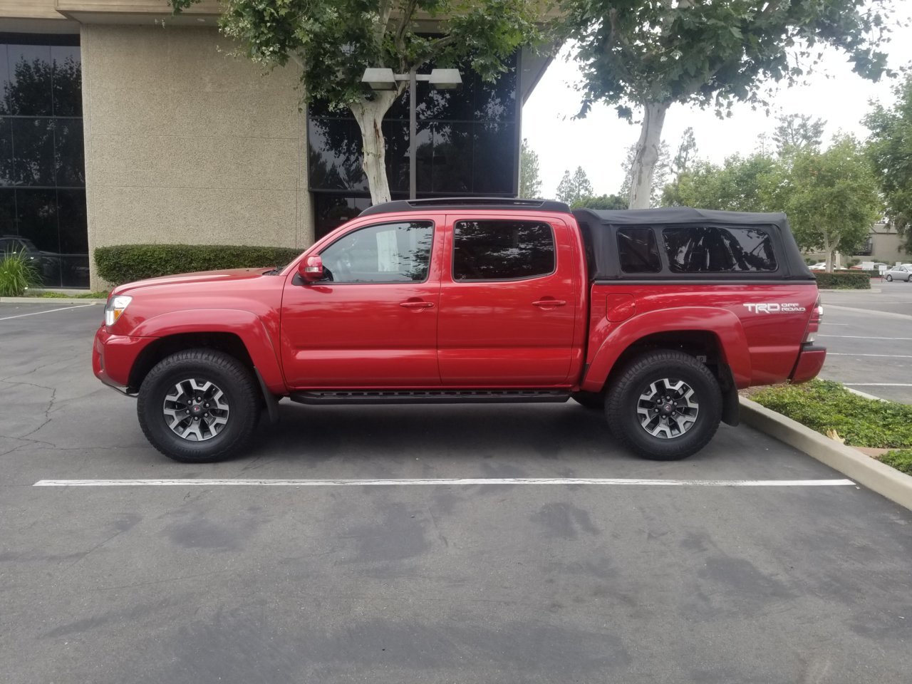

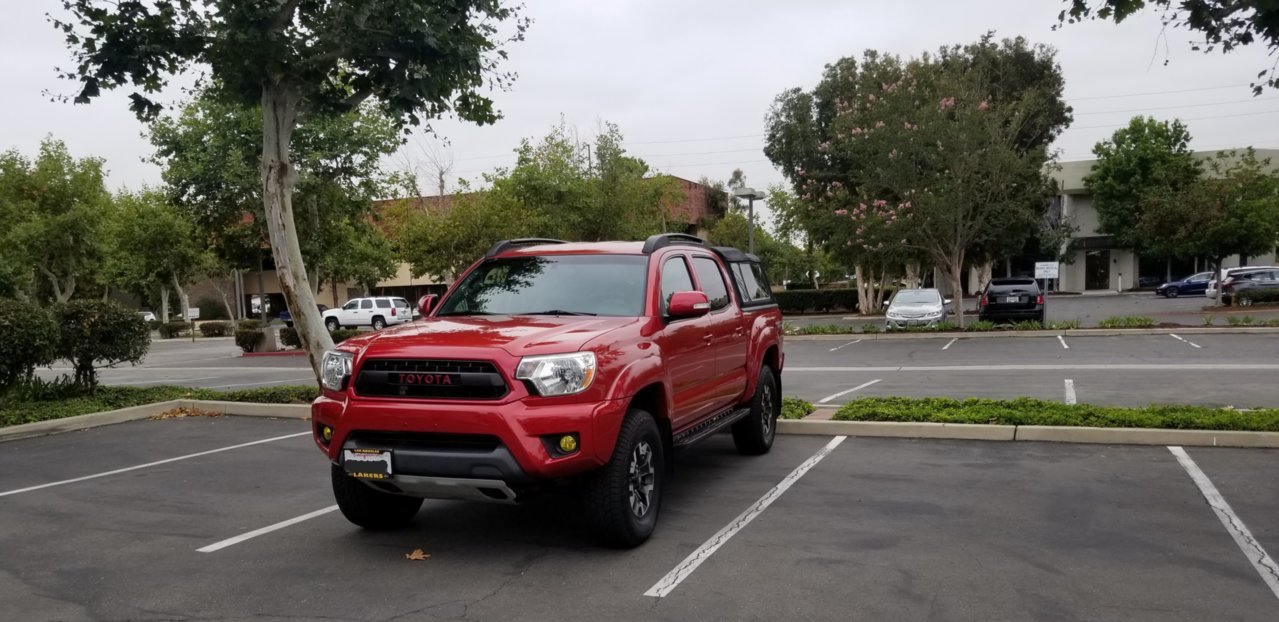

    I added 3rd gen suspension as well. Front gave me 1in lift and rear I also swapped out my 2+1 leaf and the 3rd gen leaf was a direct bolt on giving me a 0.5in lift. I added a headstrong 1/4 spacer lift to the front and a 1/2 toytec flat shim to the rear. Overall 1.5in lift in the front and 1in to the rear. Rides really smooth. I'm also running 265/75/16.
