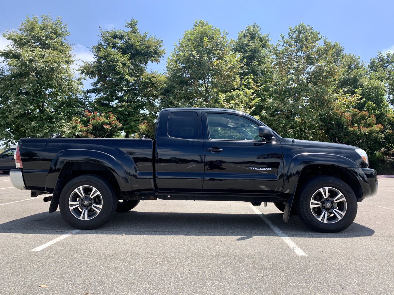

  13. Jul 21, 2020 at 12:57 PM
    #293
    Mercedesfan
    Mercedesfan Member
    Jul 21, 2020
    #335187
    7
    2011 Toyota Tacoma 4x4 5 speed
    Trd suspension from 2019
    I just swapped my 2011 suspension with the 2019 trd off road set. Drives better. Raised around 1”.
  14. Jul 21, 2020 at 12:59 PM
    #294
    socal73
    socal73 Well-Known Member
    May 23, 2020
    #329081
    108
    Westminster CA
    2009 DCSB Sport
    Looks good! How does the ride quality compare to the old suspension?
  15. Jul 21, 2020 at 1:55 PM
    #295
    Mercedesfan
    Mercedesfan Member
    Jul 21, 2020
    #335187
    7
    I didn’t try freeway yet. But on the streets feels good. Cornering better. Not too stiff. I like it. And looks better too. ( before picture attached)
