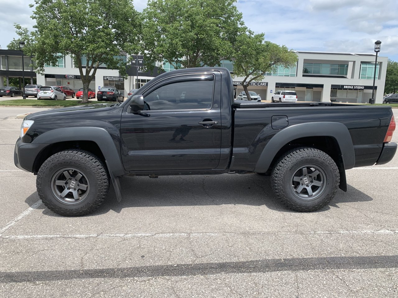

    I have a set of 2020 trd off roads Front strut/shocks and rear shocks with like 50 miles on them. Have a 1.5 inch add a leaf coming in also. Super excited to see how it looks on my 2012 regular cab 4x4. Just got new wheels and tires, a 1-2 inch lift from these 3rd gens suspension from my current factory High mileage base suspension should be an awesome improvement all around.
    hell even if no lift I’m due for a change of suspension.

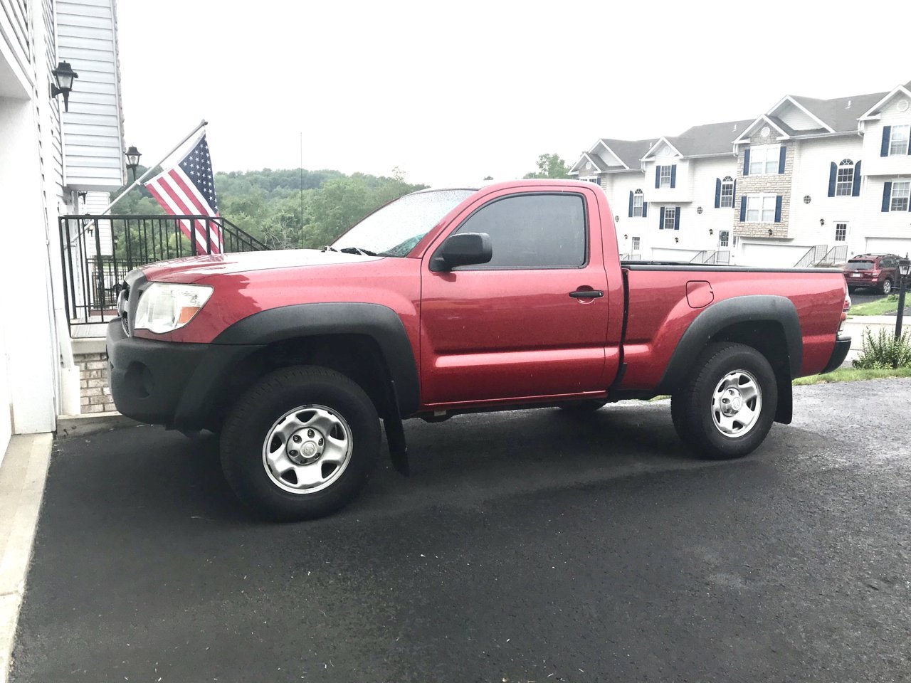

    Just added 3rd gen off road bilstiens front and rear on a 4cylinder regular cab 4x4 with 192k miles. The ride and handling is so much better after a very quick drive with the same route as a drive prior to the change. With factory size tires, it sits 35.5” ground to fender in front and 36.5” in back with the 3+1 style factory leafs changed in the rear due to the spring recall. 4200CD22-302C-4176-9CF9-C2A6BBA70C67.jpg

    Nice looks great! I’m pretty excited to do this myself on mine. Great looking truck especially with those miles, I love the red with black fenders on the 4x4s. Just put some 265s on my single cab. No rubbing unless I back up and turn fully and the rubbing is on the little mud flap under the front bumper. Hoping to get about an inch or more otherwise I’ll just pop those front flaps off.

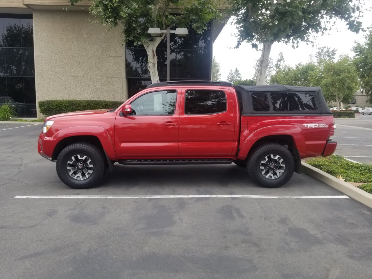

    3rd gen suspension along with 3rd gen leafs. Added a 1/4 headstrong front spacer and 1/2 toytec flat shim on the back. Total 1.5in front lift and 1in rear lift. Love how it looks and rides.

    Put mine on today from a 2020 with 25 miles on them.
    leveled it out, added about 1.75 in to the front and maybe .75in to the back
    Rides so much better than the factory ones that were on there
