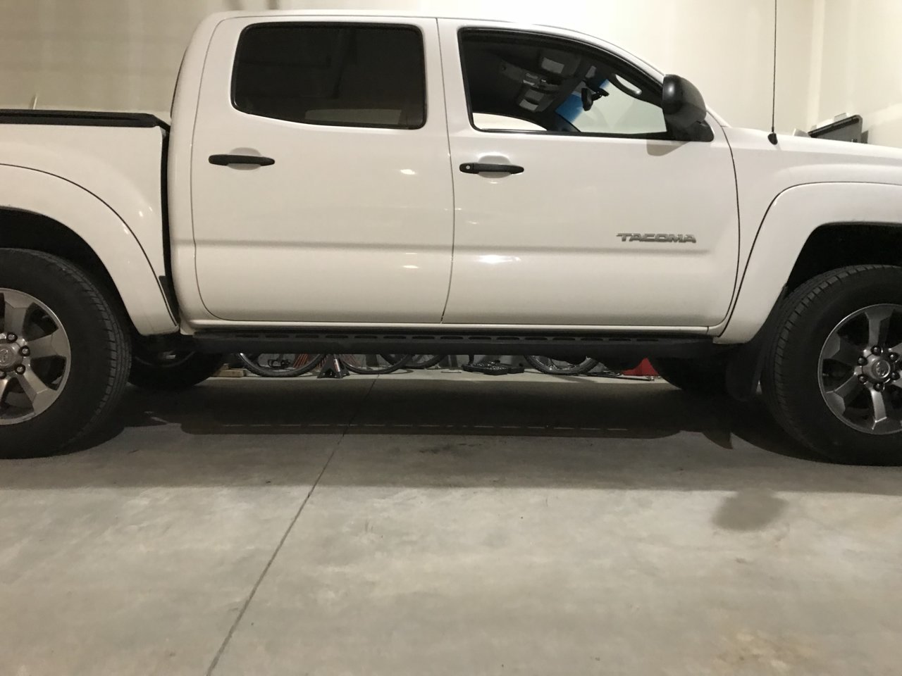

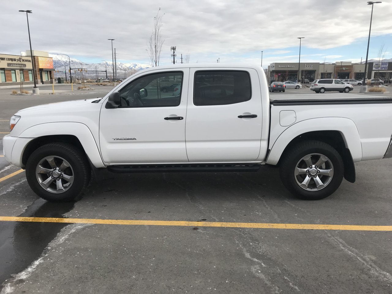

    Baseline data: 2009 Tacoma short box 4 door. Miles 246000, last shocks installed Bilstien 4600 @ 160000, recently installed 265-60-18 from 2009 4Runner. Truck is driven mostly on paved roads.
    First of all, thanks to both of you for sharing the information, I knew exactly what to expect!!
    I Found a set for sale locally, seller turned out to be a Technician from a local Toyota Dealership. Removed from a new 2018 Tacoma that t he dealership was putting a lift on and salvage from the scrap heap! Incidentally, the tech had marked them left and right. The red and green dots were on the right side strut. Not sure what this means, but this guy was a Taco fanatic, so I followed his advice on this one!
    My resulting measuments where not appreciably different than yours.
    However, I took the following measurements at the top of the running boards.
    Before: After:
    RF 17.5 18.0
    RR 18.0. 18.0
    LF 17.0. 17.5
    LR 17.25. 17.5
    Since the running boards are oriented to the cab, at least to me this proves the truck is level. I’m very please with the stance.
    Ride quality is much improved, even with the 60 series tires. Handling is awesome with this combination.
    One final note: with 246000 miles this proved a bit more challenging due to rusty bolts. Allow 4 hours to get this done if you have a higher mile vehicle. Presoak everything in penetrating oil a day ahead( I didn’t) would help as well.

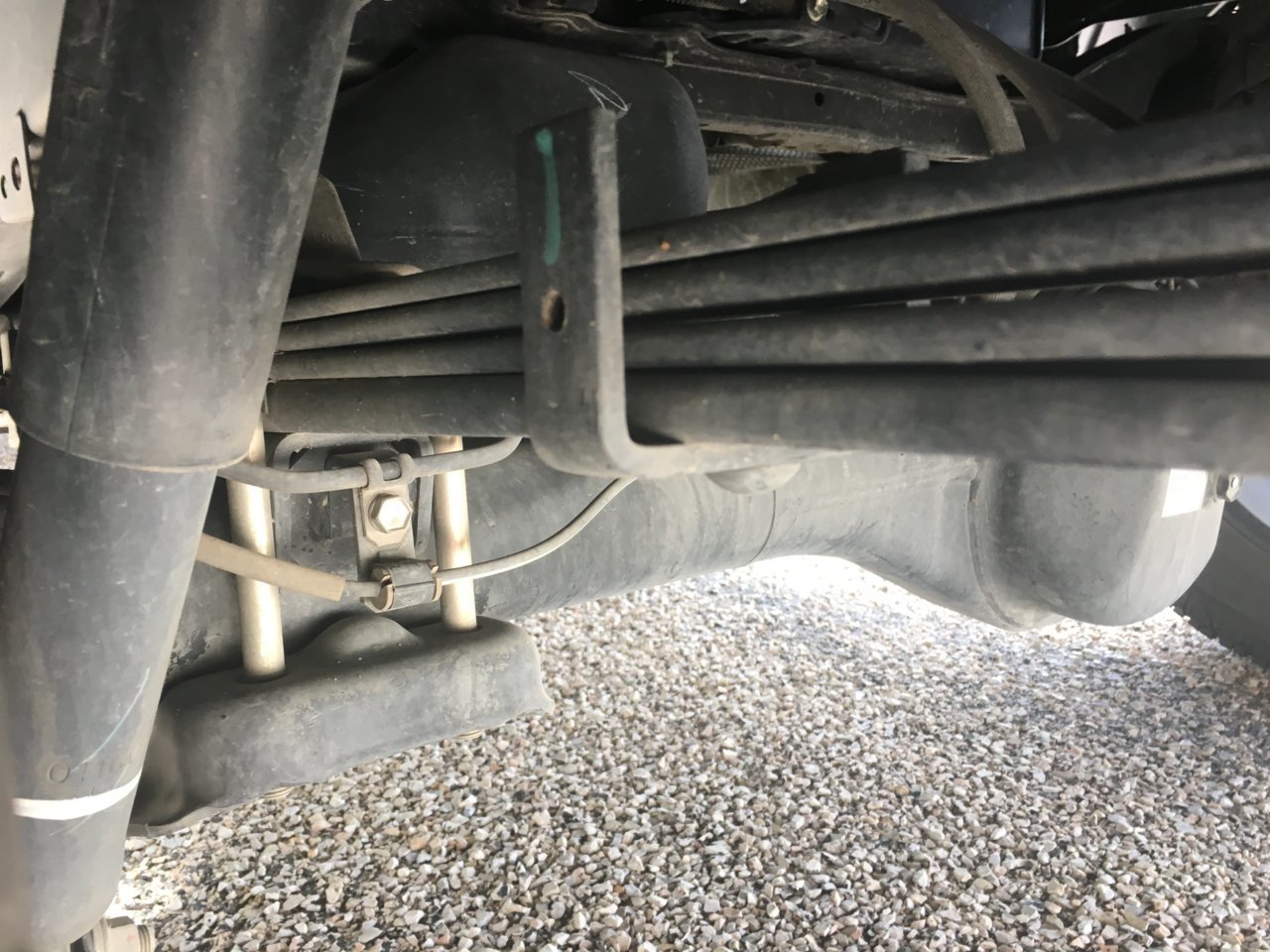

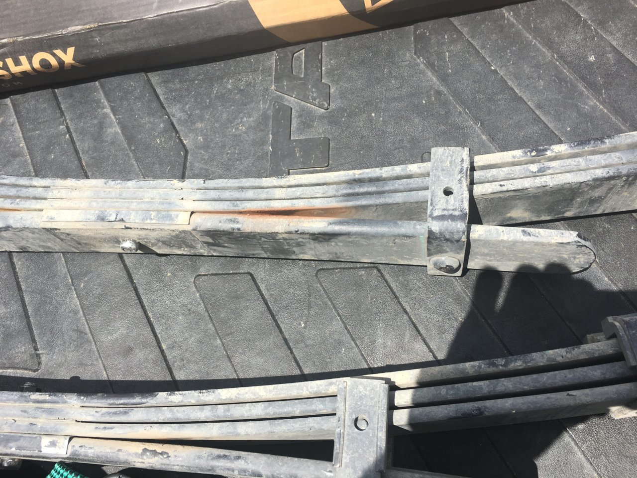

    I just took a look, and yeah - my 2015 SR5 4x4 leafs look different (thin/whimpy) compared to the take-off 2017 TRD OR 4x4 leafs (beefy)...
  10. Apr 23, 2018 at 11:48 AM
    #30
    Mitch76
    Mitch76 Well-Known Member
    Nov 19, 2015
    #170100
    3,555
    Mitch
    San Angelo, TX
    2021 F150 STX 4x4 5.0
    275/65-20 Cooper Discoverer XLT. Borla XR1.
    Definitely different. Currently on truck is top pic. Bottom is the '17 3G offroad.

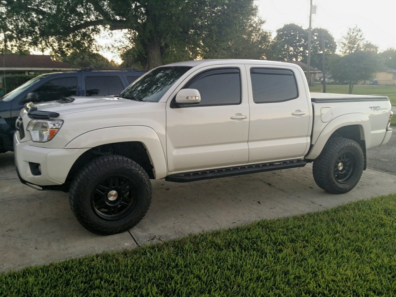

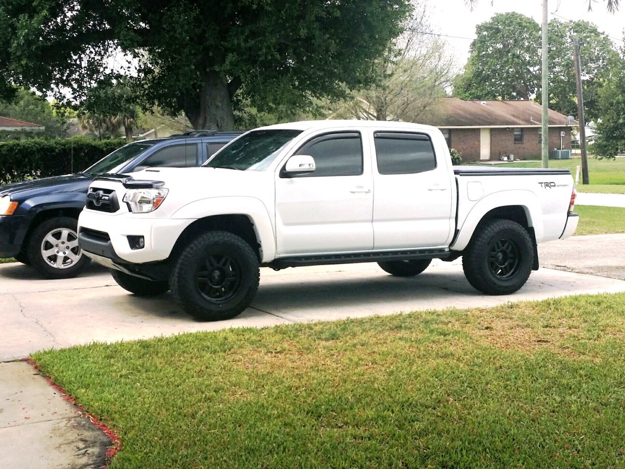

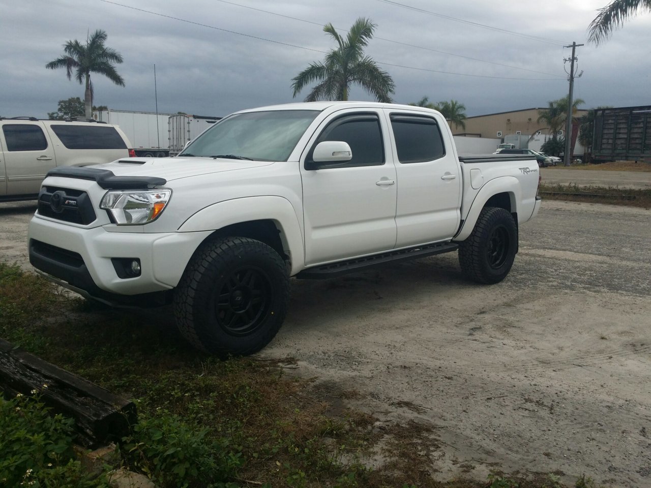

    2016 Sport suspension 1/2 spacer up front and aal in rear SCS Stealth 6 17 inch wheels Wildpeak AT3 265 70 17
    #METOO. I bought a 2016 sport suspension ($100)added a .5 spacer up front and an aal in the rear. Kinda hard to tell since I went to a 265/70/17. The ride is little rougher than the 2015 sport suspension but I think its the aal more than anything else. I will say i like it more on the road because it doesn't "float" as much.
    Before
    Front Only w/ spacer. When I accelerated I got some bro-lean can't have that. Plus I think the trucks lines look better with some rake.
    After
