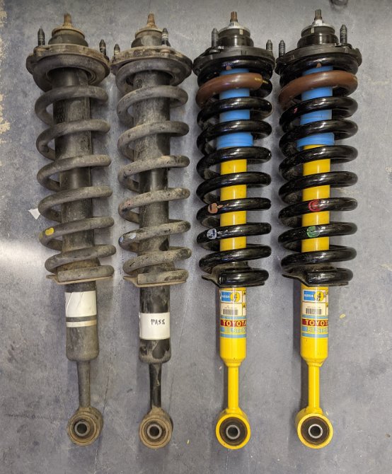

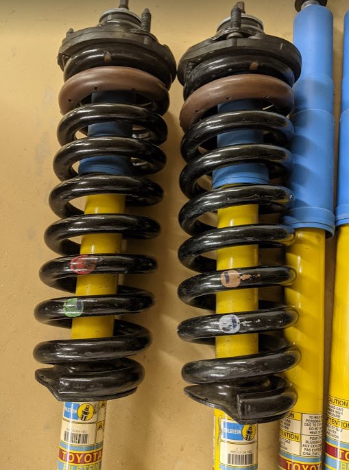

    I'm second guessing this. Some other threads indicate that the end of the coil should be facing rearward when installed. I have my old ones out and it looks like red/green wants to be on passenger side to make this happen. I have them aligned in this pic so the studs and springs match the ones I pulled off. Driver's is far left and matches the gray/brown:
    Should I follow the paint, or the springs?
  19. Jan 9, 2021 at 10:37 AM
    #439
    Taco? Who knows
    Taco? Who knows Well-Known Member
    Jul 16, 2020
    #334682
    149
    New England
    2009 DCSB Off Road
    Follow the paint.
