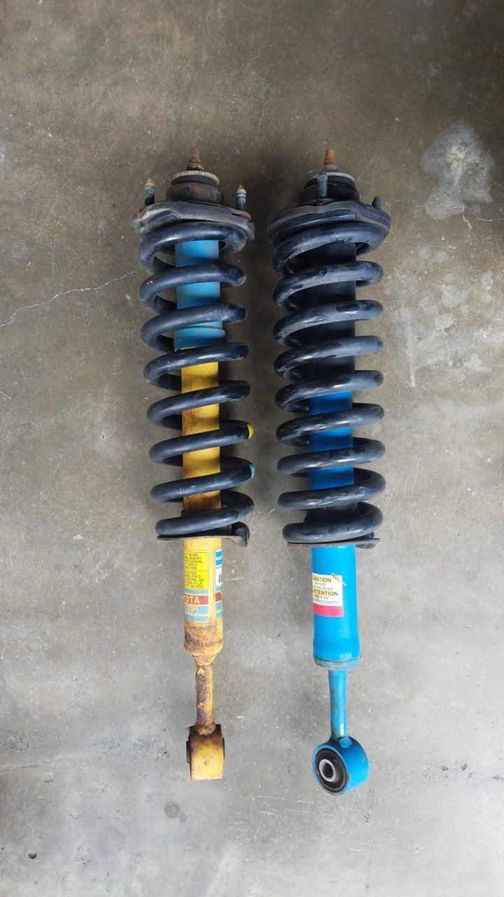

    20210303_124459.jpgThird gen TRD Sport fronts (right) replacing my 2nd gen TRD Sport (left). Gonna get an alignment and I'll report back.

    2013 DCLB Sport 4x4
    That’s not any different I don’t believe... I thought only the OR’s have the tighter springs?

    TRD Exhaust, URD Short Shift, TRD Supercharger, Hellwig rear sway bar, TWM shift knob, limo tint, URD Y-pipe, URD LT Headers, URD Rear O2 Sim, Custom tube front and rear bumpers, LED spot pods, K&N CAI
    There is about one full revolution of spring more on the 3rd gen.

    I meant the Sport versions vs. the off road versions.... I always thought the Sports were the same and only the off road's had the extra spring revolution? Or maybe I'm thinking the Off Roads had the softer spring rates vs. the Sports....

    To my knowledge the springs between the 3rd gen Sport and Off Road were the same. But the struts and shocks are valved different. The OR is softer valving and digressive while the Sport is stiffer and progressive. So, if you have a 2nd gen Sport and install the 3rd gen OR you'll notice a huge difference in ride quality. If you have a 2nd gen OR and get the 3rd gen Sport suspension you'll notice a considerate increase in stiffness but less body roll. Also something to note is the front sway bar thickness on both generations Sports are slightly larger and stiffer than the ones on the OR and Pro, which can effect ride quality slightly. I am curious to test them on my own truck by driving with one sway bar, swapping and then trying the other. But I have since installed 6112's and removed my sway bar.
