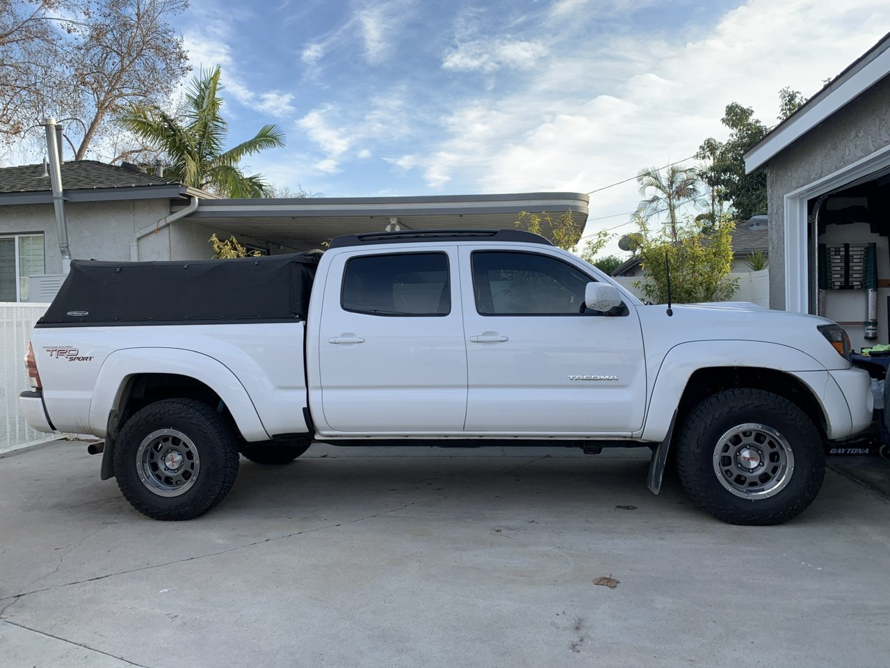

    I think you may have more rear lift than you want with that setup. Figure you’re going up ~1.25” in the front and ~2” in the rear. That should then yield ~0.75” more rake than stock.
    Here’s my truck with 3rd gen suspension in the front + a 3/8” thick spacer (~1.75” net lift) and a 1” block in the rear on TSB springs. Theoretically yours would be a half inch lower than mine in the front and a full inch higher in the rear.
    I recently installed Bilstein TRD Pro suspension paired with a Headtrong AAL with overload left in. I should check to see if any settling occurred but I actually got almost 2” of lift above where I was with the 1” spacer.
    Unless you are looking to increase rake I would consider altering your plan. Maybe more lift in front? Maybe take out the overload leaf to reduce rear lift?

    You could always consider a block for the rear but if your existing pack is sagging then that's something you'll want to deal with. The stock pack doesn't have much arch when weighted so what you're seeing might just be normal. I had near new TSB leaf packs on mine when I bought it and they were basically flat when new and had zero sag.
    If your leaf pack is saggy then I wouldn't do a block or AAL until you deal with the leaf pack. Not sure about your region but around here you can get 3rd gen take off leaf packs for cheap. There's even someone in the forum right now selling a 3rd gen leaf pack + Headstrong 3 leaf AAL for $100. They're missing the overload but you could pull that from your existing pack if you wanted.
    I would not remove the overload spring unless you're doing an AAL and want to reduce the amount of lift. This seems to work for a lot of people. Personally, I like the extra lift and I fairly regularly carry semi-heavy loads so definitely don't want to be without the overload.
