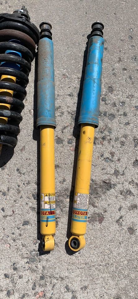

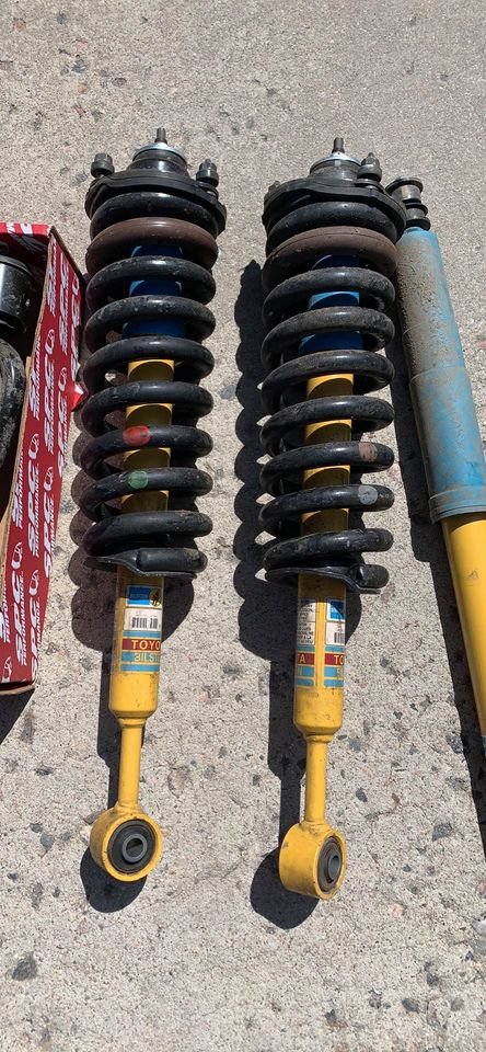

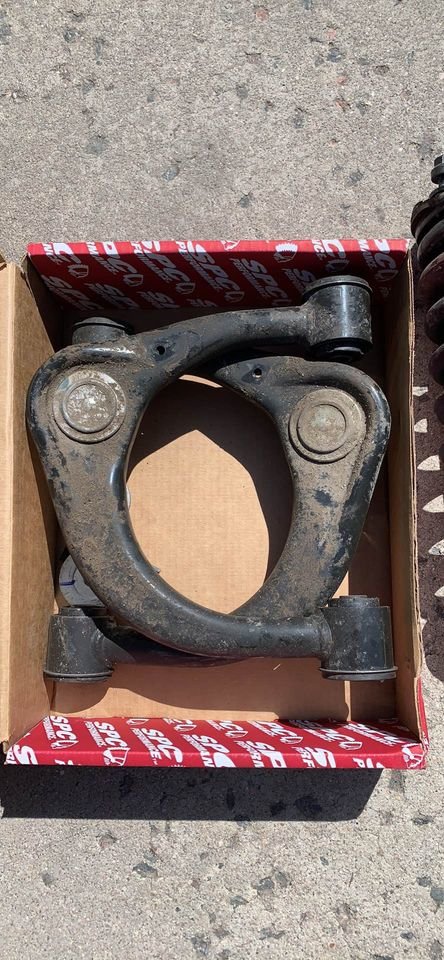

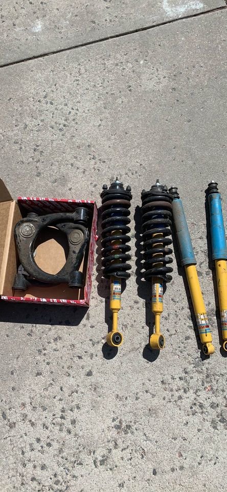

    Looks like more then 2k miles. How much is he asking? Depending on the cost you may be able to get a new set of Bilstein 5100s for close to the same price. You also don't need to swap the UCA unless your bushing are worn.

    Impossible to tell mileage from those pics since the parts are super dirty. That dirt could be from 1 mile or 10k miles depending on conditions and how often they were cleaned. I'd look at the rubber bushings, that's where you'll see the wear starting.
    You don't need the UCA's but I swapped mine out when I installed my 3rd gen suspension simple because they had 15k vs the 190k on my truck.

    He's asking $175 for the set. Yeah I read some more and saw I don't need the ucas.
    My truck only has 30k so I'm assuming if the UCAs are the same I definitely wont need them.

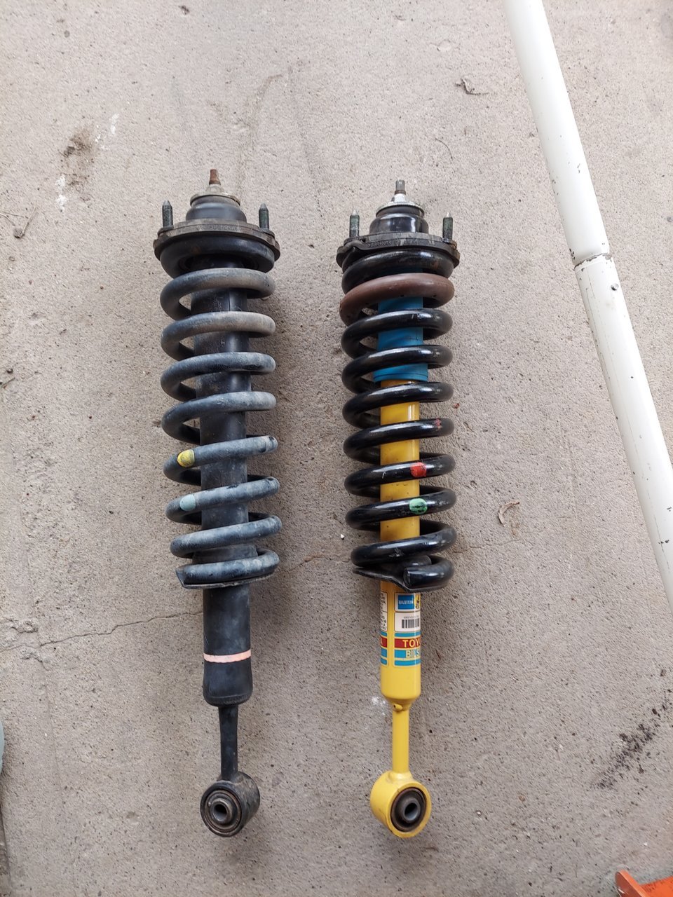

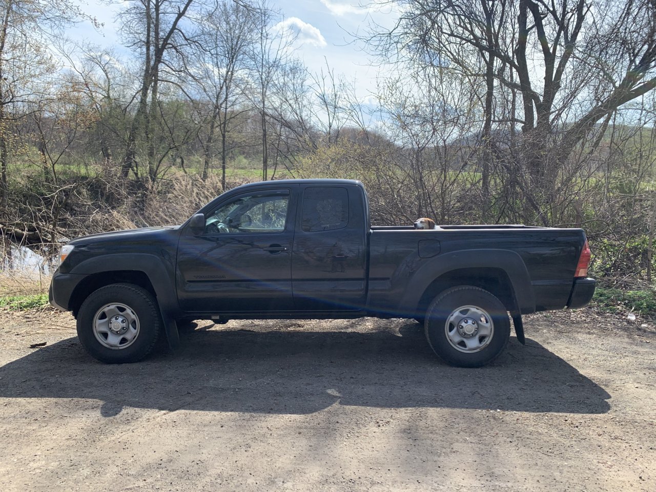

    Installed front shocks and springs off of an 18 Off Road on my 15 SR this weekend. No spacers. After driving it a few hundred miles it sits 1/2" higher in front. Ride is fantastic. Handling is so much better and the truck feels so much more stable going down the road.
    And braking! Doesn't nose dive nearly as bad and much more controlled.
    I would really like to find a Sport set up and try them out.
    Of course i didn't remember to get a before and after shot. I will snap a picture sometime this week.
    Did manage to get one of the assemblies next to each other (i'm sure SR suspension is the same as SR5 but, here it is anyways)

  13. May 23, 2021 at 6:23 PM
    #513
    TacoTuesday1
    TacoTuesday1 Well-Known Member
    Jun 19, 2019
    #296781
    7,773
    SD CA
    Interesting.
    Replacing a cheap stock control arm, with another one that is exactly the same part.
    And replacing garbage stock pencil-thin shocks, with another set of identical ones
    sounds like a productive use of hours
    he even put the old ones in his SPC box
    Almost as if it could have been taken as a hint of "There's a reason why he switched to SPC"
