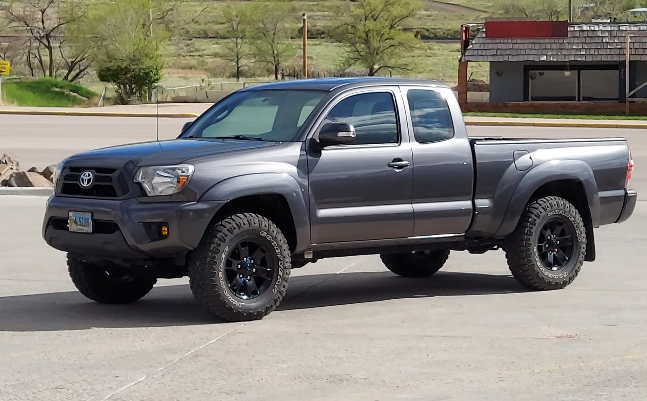

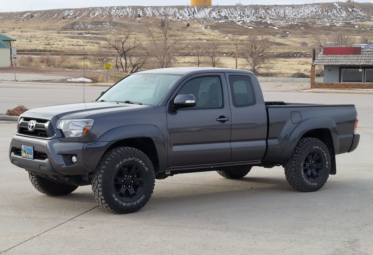

    My attempt at a before and after
    Before...
    After...

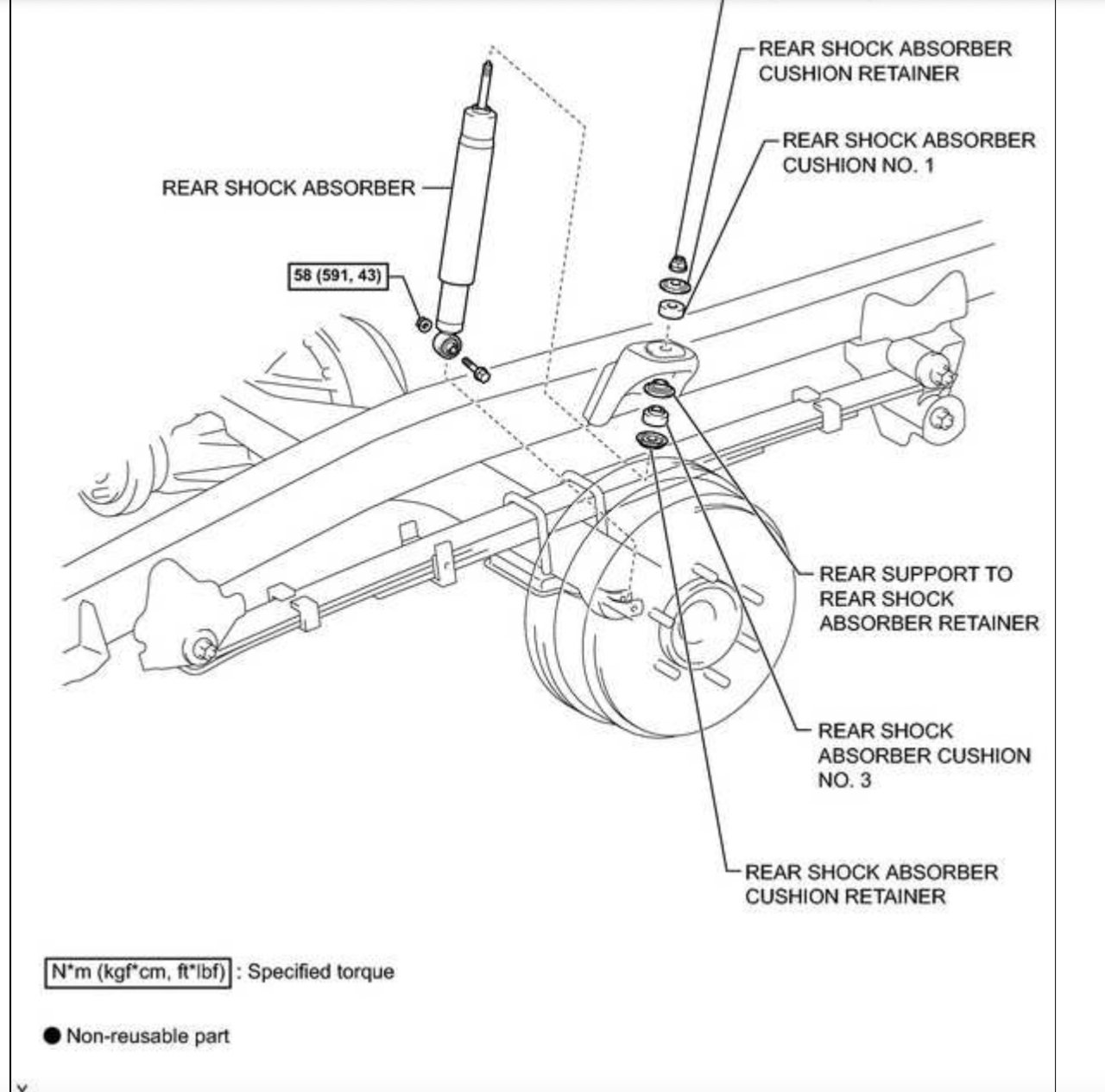

    Aight I scheduled an alignment for Thursday so I have to tackle this shit tomorrow. I am curious if anyone can tell me with complete certainty the order of bushings and washers for the rear shocks? Im all fucked up. Peace and love

    Found this on the internet. 3rd gen service manual.
    TacoFergie[OP] and tinker_troy like this.

    @Abner420 - beat me to it! Than you!
    @tinker_troy - I don't know if it's the lighting, but that looks a lot better from the first picture. Looks awesome!!

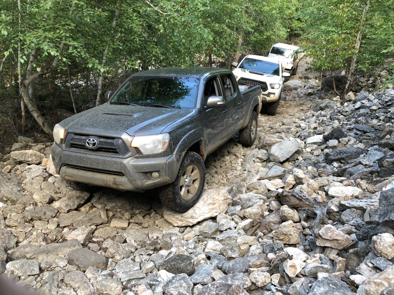

    Iowa
    Hell ya!!! It worked really well for me in the black hills which was about a month after my original post. Not having sliders is mainly what slowed me down in some spots since I have DCLB.
