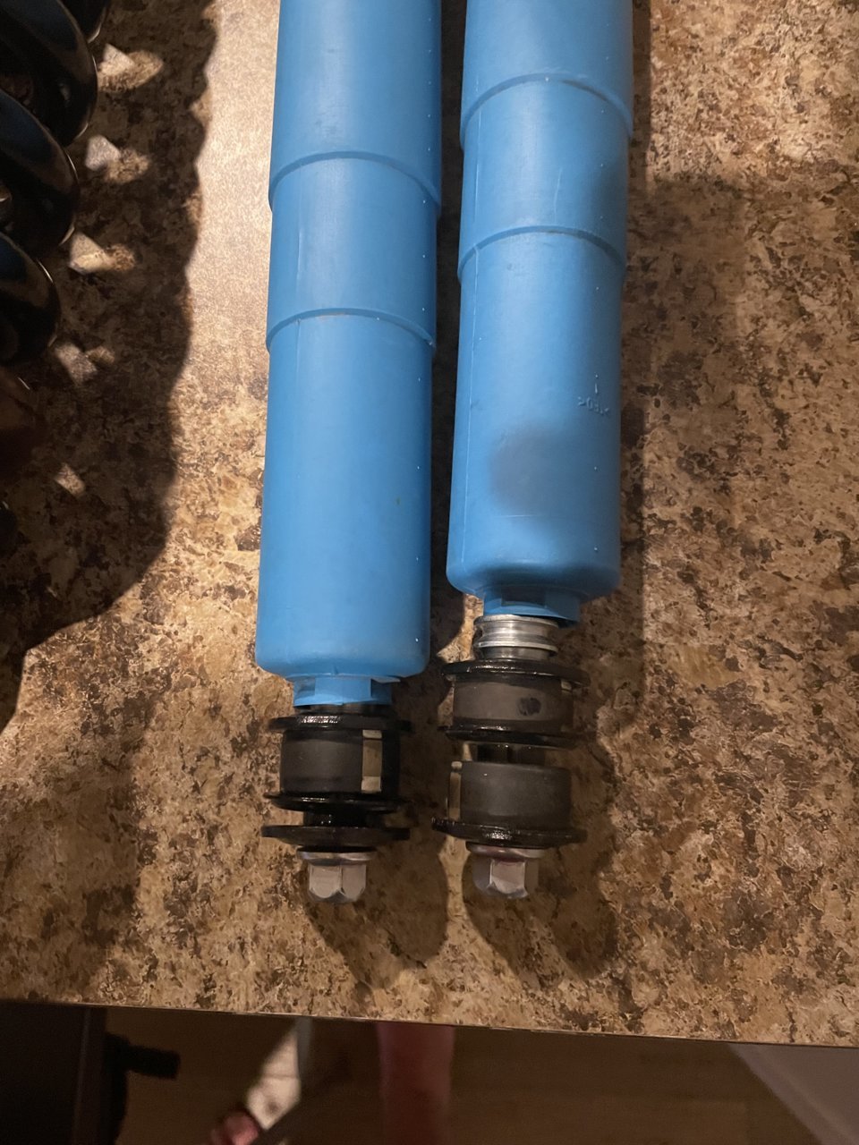

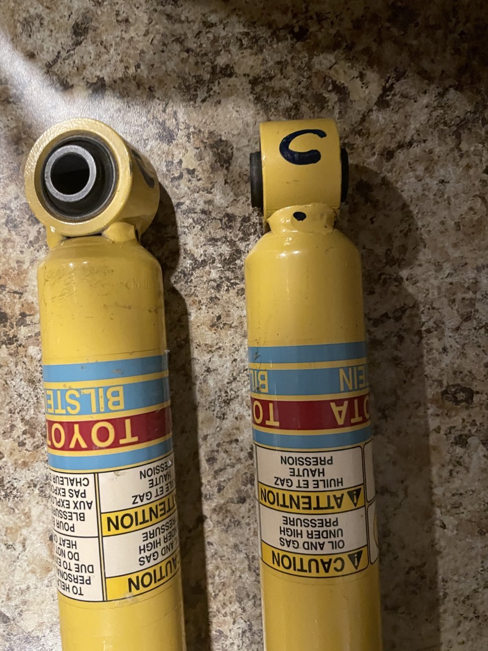

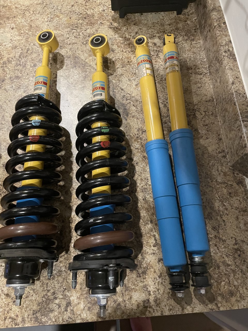

    Hey just bought this suspension from a 2019 off road for my 2nd Gen base. I know this has been posted about, but the green dot is drivers side?
    Also not super familiar with parts but trying to learn, why are the struts different and which side is which?
    One strut has 2 “spacers” and the other one has 1”spacer”. One also has a C on it. Which side goes to which?

    You’re missing a bushing from one of the rear shocks it appears.

    Blue is passenger
    Both rear shocks should have 2 bushings each. You're missing one.

    Just steal one from the rears you’re pulling off.

    Yah when you’re looking at it under the weight of the truck those bushings are going to look a LOT different. Once the suspension is off just inspect all 4 of the outgoing ones and pick the best of the bunch. You should be good to go.
