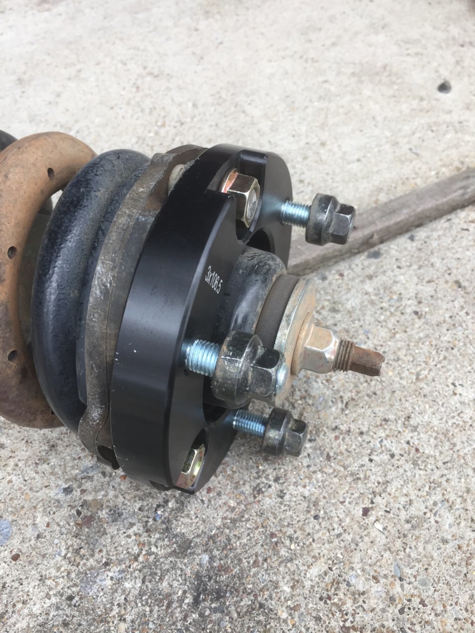

    I installed my shocks around December 24, 2017. I also installed a 1/4” top plate spacer on both sides hoping for an extra ~1/2” of lift
    Measurements up in front then were roughly:
    21.25 driver front
    21.5 passenger front
    Current measurements are
    21 DF
    21.5 PF
