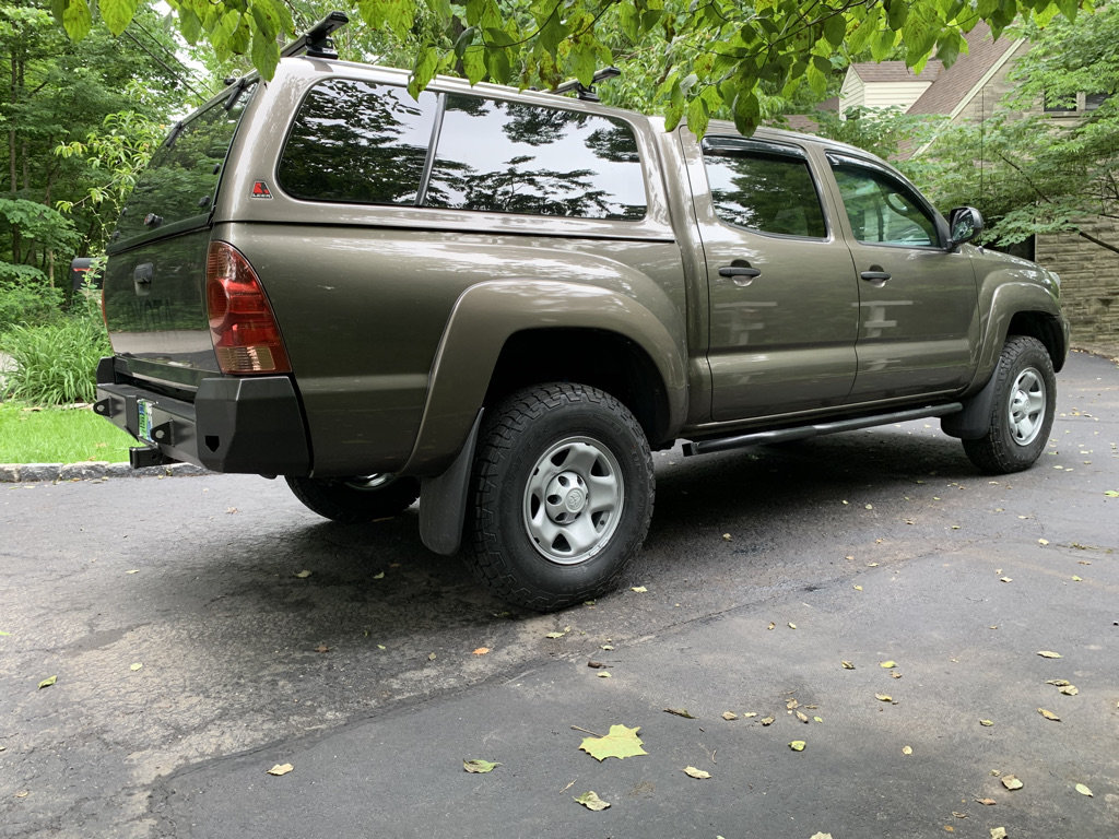

    553067B0-8D9E-41F7-83D2-CA236E643F65_1_105_c.jpg A9ED89F3-8AAF-45EA-8B2F-2782FFE79F31_1_105_c.jpg
    V6 here and the 265 is the same diameter as the 235, so didn't notice a difference really. Although the steel wheels I switched to are heavier and I do notice that a bit.

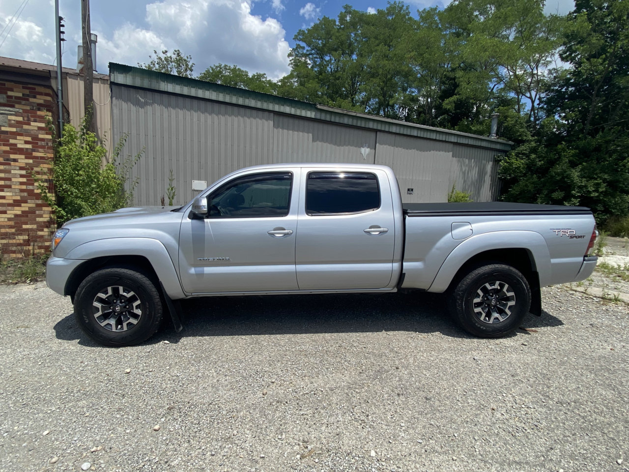

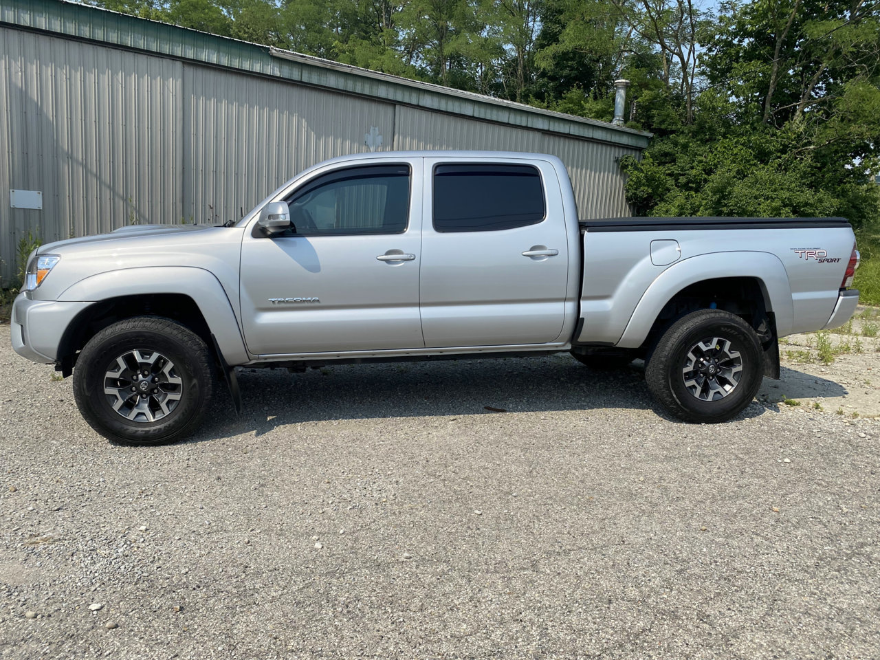

    And, it's on! Along with a bunch of new suspension components - basically a full rebuild. Check out by build thread for full details, but here is before and after. I can't praise the improvement in looks and handling enough. Like a dingus I forgot to take measurements before the install :censored: but it's definitely a lift! Keep in mind, though, I installed HD leafs from General Springs as well as 1/4" spacers in the front. Depending on how the leafs settle in a couple of months I may go up to 1/2" spacers if it needs more leveling.
    Before:
    After:

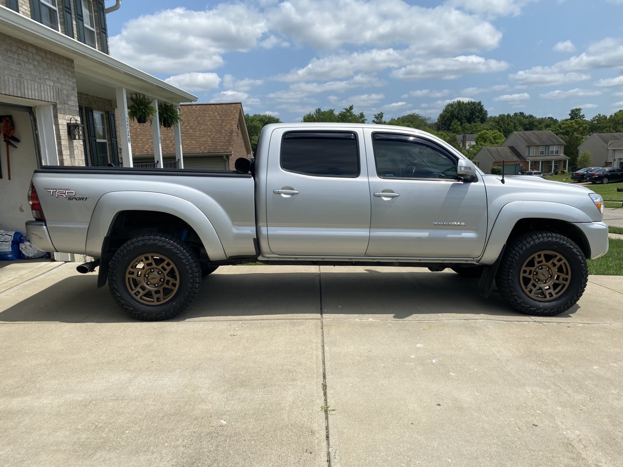

    How was the height with that.

    I think they still need to settle a bit, but here is how it looks today. I just installed all of this, less than 100 miles on the setup. Important to note that I also have 1/4” spacers on the front otherwise the rake would be worse. I may end up switching to 1/2” spacers
