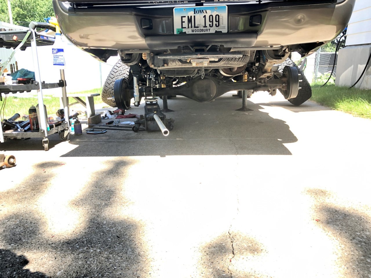

    Hey guys I'm planning to put on my 3rd gen OEM 4 leaf pack this weekend. I just wanted to run it by everyone and figure out how to do it without a lift.
    Here was my plan... put two jackstands towards the back of the frame to support the rear of the vehicle and remove the rear tires. Then put a floor jack under the axle to support it. Remove all the bolt and lower the jack a bit to create space to remove and replace the leaf spring. Am I missing something important?
    My concern was that I may need to get the entire car on jackstands to balance it better.

    i just did mine a couple weeks ago without a vehicle lift. i think it would have been pert' near impossible without two floor jacks and two jack stands. but i probably did it wonky.

    I used a jack under the pumpkin to lift the truck (jack doesn't go high enough to get the wheels to come off the ground using the frame to get the tires off the ground) to get jackstands on the frame.
    -Place the jack under the side you're going to start with, jack it up just a smidge to take weight off the shock bolt and make that easier. Only do 1 side at a time!
    -Leave the shock off at this point
    -Remove the U-bolts from the axle and lower the axle until you feel there is enough room to work. May take a couple tappy tap taps from a hammer to get the leaf to release easy from the axle. Don't lower the axle too far, keep an eye on the rear brake line to make sure your no stretching it.
    -Remove parking brake line bolt, forward bolt and then the aft bolt. This is easier with a second person to support the opposite side of the spring, but if your somewhat strong you'll be fine.
    For install you pretty much just go the reverse order and use the jack to bring the axle up to the springs to install the U-Bolts. Make sure the small locator pin is seated before torqueing the U-Bolts. You may have to move the axle around to get that to happen, this is normal. Do NOT tighten the forward and aft leaf spring bolts at this time, leave them with some free play. The forward and aft bolts get tightened once the truck is on the ground. If you tighten them in the air will bind in the eyelet and the bushing will wear faster and squeak.
    U-bolt torque is pretty hard to find an accurate/across the board answer. I went with 86 ftlb. Torque the U-Bolts small amounts in a criss cross pattern. You don't want one end to have substantially more thread protrusion than the other. After driving a few days retorque the U-Bolts, no need to jack the vehicle up.
    This is when I did OME leaf springs and B110 5100's to give you a visual placement.
