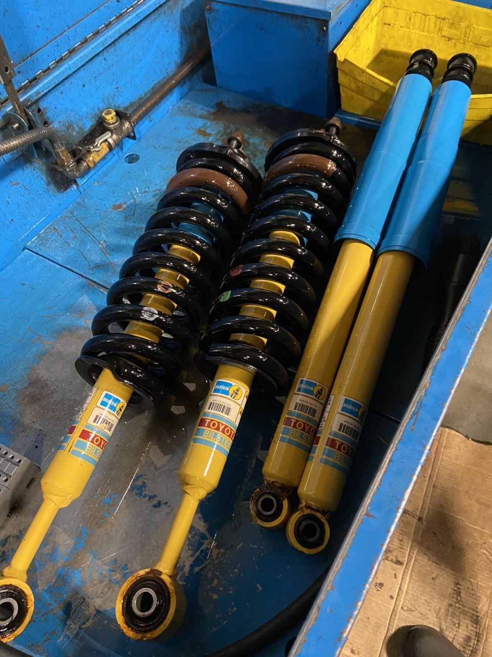

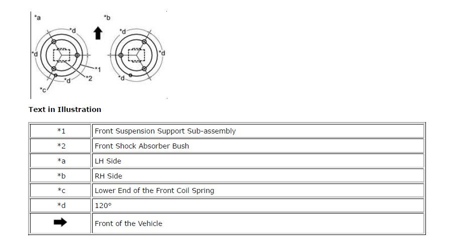

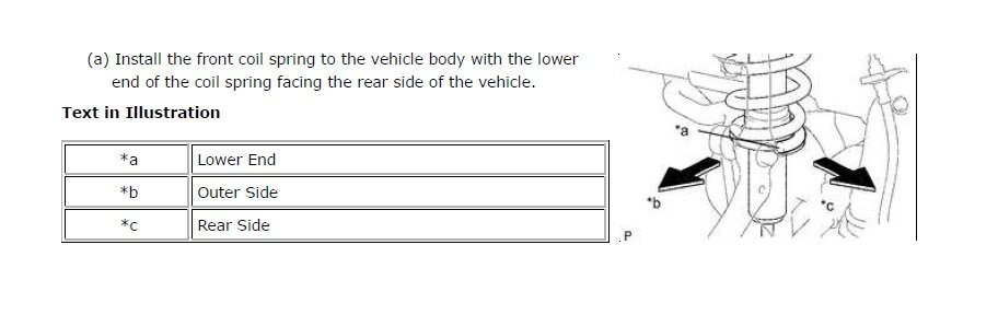

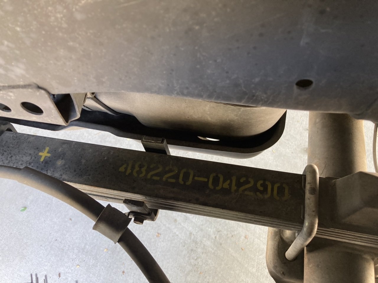

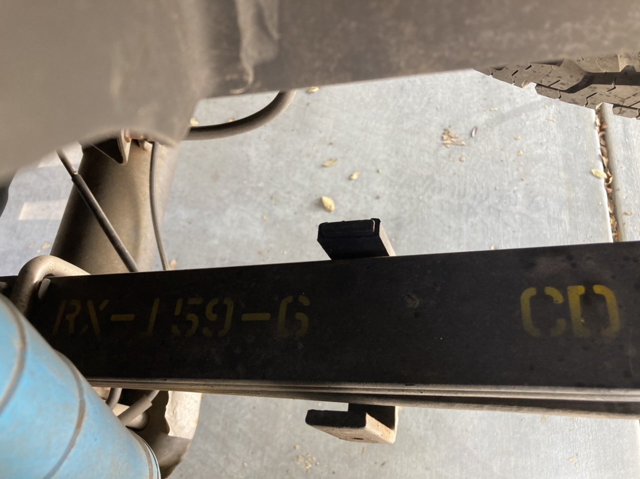

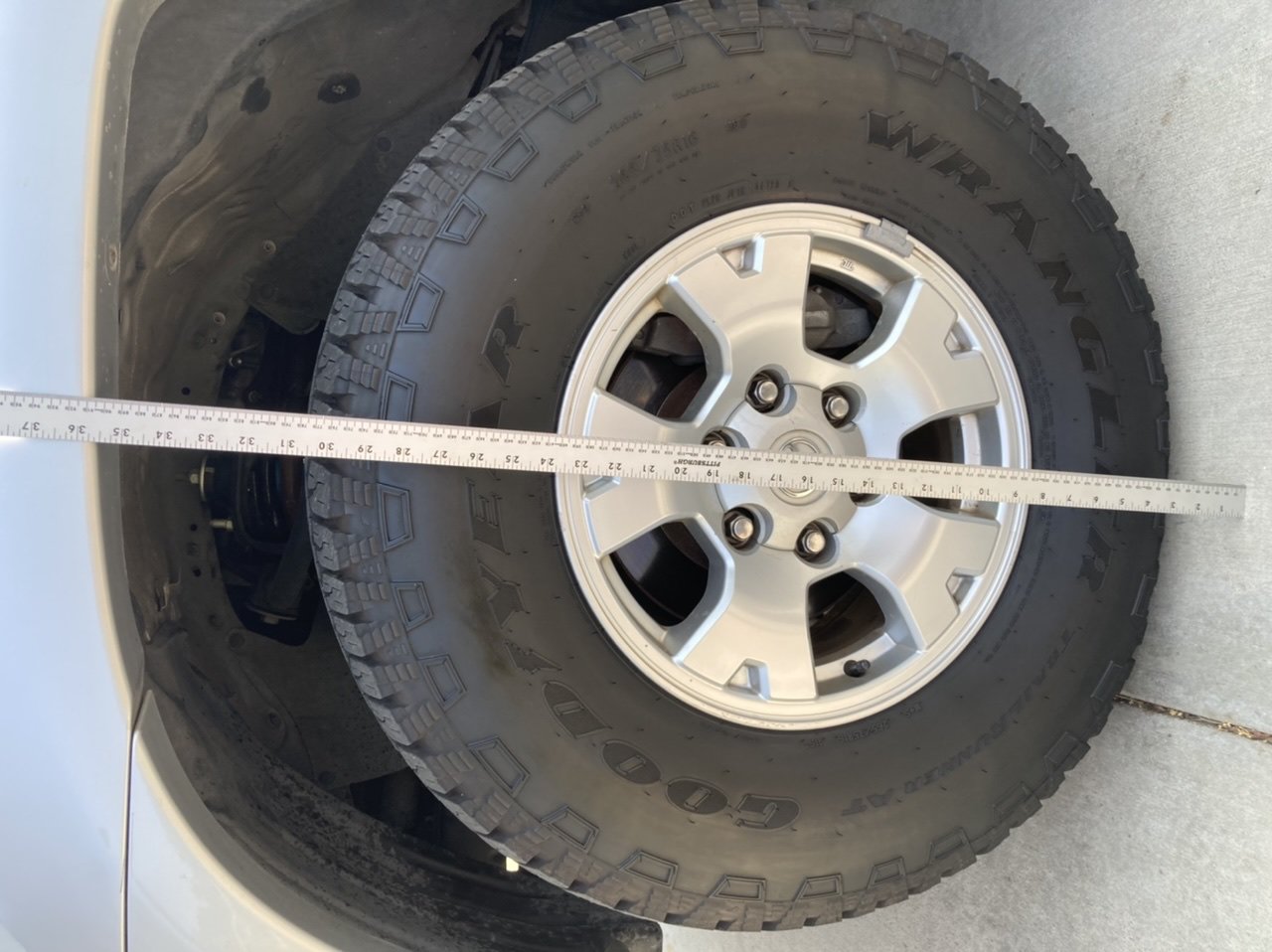

    7F5A2DA4-11FD-42A8-A96F-A33BFAA90C7A.jpg 39D3B643-D938-4DD8-B6B1-9CEA6E46B0D1.jpg DBBF28DD-14C4-49B6-9E04-07EC83773600.jpg 62E6D3DB-4BC6-41BC-88F6-6E1F9BDB0304.jpg E96A8430-3891-4AB4-A953-FE4DD2DE24F3.jpg A34027AA-8BB0-4E1A-81B3-88D2555F42E6.jpg FE6205C9-E054-4A49-A40F-1DC0B599CD3A.jpg D15787FD-E5FE-4526-A88C-168F1DA3ACE6.jpg Driver side( bottom spring end facing the cab(red/green dot)) passenger side(bottom spring opening facing cab as it should(red blue dot)) no AAL, just a fresh set in the back
    Following a photo of the truck with weight in the back (take in consideration road crown)
    Cheers.

    @Ricardo13x where'd ya get your springs from? I need a new set for the back and OEM and crazy expensive..

    I believe there was a recall not so long ago and when I got the truck they were in there. I’m the second owner to the truck. What I got in the beginning of this year was, the 4 shocks and front spring out of a 2020 dcsb trd off road. For 100 bucks with less that 500miles on them.

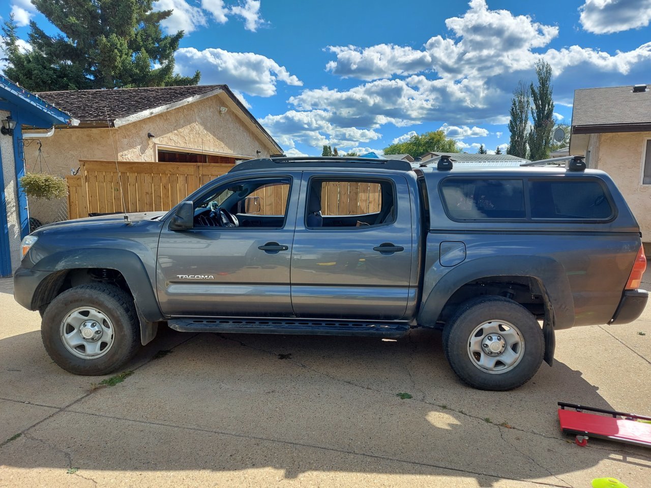

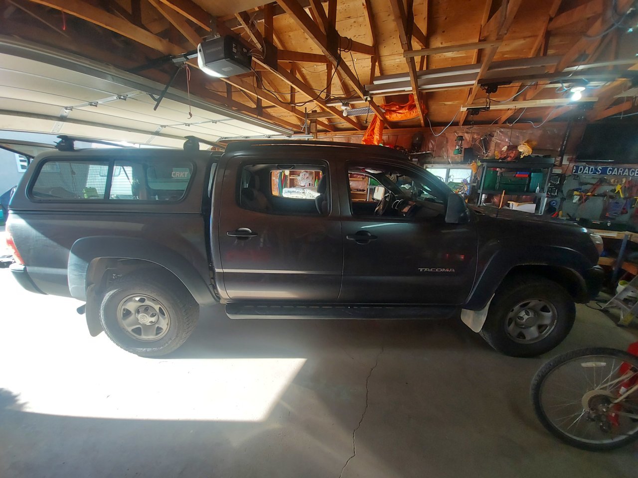

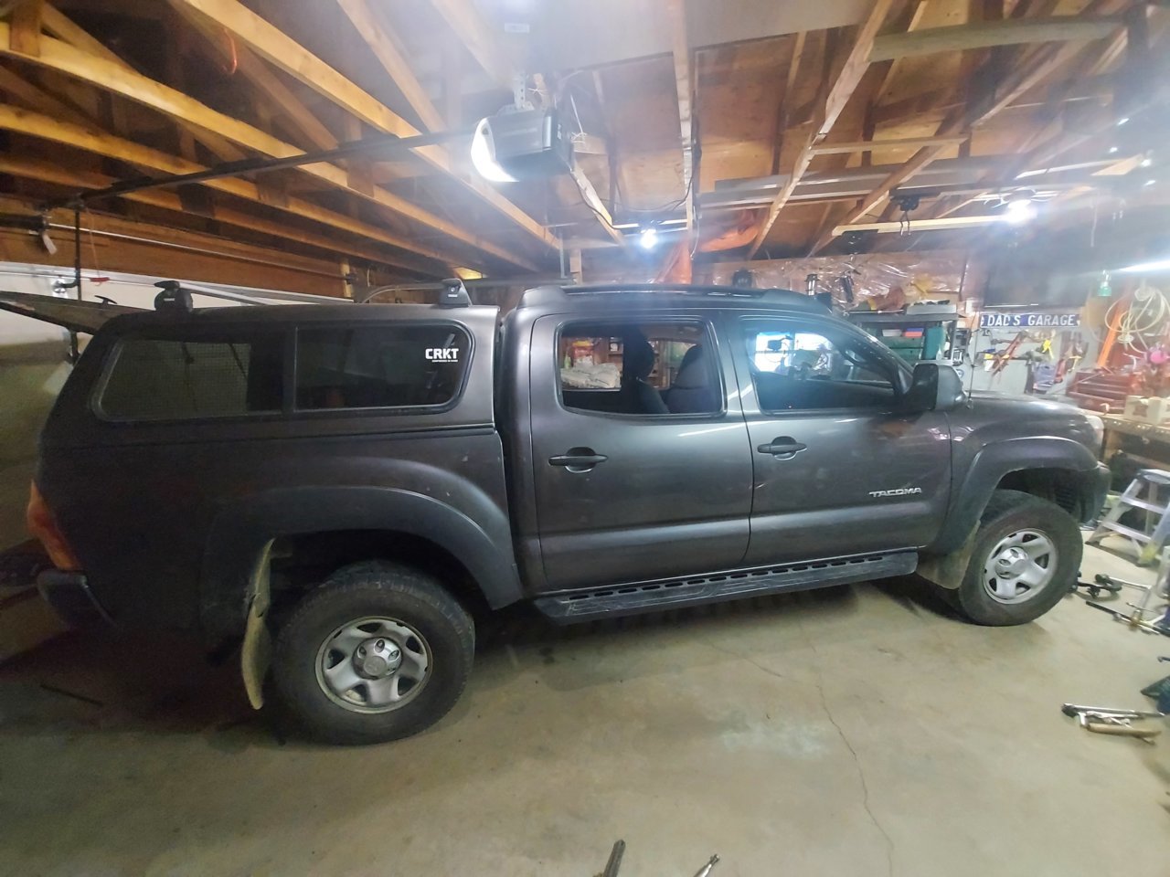

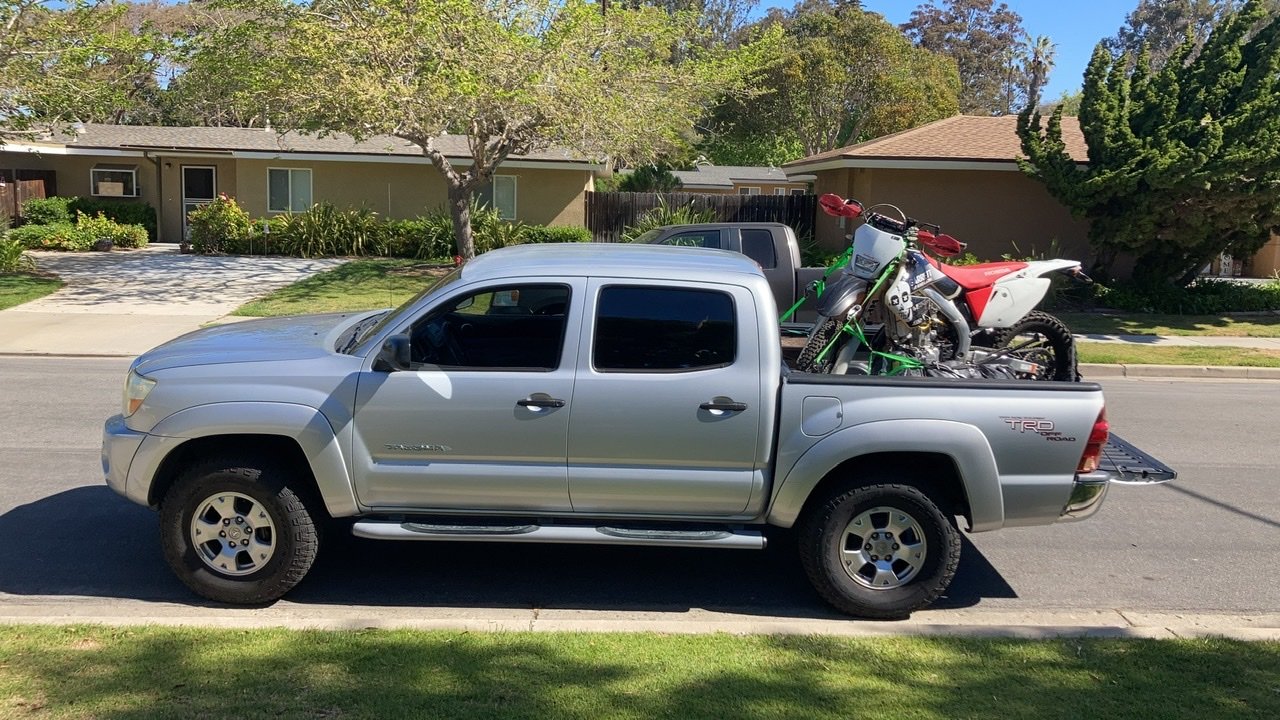

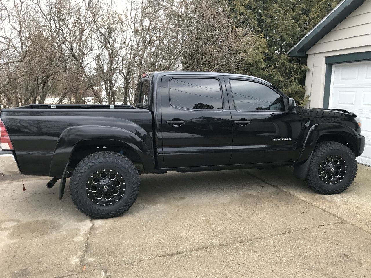

    I bought a set of brand new take off third gen suspension a couple years ago and finally decided to make the swap. Based on what I've seen on this thread I added a 1.5" add a leaf to the back and a 1/4" spacer to the front coilovers. I ended up with between an inch and a half and two inches in the back, and somewhere more like an inch to an inch and a quarter in the front. I was hoping for a more even lift front to back, and maybe it will even out a bit after I drive a few hundred km. We'll see. I'm not too upset about a little more lift in the back than the front, as I tow a travel trailer, so it may work out well. I need some new tires in the next month or two, so I think I'll go back to 265/75/16, right now I'm on the stock size, 265/70/16.
    First picture is before, the second two are after.

    Doing the red green dot drivers side has the lower end of the spring facing the front.
    Is this a problem or does it really matter?
    The set I got had red/green and white/orange on them.

    Review post #622 before installing.

    I did but in order for that to work the red/green dot would have to be passenger side?
    Without rotating bottom of shock the 3 holes are timed.
    Maybe the color codes are different on the newer ones?
    They are installed now red green drivers side and bottom of spring facing forward.
    Everything seems fine so far.
    It has the driver side 1/4 lower but drives handles like new.
    Sway bar seems close but hasn’t rubbed yet.

    You won't have to worry about the sway bar contacting it at all since the outside diameter is no different that what you replaced and the lift isn't drastic. Where you run into issues is with more lift the bar will become more stressed and angles have changed which can lead to the sway bar contacting the spring. For that issue it can be addressed 2 ways, longer/adjustable links or a spacer on the sway bar mount.

    It's amazing how asymmetric everything is on the front suspension...
