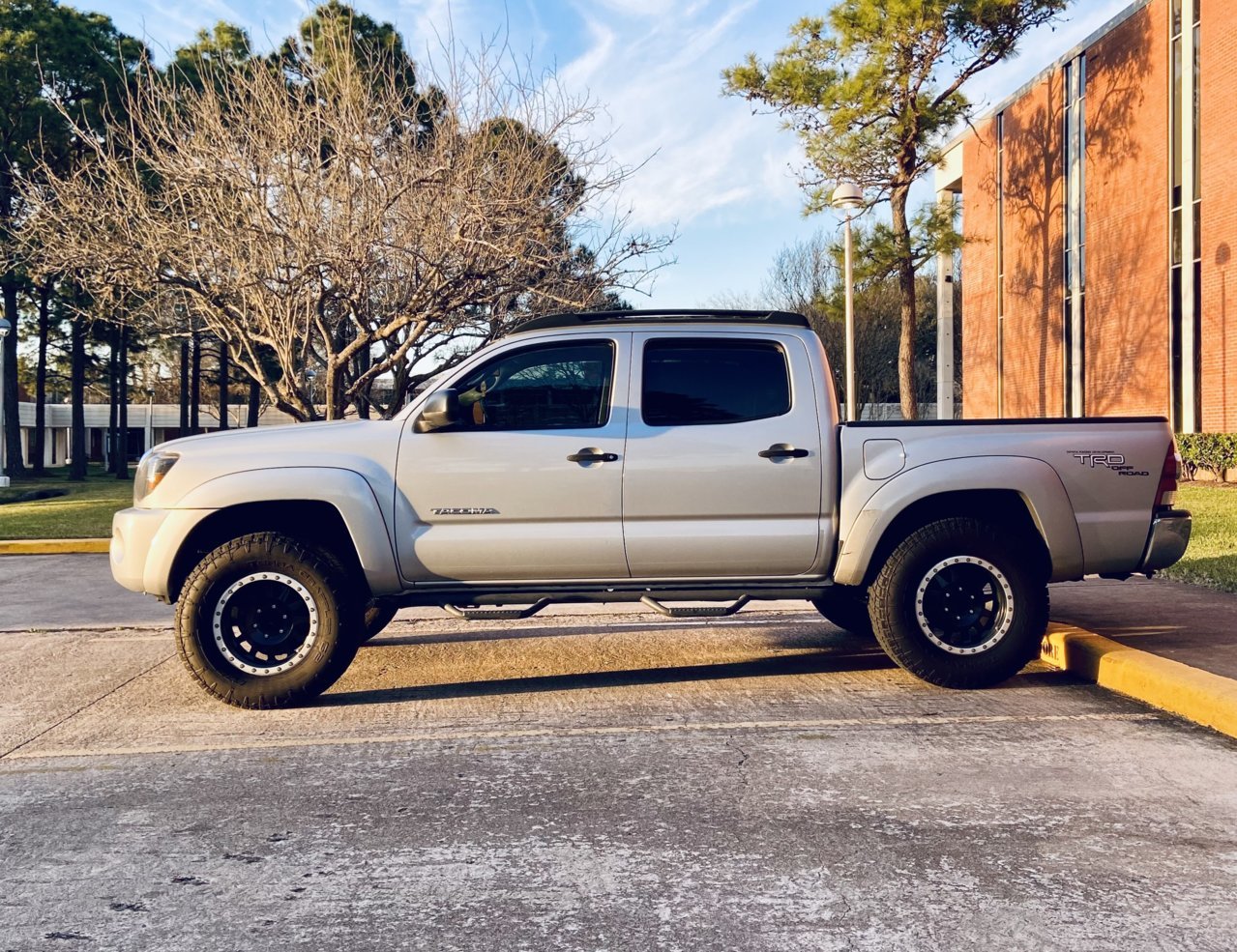

    There's also a 3/8" spacer - that's what I went with so that I didn't have to deal with the studs.
    Here's one example: The 3rd gen take offs + 3/8" spacers yield ~1.5" of lift which is a pretty perfect setup, IMO. I enjoyed mine that way until I added armor and lost most of my lift, lol.
