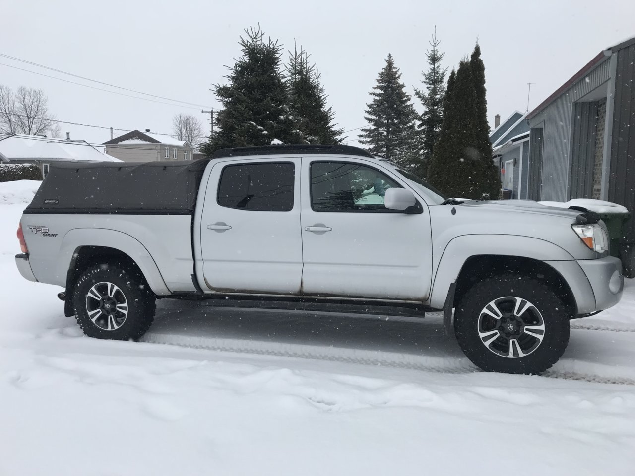

    2008 trd sport
    3rd gen trd sport suspension

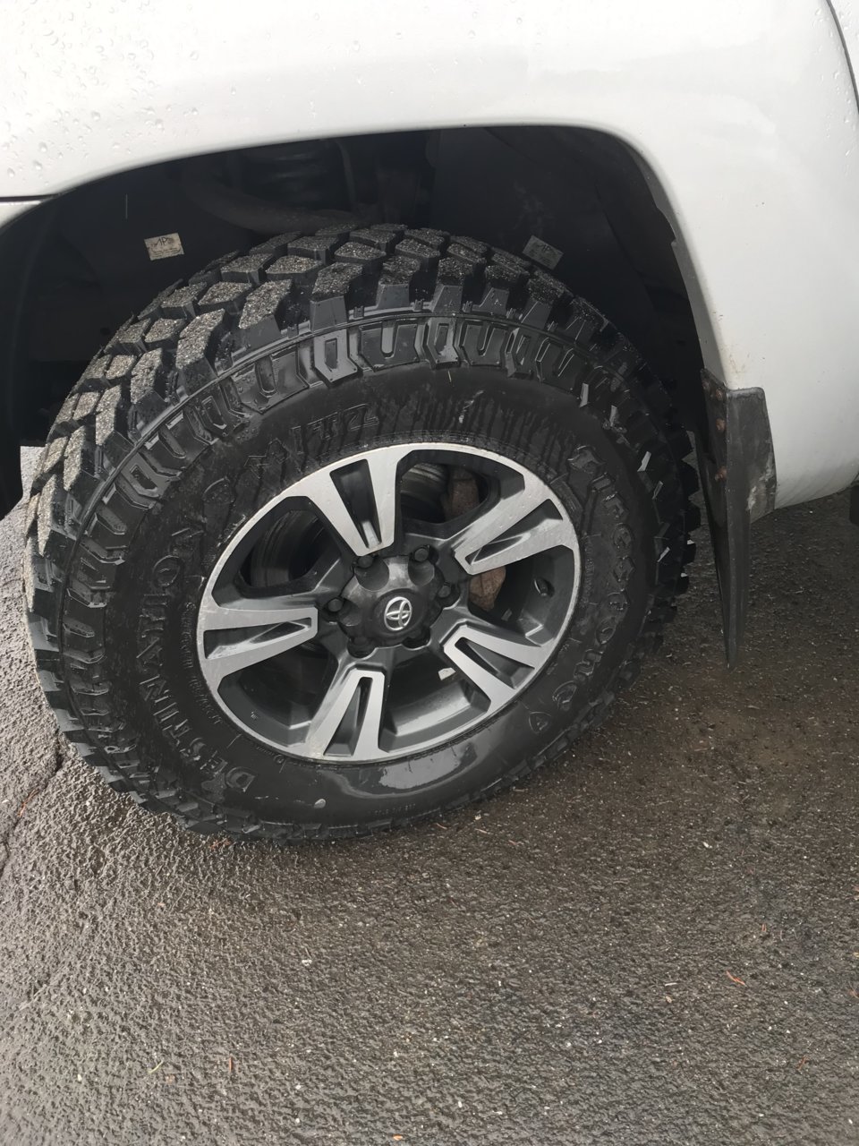

    For your info , 255/75r17 fit on 2nd gen with the 3rd gen suspension swap. No spacer or offset wheel needed.
    They are easy to find on used market. Jeep wrangler willys come stock with those and jeep guys always want bigger so i scored 5 new tires for 900$cad

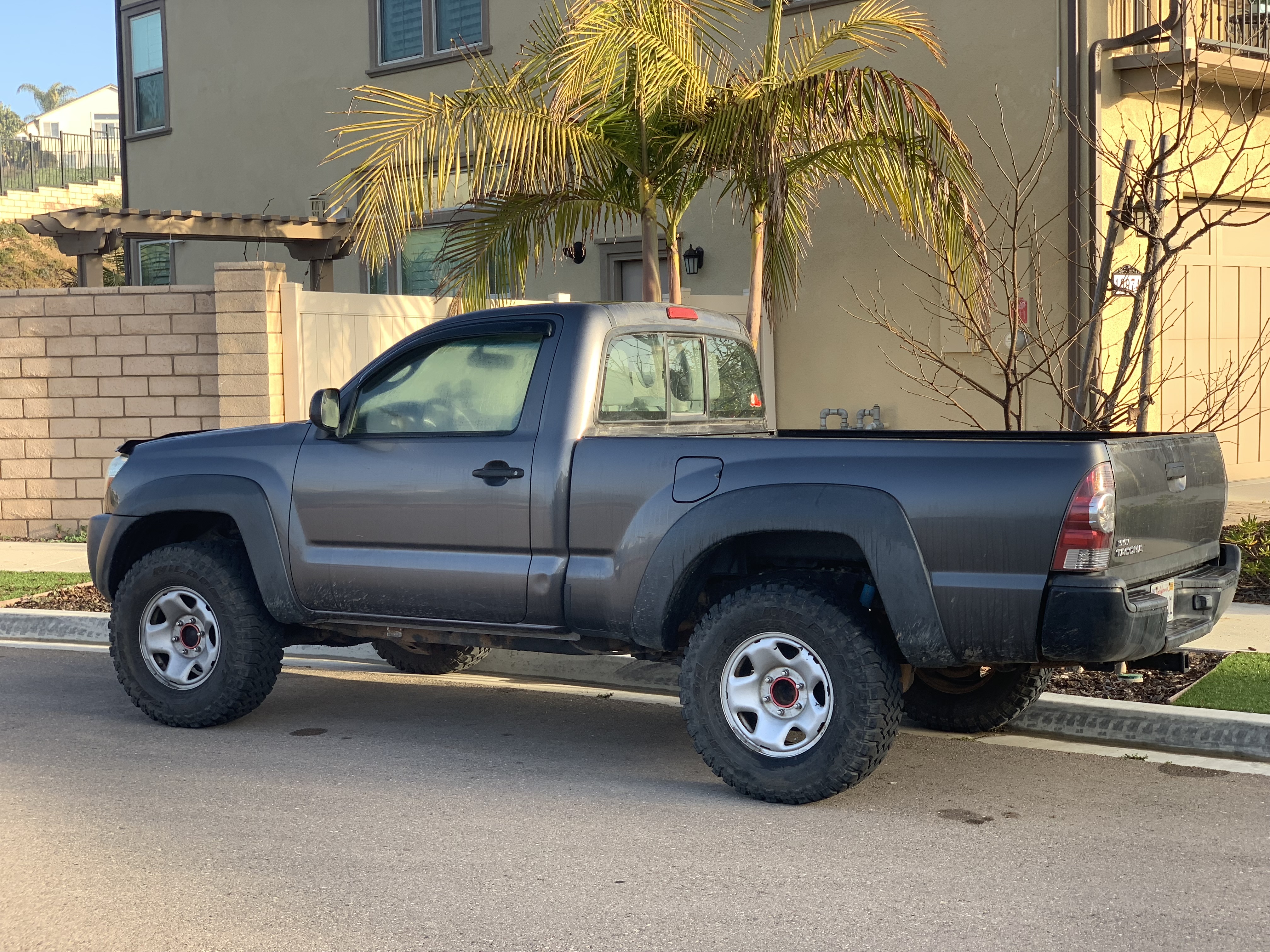

    Here's my RC with 3rd gen OR front and rear suspension. I got the leaf springs and all from the guy selling his.
    It for sure improved the ride on my truck but I'm sure this was mainly due to putting fresh dampers on, which a lot of people are doing when they get this setup. Dampers with 50k+ miles on them aren't going to feel as good as 5k dampers.
    The truck was a little stiffer from the spring rate but not uncomfortable. Coming from 15 years of coilover'd cars, it wasn't my definition of stiff.
