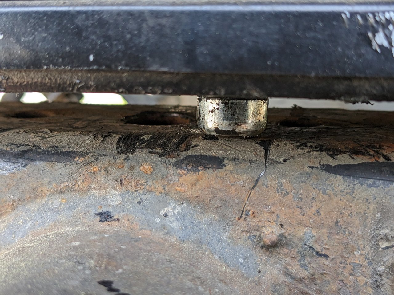

    Working on doing this with my 08. For the most part it's gone pretty well, but the last corner is giving me trouble. Right side leaf spring won't line up exactly. Either the two through bolts will fit and the center pin won't line up in its hole on the axle, or I can get the pin set but a through bolt hole is off. In either case it's about half an inch but I can't pry it forward or back to line up.
