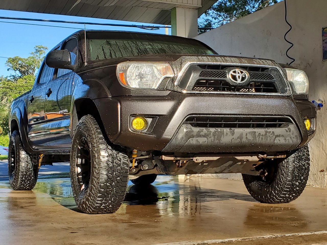

    Found a set of 2020 TRD Offroads a few wks back for 150 (just the shocks/coils all 4 corners).
    Got them put on today and it is a noticeable difference drive wise. Previous ones had almost 114k on em - i forgot to mark before height but it looks between an inch and inch & a half (2wd 4cyl)
    Feels waaaaaaaaay more planted going around curves and very nice rebound and more controlled feel on the short offroad bit i did to test her out.
    Plus i got an alignment which was desperately needed - the old specs looked like a numerical Picasso

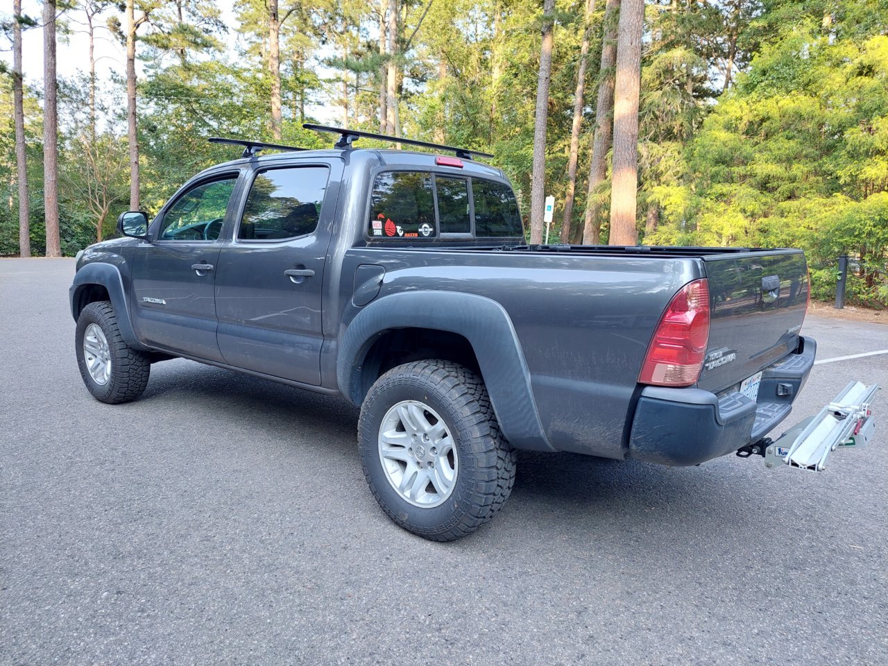

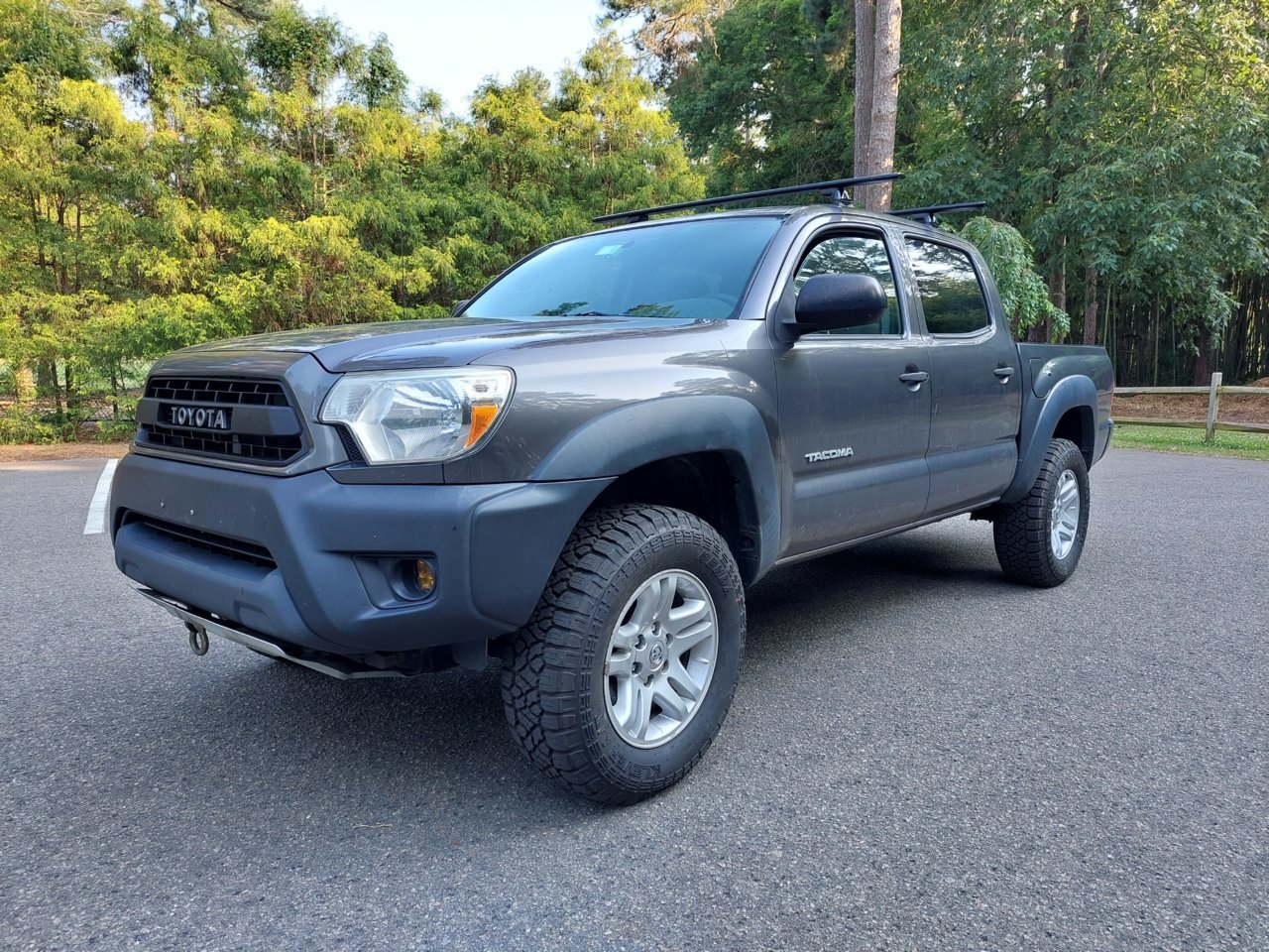

    Pics of the 3rd gen suspension up front with the MZS 1" blocks and 4600s in the rear. This was part of a broader refresh with 17" Tundra wheels, 255/70r17 Kenda Klevers, Rhino Rack roof rails, and the Yakima racks. Love how it looks now... subtle OEM+.

    Nice. I wish I'd done somthing to the rear myself- its not dog draggin its ass on the carpet type look but i can feel like its more travel in front than back which is weird for a truck. I may replace the leafs at some point and add one.
    As far as the stiffness it was night and day for me but about 2 months on now everything has settled out. I just took mine on a cross state wknd trip and it took the crappy roads a light trail perfectly

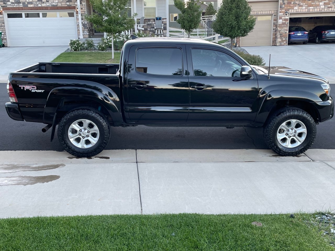

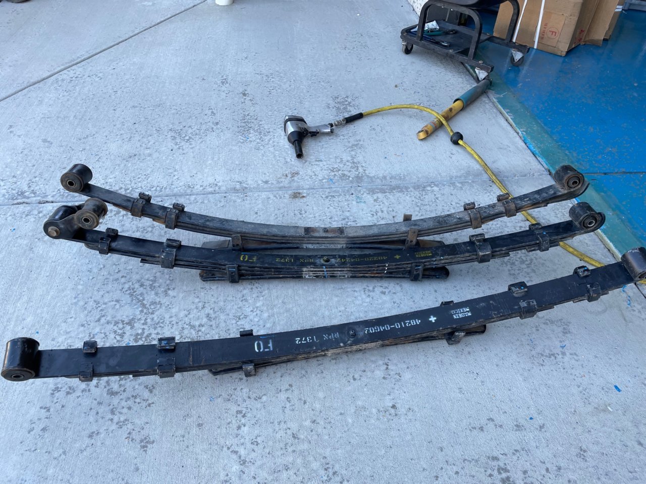

    Swapped over 2022 OR front and rear including leafs and UCA's to my 2012. During the leaf swap I noticed my original leafs had more of a curve to them (older spring further away for reference). Anyone else notice this? I think actually lost a tiny amount of lift in the rear.... Wondering if I screwed something up... I'll post more pictures and a review of the swap soon.

    I put some brand new OEM equivalents on mine from SD Truck Springs, and they were flat/had negative curve right from the get-go... just like the stock leafs I pulled out. That's one of the reasons I ended up leaving 1" blocks installed. I bet you didn't mess anything up. Those slight variances are probably normal.

    I have noticed the same, 2x set of claimed low mile 3rd gen leafs (and they look like it) and both sit quite low on my 2nd gen vs what I remember my stock 2nd gens on truck. Hell the measuring tape tells me my 2nd gen with 3rd gen leafs sits like 1in lower than a 3rd gen
    Shackles are the same dimensions but I'm wondering if where the shackle connects to the frame is in a slightly different location.
    That stated. Up front grabbed 2023 UCAs and shocks all four corners off a TRD OR. Sold off the shocks then used the UCAs to replace failed SPC UCAs, grabbed some THIRD GEN 5100s for up front on my 2nd gen to use with the 3rd gen TRD OR coils and it rides amazing set the 5100s at 0

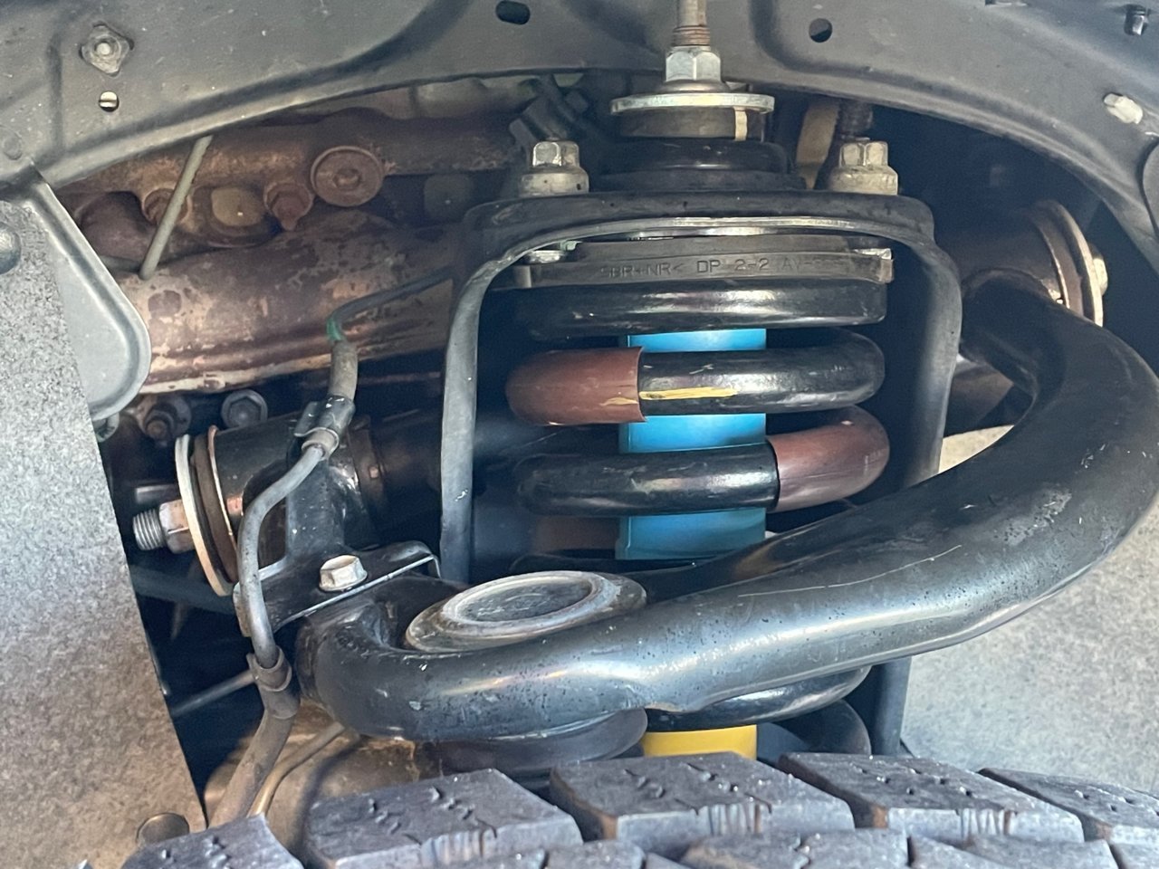

    Alright fellas, here's my result. My suspension had about 120k miles on it, and I replaced everything from truck 10 years newer with only about 5k miles.
    The following video was the most helpful in guiding this replacement: https://www.youtube.com/watch?v=C6IloGEzoJk
    Replacing the upper control arms on this truck was one of the most difficult things I have ever done. I would not do it again unless they are really shot. For the drivers side you have to disconnect a bunch of stuff including the battery just to get the damn thing free. Also, you need to grab pliers and bend back your wheel well. Passengers side is just as terrible. I used a punch and hammered it out...
    For the struts, drop your skid plate and the bolts holding your sway bar. I added 3/8" spacers and they leveled the truck out nicely. Link here: gained about 1 3/8" up front. You can see from the photos that you can fit the spacers and still have a couple threads showing above the tower.
    Read up a few posts and you will see that the new leafs did not lift the truck as previous posts have suggested - in fact I lost about 1/4" to 1/3" back there.
    Overall, same review that the previous posts had. Truck feels more planted on turns, doesn't nose dive as much when braking, and overall feels more solid and smooth over bumps. Worth it for $300 and a few hours labor.

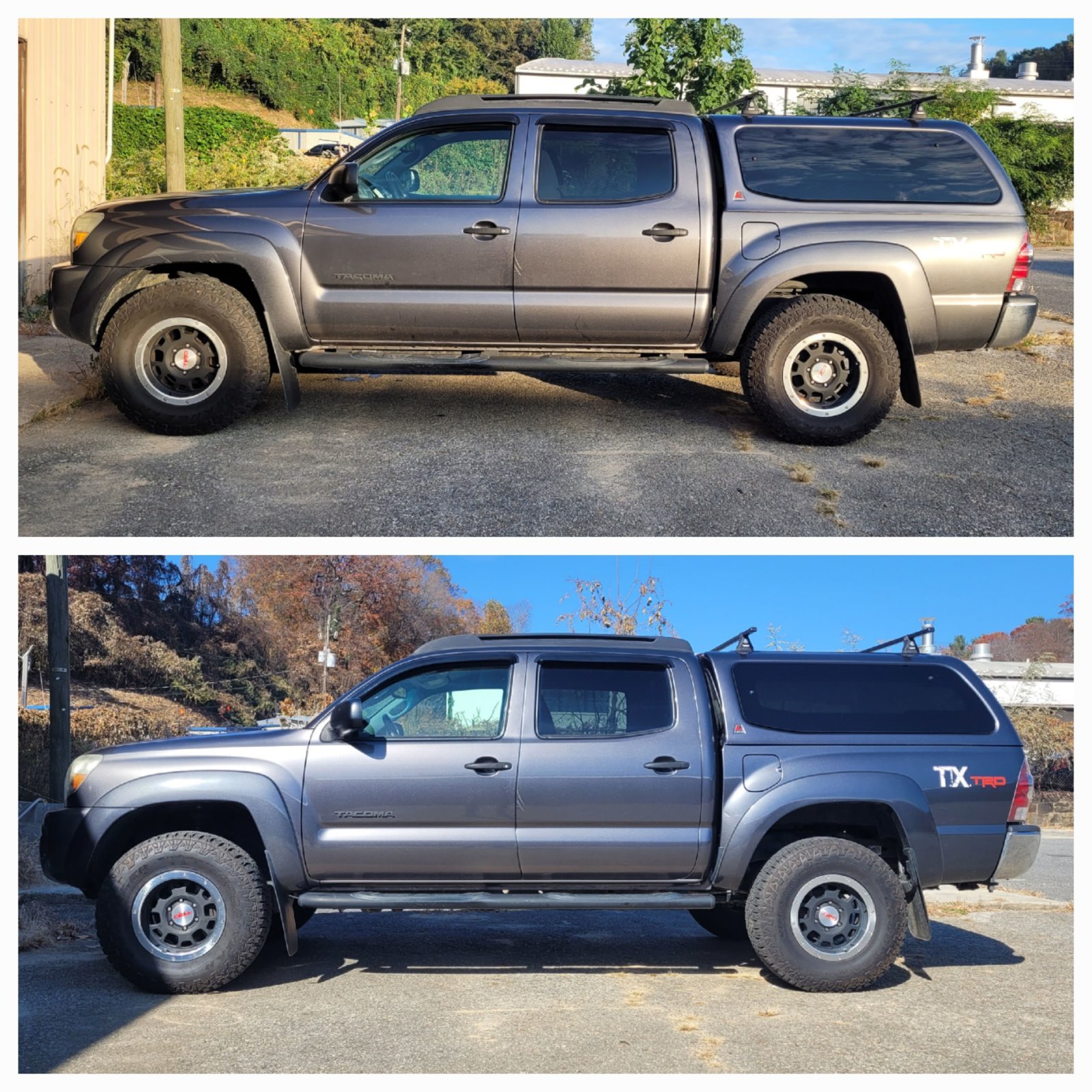

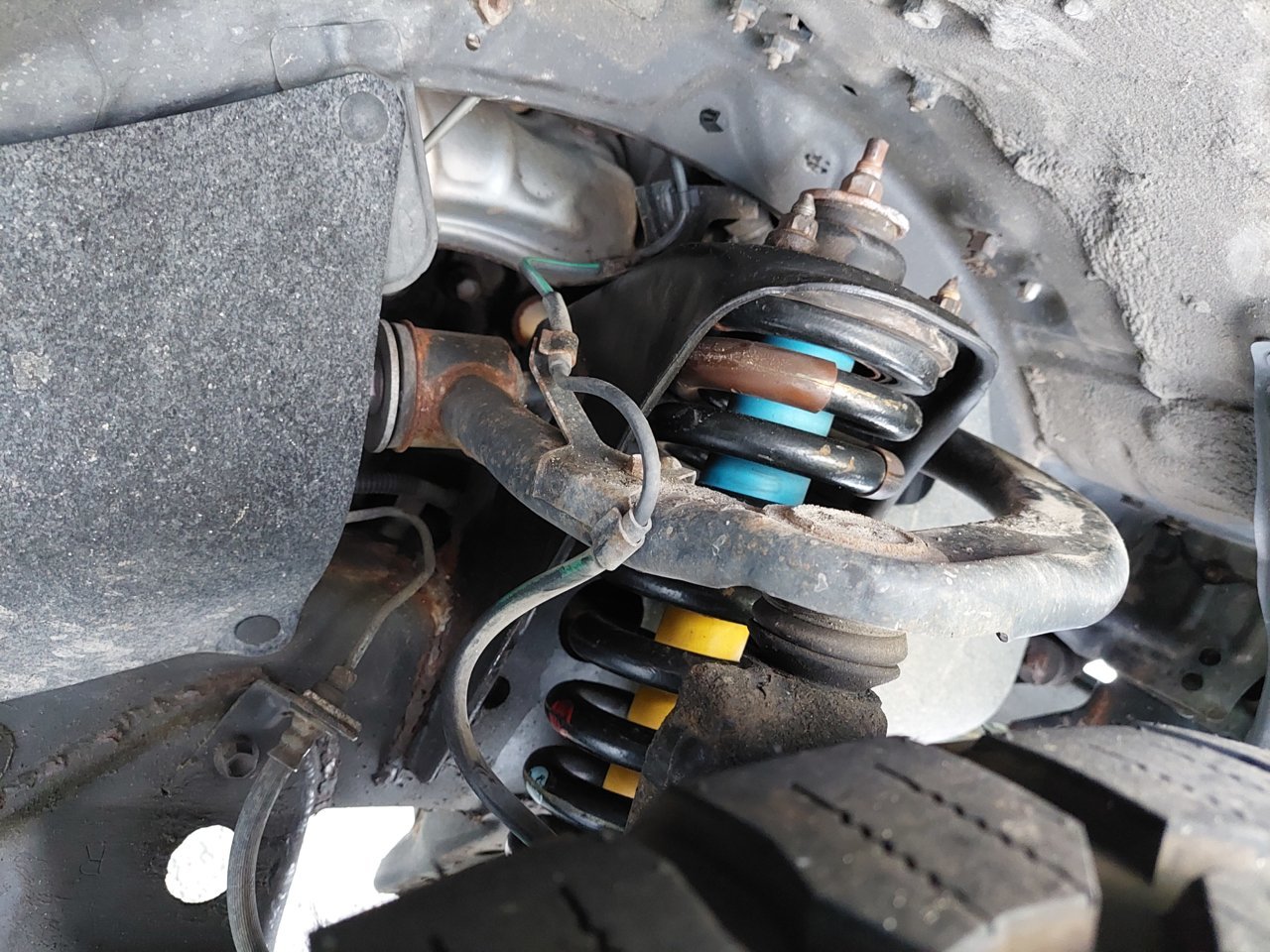

    Just to add to this thread, I was able to find a set of 2022 take offs with a few thousand miles on them to replace my 160k mile set on my 2011. The original leaf pack was replaced with the TSB pack at around 30k miles, but it flattened out pretty soon because of the constant camper/gear weight in the back.
    Prior to install I added a Torch 1.5" aal in the new 2022 leaf pack, a 1/4" Toytec spacer to correct the driver side lean, and a set of Bilstein 5100's (fronts set to 0.85 lift setting) to use with the new, stiffer, 2022 front coils.
    Hub to fender measurements before and after:
    DF 20.25 to 22.5 (2.25” gain)
    PF 20.625 to 22.5 (1.875” gain)
    DR 21.25 to 23.75 (2.5” gain)
    PR 20.875 to 23.75 (2.875” gain)
    The passenger front was almost exactly the gain expected at 1 inch from the 3rd gen coils and 0.85 inches from the 5100s, and the 1/4" spacer on the driver side evened out the front perfectly. The gain in the rear was measured after about a month of settling (it was over 3.5 inches of lift when first installed), and both sides in the back are now even.
    The ride is absolutely wonderful considering my old shocks were completely worn out and useless at 160k, but the way it drives now with less body roll in corners and nose dive under braking is the real highlight. I highly recommend this setup if you are looking for a budget friendly way to refresh your suspension and get a mild (1.5 to 2ish inch) lift.
    Before and after pictures:
