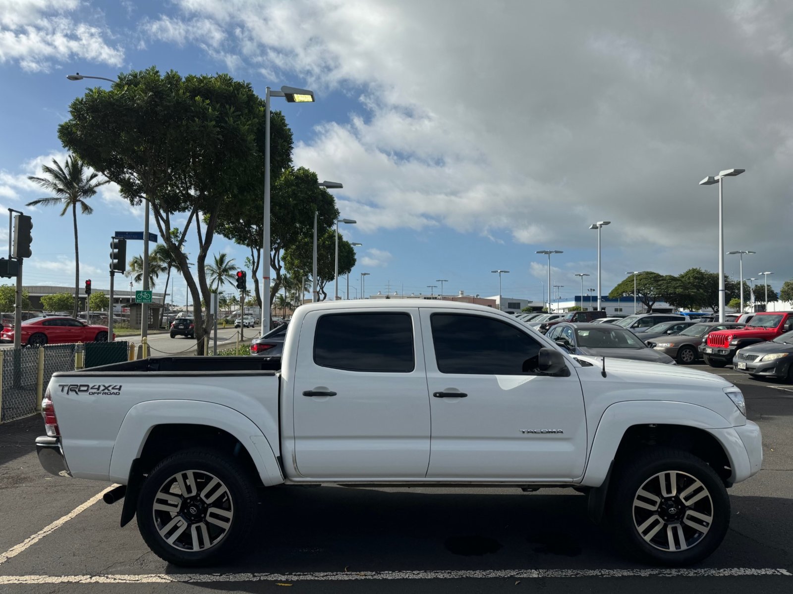

    I'm planning on getting this done this weekend. Purchased 2023 OR front strut assemblies, 1" strut hat spacer, 2" rear blocks & U-bolts. Hoping to get an even 2.5-3ish of lift.
    Here's how my truck sits currently. 2009 Dbl Cab OR 4x4 48k Miles

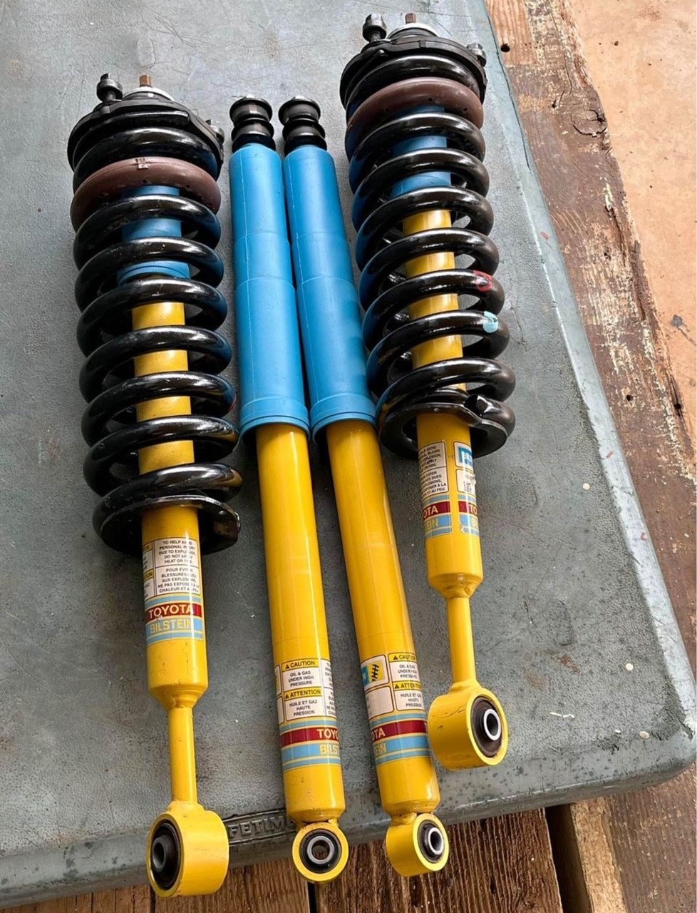

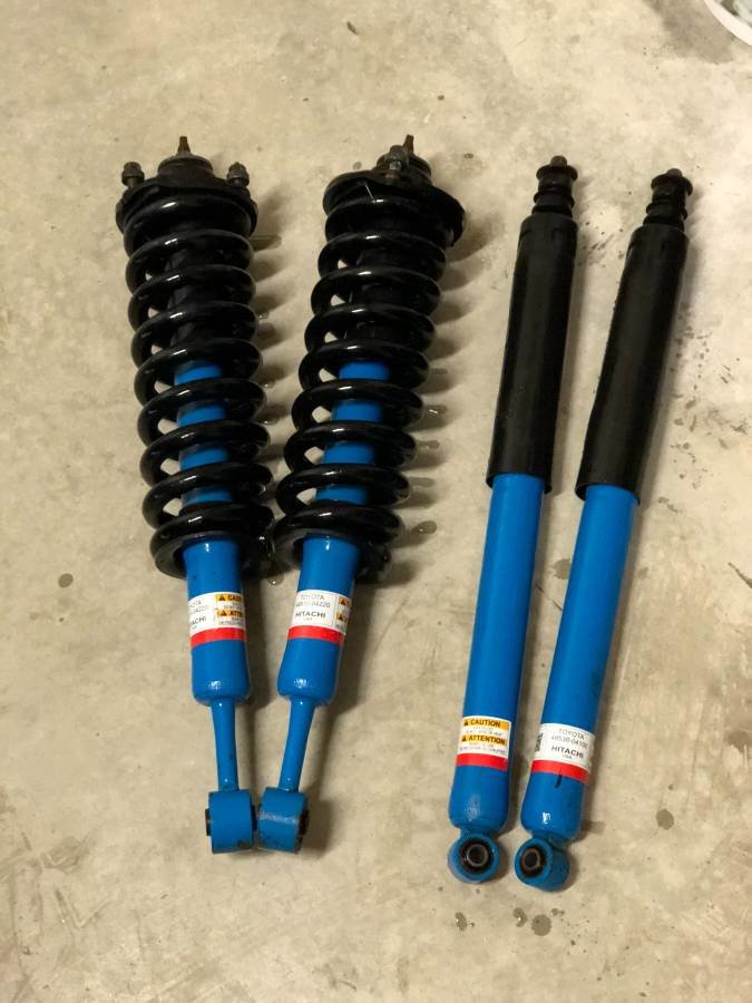

    All 3rd Gen (2016-2023) TRD Sport Tacoma's will have the all blue Hitachi front shocks. The TRD Off Road Tacoma's will have the blue and yellow Bilstein shocks.
    TRD Sport shocks:
    TRD Off Road shocks:

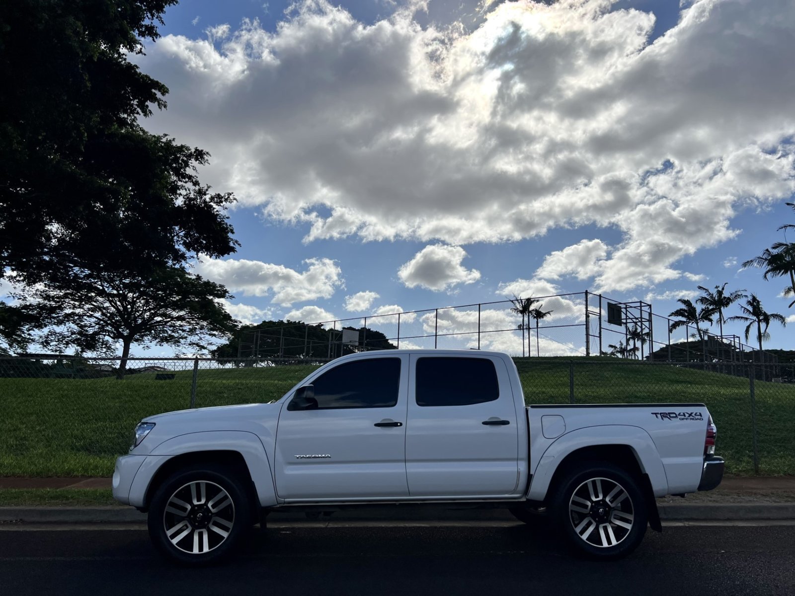

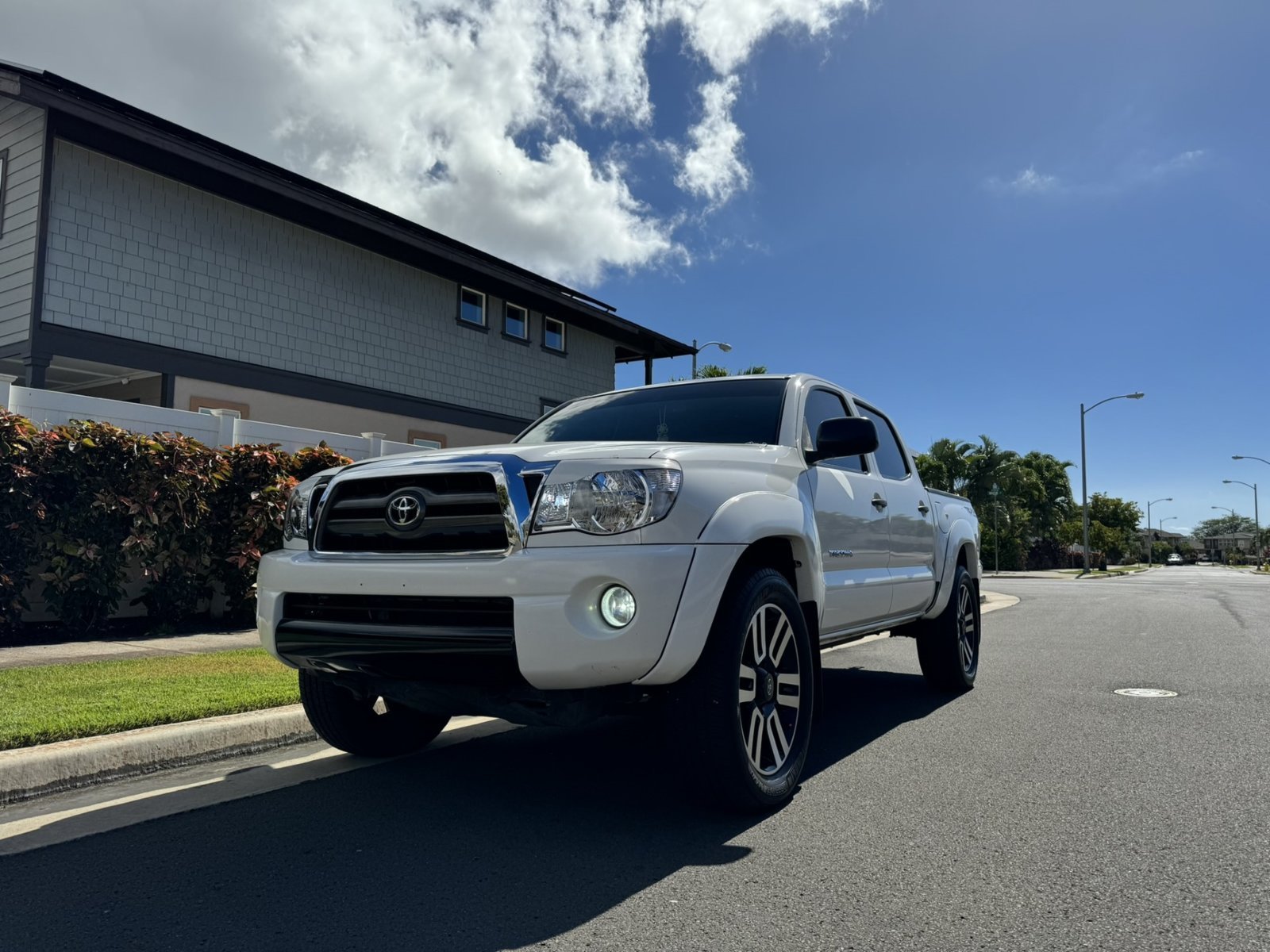

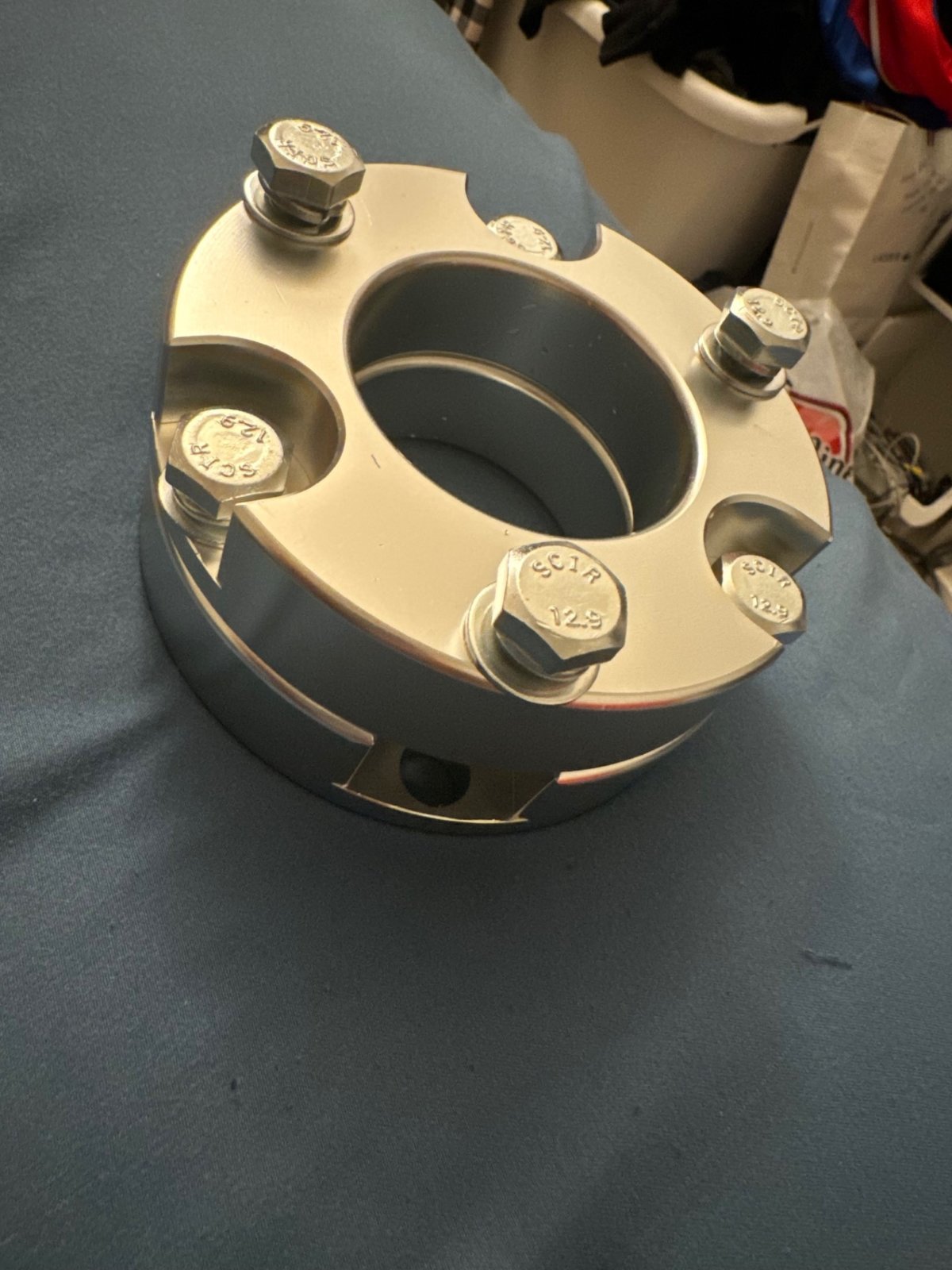

    As promised. Completed the install over the weekend. Sorry, didn't take any measurements because I knew the height was gonna be perfect for me. No sway bar relocation and no diff drop, everything seems to have clearance . We'll see how things are after alignment this Friday. Keep in mind, I usually don't go this route for a lift but I really wanted to stay budget friendly with this one.
    Parts List
    "23 Off Road struts and shocks w/ about 2000 miles on them
    KAX "2 top hat spacers https://www.amazon.com/dp/B092JCQZMD?ref=ppx_yo2ov_dt_b_product_details&th=1
    2" non tapered blocks
    U-bolts from Auto Zone
