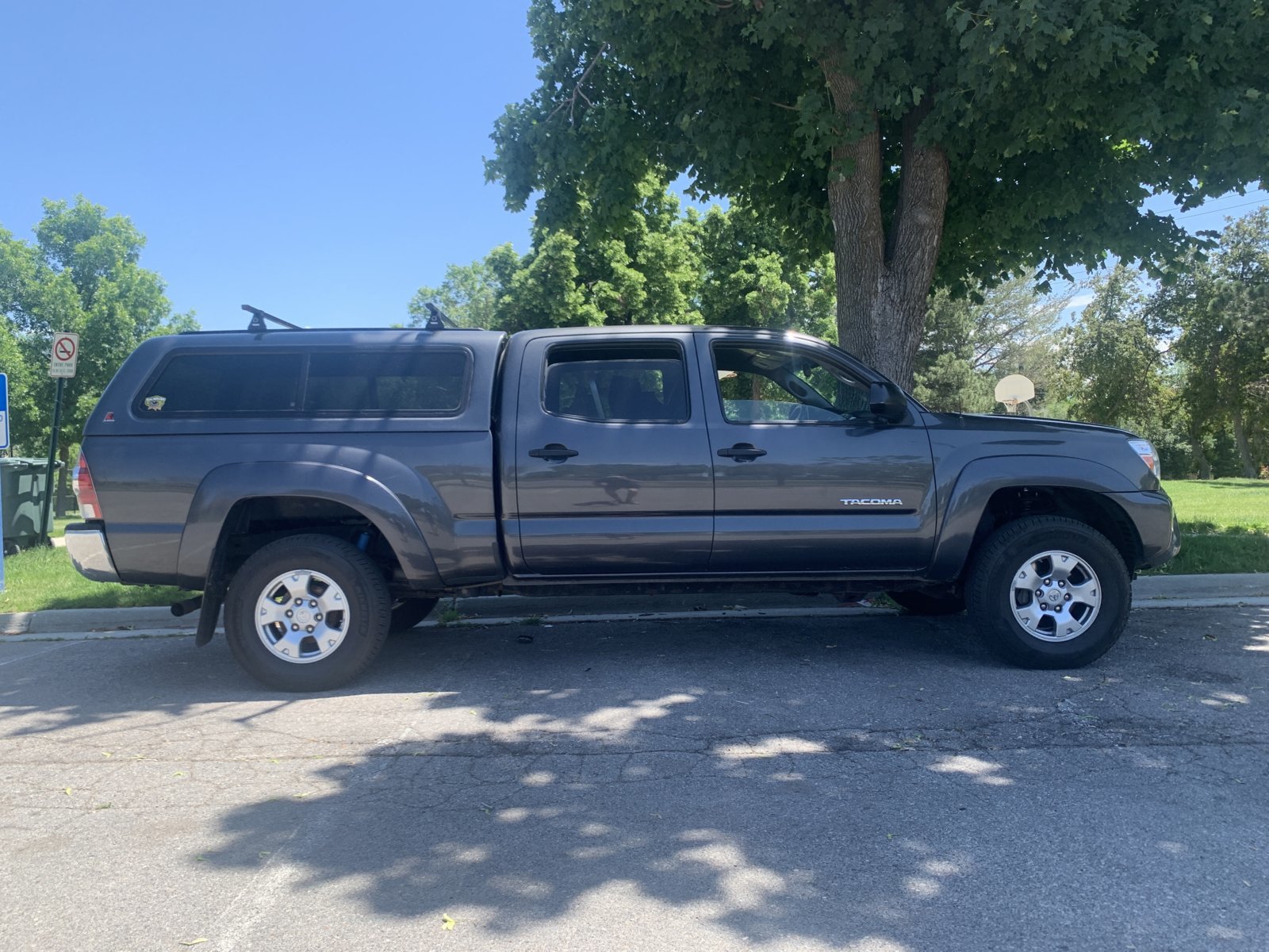

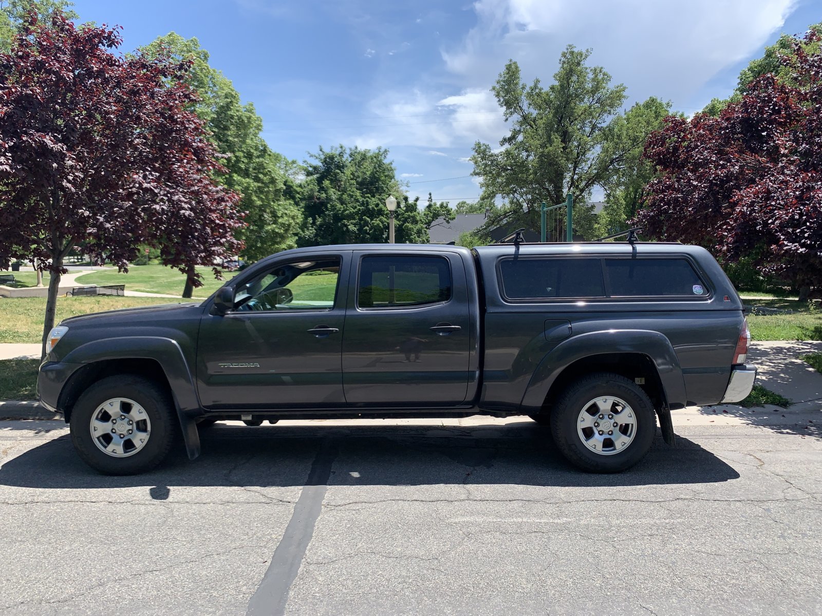

    Just finished my suspension swap and wanted to share my numbers and experience:
    2014 DCLB with cap. Just purchased the vehicle a few months ago from single owner that had the dealer do all the maintenance but never did shocks. 120k miles. Assuming cap was on the truck its whole life. Picked up the shocks and coils from a 3rd gen OR with essentially zero miles from a local company that lifts Toyotas for $250. They didn't come with top hats so those were KYB for $50 and had a local shop charge me $140 for compressing the coils and installing. Bought an Icon AAL for $200. Grand total of $650. Install took 7 hours. I had waffled with needing a spacer up front but it came out perfect and exactly how I wanted it.
    Height from center of wheel to bottom of fender flare before install:
    FD 20.25"
    FP 20.25"
    RD 21.25"
    RP 21.25"
    After install:
    FD 21.25"
    FP 21.25"
    RD 22.75"
    RP 23.25"
    So basically the new 3rd gen OR shocks and coils gave me 1 inch in front and the new shocks and Icon AAL together gave me 1.5 inches in the back, putting me back at factory rake of just about 2 inches. I'll be loading it up with a ton of camping gear and a couple friends next week for a river trip so it will be interesting to see how it settles in. And yes, the Bilstein shocks ride great! (And also got rid of a clunking noise in the front).
    Thanks to the OP and everyone else who recommended this cheapish mod! Couldn't be more pleased!
