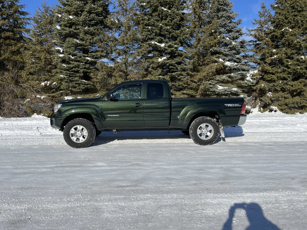

    2018 TRD-OR front struts on with 1/4" thick taco lean spacer on driver's side. Still have OG pre-TSB two leaf springs out back that I hope to have swapped out for 3G springs this weekend (and have 1/2" Trail Edition spacers on hand in case it doesn't yield any lift; seems to have a bit of negative rake). Didn't measure how much lift I got; but it was on aftermarket struts anyway so not really that relevant anyway. CV was at a bit of a negative angle before, and now it's about that much "positive" by my eyeball-o-meter. Wound up exactly where I wanted it I think, a bit more yet not obviously lifted.

    I seem to recall people's outcome varying. I swear I took pics of before measurements but can't find them, but as I recall I actually only wound up with less than an inch, and then still wound up with not quite an inch with a '17 Pro setup - I was worried it would be too tall, but it was only about 1/4 or so more than the OR setup. And this is on a lighter ACLB as well (although the FJ AWD conversion weight gain may negate that; not sure what that delta actually is though).
    Since I did really like the ride of the '17 Pros, I have '23 Pro takeoffs inbound as a last ditch effort to get an OEM "it's not lifted!" lift to better match my 3G Trail Edition setup out back.

    '23 Pro setup puts me about where I was with the '17 Pro setup with 10mm tophat spacers (home made). I am quite unfortunately still sporting some noticeable lean, so will be popping in a 6.5mm spacer and calling it good.
    Also - I know this isn't supposed to be true, but while I am busting myths, I also have UCA on coil contact at full droop with the stock stamped arms and the '23 Pro struts. Liking the amount of lift as well as the ride, I wrestled with this a lot regarding the Pro UCA or aftermarket arms; but decided I wanted to stay OEM and ponied up for those (thankfully, found takeoffs at least).
