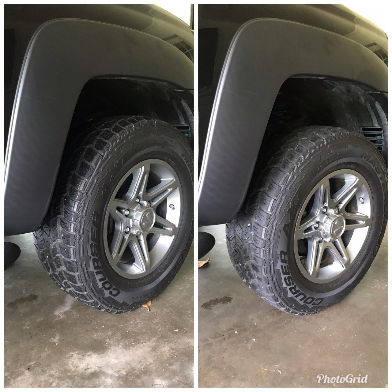

    I got a chance to do my front today.
    @OhDannyBoy
    My net lift was 1-1/4” driver and 1-1/8” passenger sides. I used a 1/4” lean spacer on the driver side, too. I measured from ground in the same spot of my carport; the tape measure was held against tire at bottom and leveled at the middle of center caps. This was the most accurate I can get by doing this. Here are my measurements:
    Before:
    34-1/4 34-1/2
    35-3/4 36
    After:
    35-1/2 35-5/8
    36 36
    Overall, I’m happy with how close everything is compared to before. Here is a before and after picture from the same spot right where I jacked it up.
