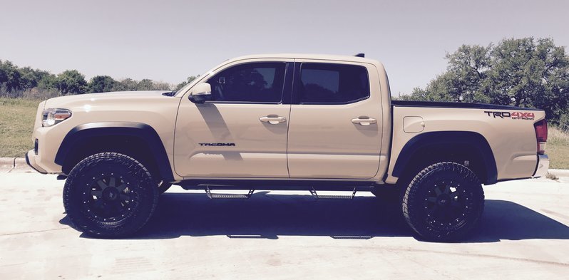

    Rake looks too high in front for my tastes but What is this combo?
  9. Mar 31, 2017 at 11:43 AM
    #69
    Tx_Taco
    Tx_Taco Well-Known Member
    Jan 26, 2016
    #176131
    153
    Rick
    17 TRD OFF-ROAD 4x4
    Bilstein 5100s OME 888 springs adds leaf in the rear. Just installed yesterday so it'll settle after a while. Should level out

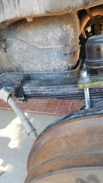

    Your axle off center? If you didn't tighten the ubolts equally it can throw it off

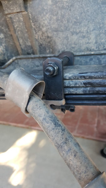

    What did you do with the bracket that bolts to the overload spring? I zip tied it up for now but I think I need to remove it

    Took it out. You mean the one attached to the bottom of the O/L leaf? Take a photo and show us
    Or are you talking about the brake line bracket

    Brake line bracket that bolts to the leaf.

    Oh! :laugh: This has been the subject of much debate. I zip tied it to one of the leaf brackets. You don't want that line to get kinked.
    @GPsevinSixx really deserves the credit here by the way.
    He taught me a ton. Here are pics. Not sure this is the best method or not but it seems to put it back close enough to where it was from factory, location-wise. Definitely need to keep an eye on it.

    Make sure not to kink the cable during the install. You may end up having to flip the silver bracket to attach it to the clamp. ICON guys told me they just bolt it right back up to the clamp bolt, which will cause it to kink badly. This will actually put strain on the inside cable and take up slack causing dragging of your rear brake shoes, and if your parking brake isn't properly adjusted, you'll end up with stuck or glazed brake shoes! While a zip tie isn't the best way to do it, it will work for awhile. I may end up fabricating a bracket or extension later to reattach if the zip tie fails prematurely on mine.
    Those guys lost credibility with me after telling me to do that after giving them a call over the phone. They say they have never had an issue doing it this way.... LOL
