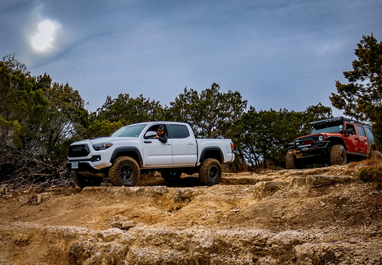

    I have this kit with the aal on my pro. Initially got a lot of crap about it until people realized that the fox suspension is way more beefy than the bilsteins which break with spacers. Do some extended bump stops with it and you'll never have any issues. Ride quality to me is great! The look is perfect in my opinion and the best option until I can save up for the kings setup down the road. I also wasn't ready to ditch those awesome Fox's just yet.
    P.s I wheel mine pretty damn hard so speaking from some real world experience. LRM_EXPORT_207405624968036_20181229_222237624.jpg
    https://www.tacomaworld.com/threads/hidden-falls-pics-trd-pro-and-t4r.584750/
