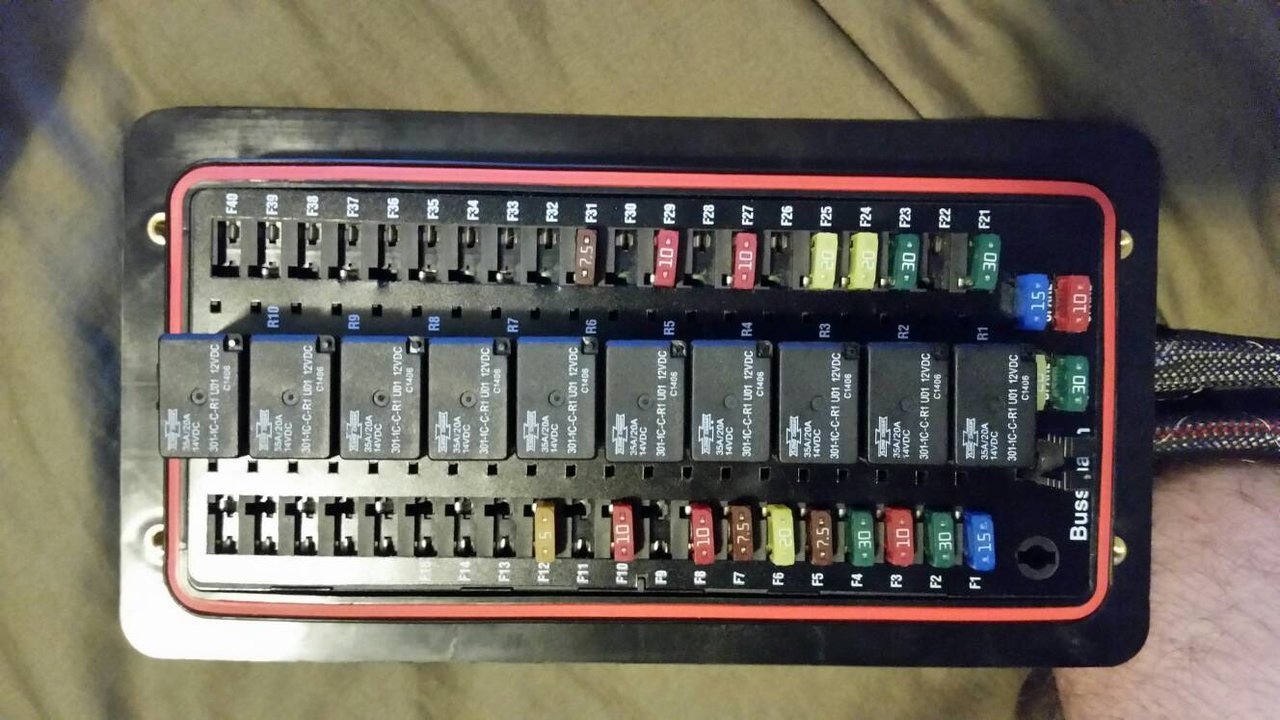

    Anyone still around with one of these?
    My box has been working great, but I've only been using 1/2 of it. I need to finish wiring my accessories through the box.
    Does anyone know what connectors/parts I need to take advantage of the unused fuses/slots in the box?

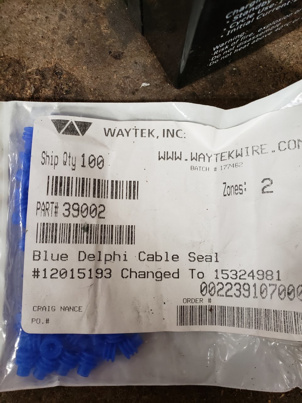

    Are you looking for the part numbers of the pins and all the little parts?
    I have some of them still in the original bags.

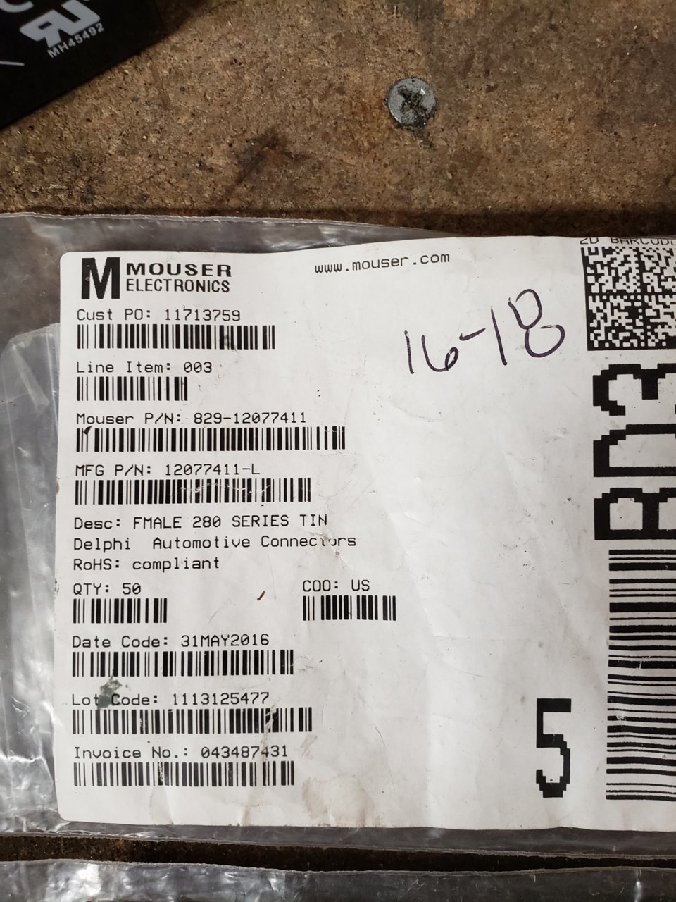

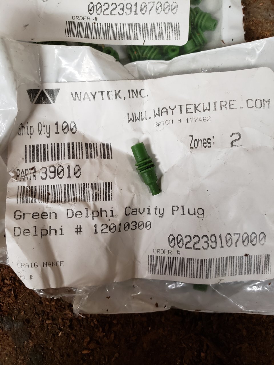

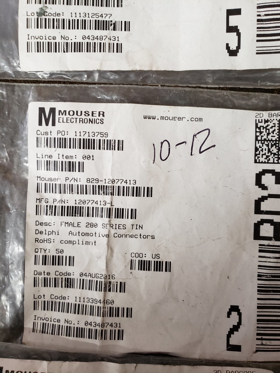

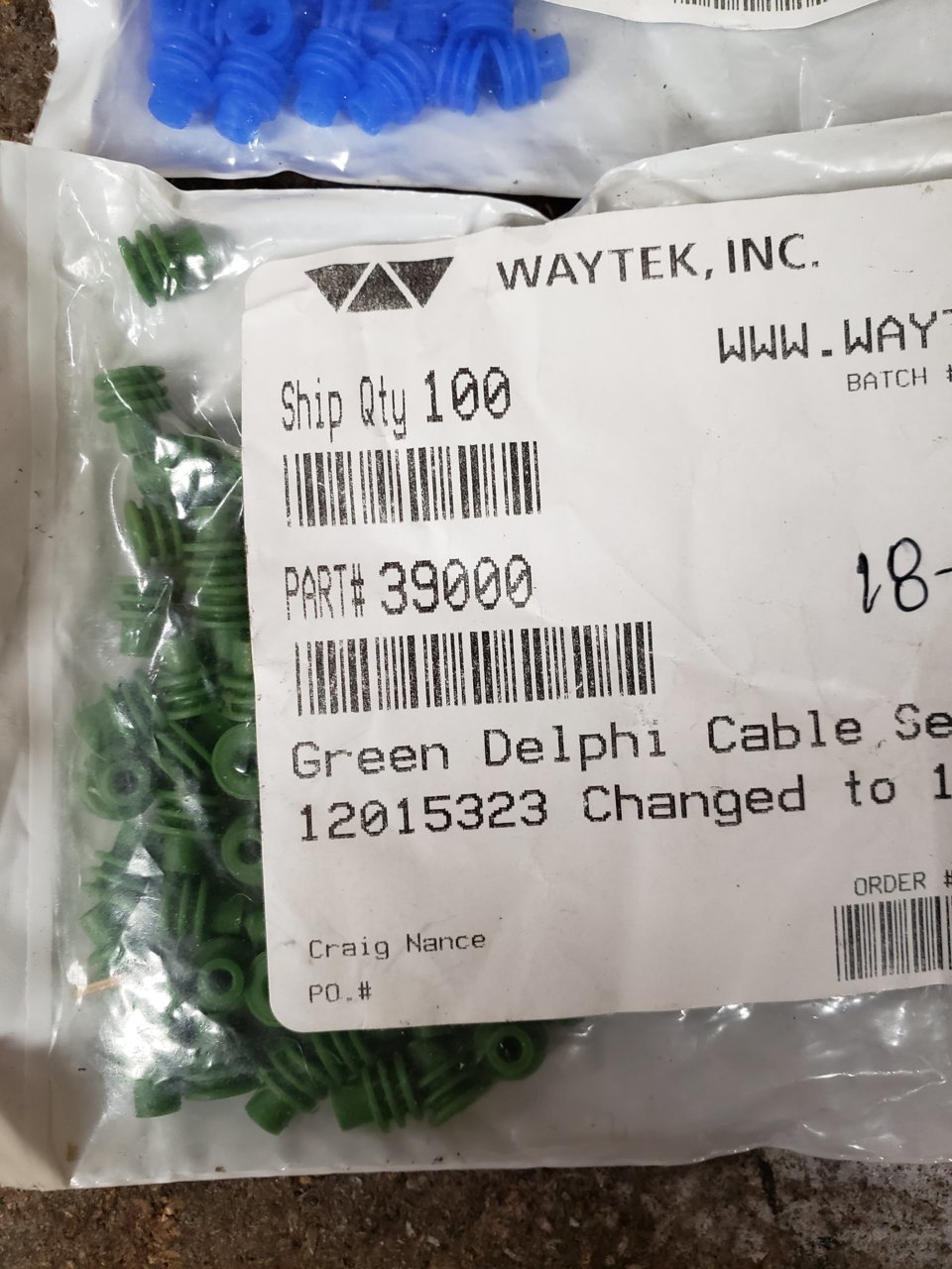

    The 5 box that I have are tangless and the 10 has tangs on them. This is what I have.
    20200612_202147.jpg 20200612_202156.jpg 20200612_202134.jpg 20200612_202115.jpg 20200612_202120.jpg 20200612_202127.jpg
