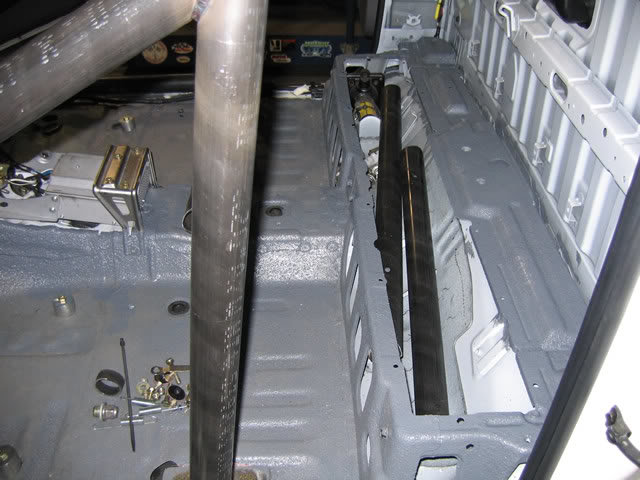

    anyone rhino lined ( or herculined , any truck bed coating ) the interior of there tacoma? if so please post some pics..
    the passenger floorboard of my truck is always gettin wet and the carpet is nasty anyways so im thinking of ripping it out and rhino lining it.. let me know how you like it if you have done it ...

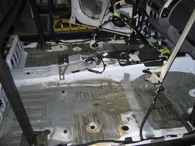

    immediate problems id see is the floor is not a flat surface, its probably corrugated and has plenty of indentations and raised portions. itd look crappy if it was exposed.
    washing it out would be bad because theres still plenty of electronics in the cab that are not water friendly. the carpet is pretty think (with padding) so thered be a gap from the bottom of the plastics to the new floor. insulation would also be a problem and the floor would get exceptionally hot or cold and the cab wouldnt retain its temperature as well. also, im sure theres wires and stuff that would have to be extended and moved so they didnt run in a heavy traffic area.
    bottom line, probably nor your best move. buy some walmart floor mats for $15 and save the hassle

    Removing the crap under the carpet is a pain. It'll take you some time but it's worth it.

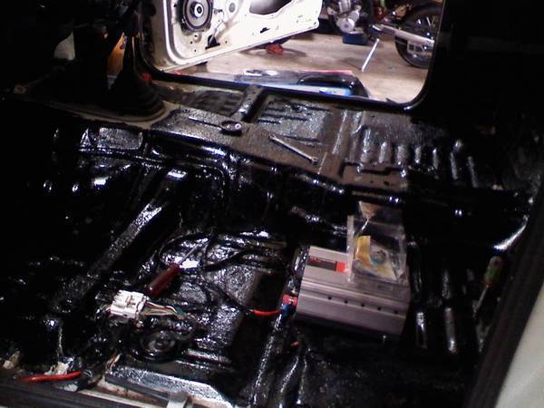

    mjp2 what coating did you use and how is it holding up?
    it looks good and did u just roll/brush it on ?

    Durabak, and it's holding up well inside the truck. I only used a thin coat to protect the metal but it could obviously be applied thicker for more sound deadening. It's a roll-on solution available in a ton of different colors with UV protectants.

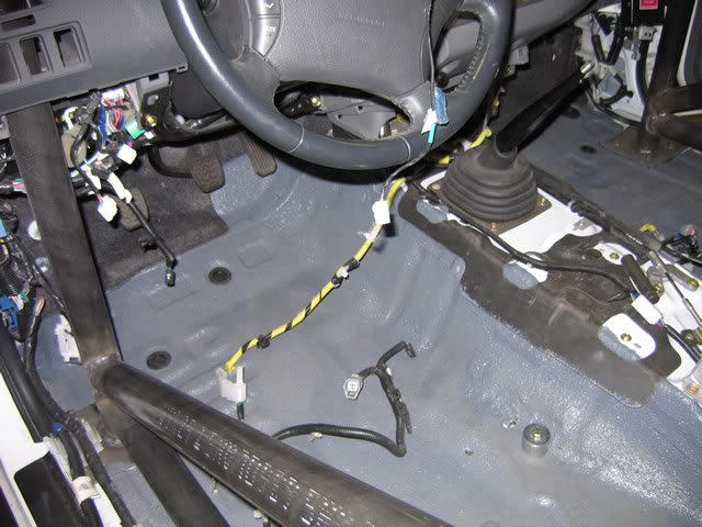

    i did it about 2 months ago

    thats some shinnnny stuff what did u use?

    3 things to think about.
    The floor pan is 2 pieces. There are tons of gaps that will collect dirt and crap over time if you do not fill them up with something.
    Plenty of exposed wires to shield/protect.
    Number one. Road Noise!
    I too have thought about doing something similar. The route i am taking is to spray some light adheasive to hold down a sheet of plastic. Then use a can of foam insulation to fill the voids in the flood for a smooth finish and then a few coats of truck bed liner. Using the plastic on the bottom will still allow me to peel up the sides if I need to get to any wiring.

    I used the hecuiner! i think the reason it looks so shiny is beacuse of it was freshly rolled on and also the way the light was hitting it.
