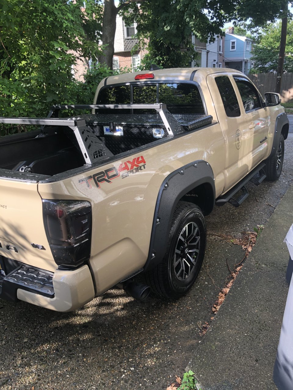

    Hi friends. Does any one have a pictures of ridge grapplers or any Beefy all terrain tire on stock trd sport rims? I’m the proud owner of a 2020 trd sport and I want to keep the rims. Also would anyone know the biggest tire size I could put on these 17” rims without any rubbing or should I just play it safe and put the same 265/65r17? Thanks for any input

    255/70R17 is the largest diameter, but it's "skinny" 265/70R17 is the largest "balanced" proportion tire you can fit.

    The 255 is a 33", usually the only way to get a 33 without a CMC.
