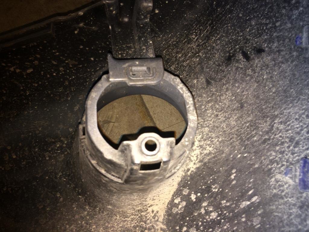

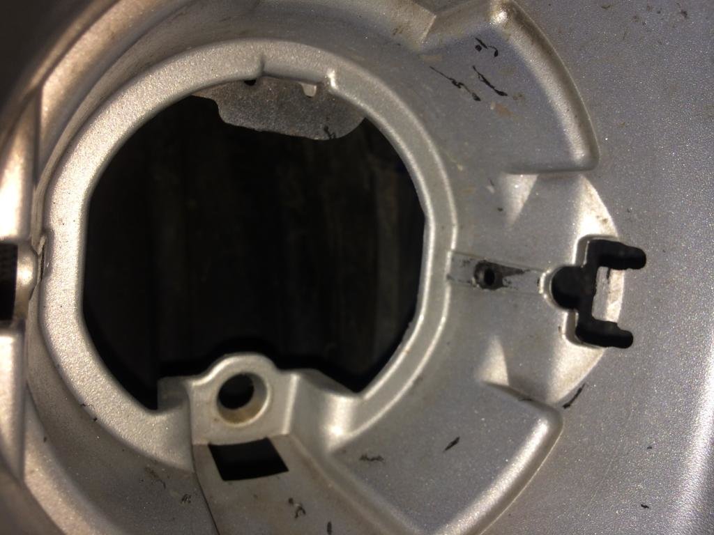

    This is what the fog light hole looks like when empty, if you didn't already know.

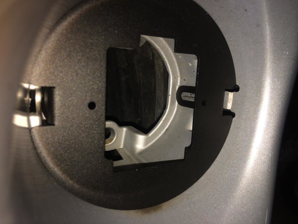

    This is the bracket that comes in the kit just slid in there to check the fitting. It is nice and tight so that is good.
    The holes on either side of the housing do not hinder the sliding in but offer no mounting options or help. Time to get creative.

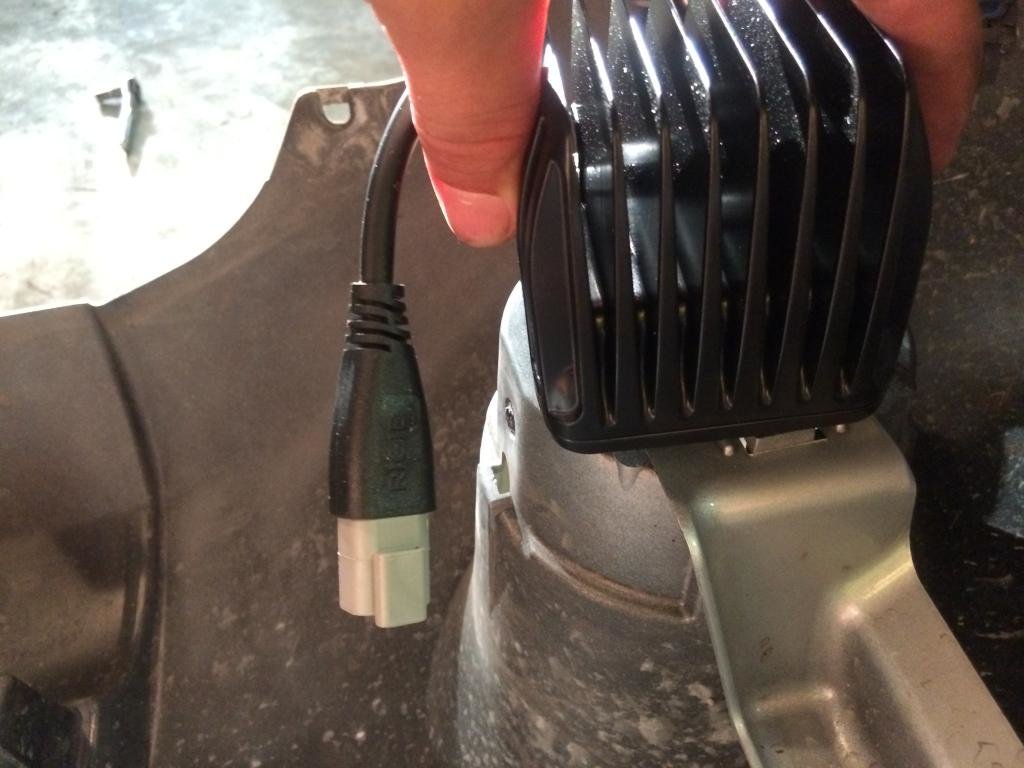

    As you may or may not know, the duallys mount to the bracket from the back side using the 2 center screws and 2 small washers. With the bracket mounted and bolted in, you can't get the light in the hole from the back, it is too big. On the other hand, you can't preassemble the light to the bracket because you will then not be able to get the bolt in to mount the bracket. Bracket first then light in through the back is the ONLY way to do this. This is where I took the bumper off to get a firm grasp of the situation at hand. Also time to realize that there was no going back once I get started on modifying.
    The plastic support and clip here are in the way on the top part of the housing.
    The adjustment screw hole for the stock light is in the way on the bottom.

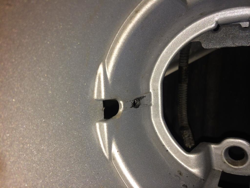

    No going back now, get the dremel out.
    Hole before:
    Hole after, but the other side since I had already done that one. Also mocked up the bracket in there.

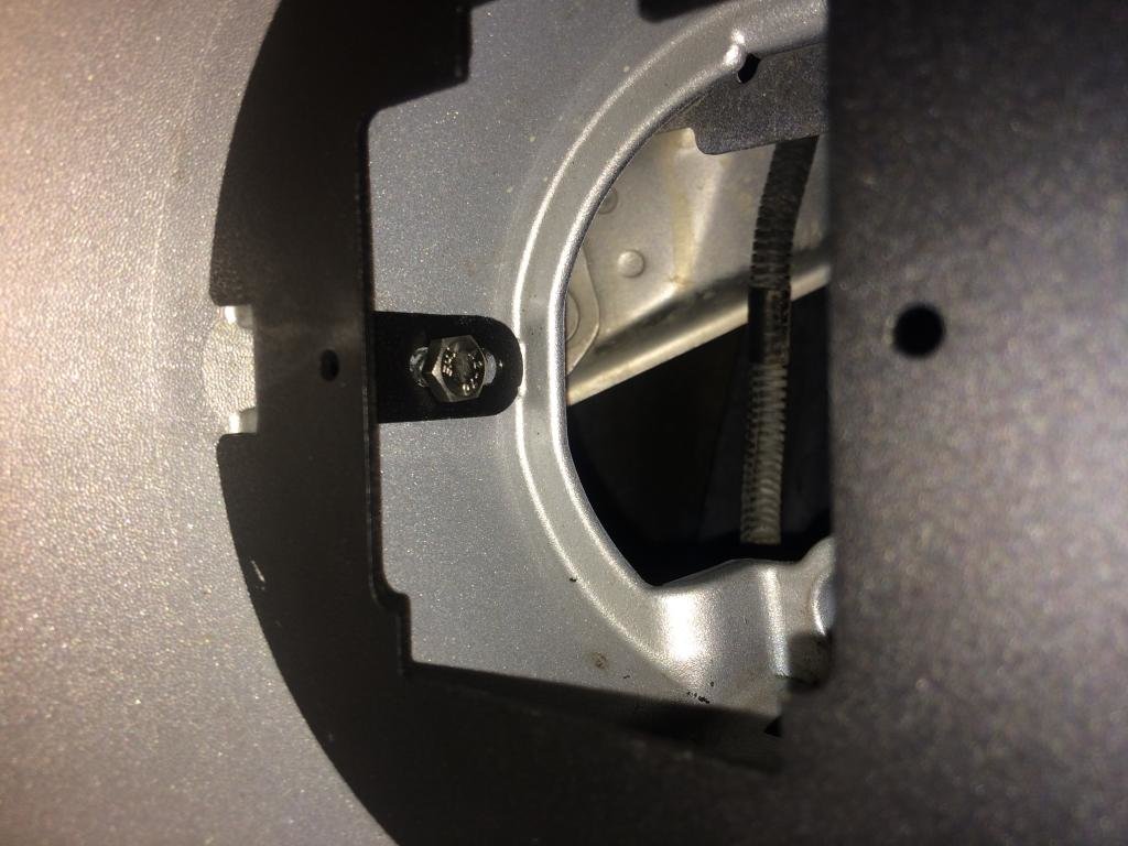

    It doesn't have to be pretty since the mount bracket will sit flush in the hole and hide everything behind. Now the light will slide in and we are able to mount it up.
    This is where I noticed another problem. The kit comes with a small bolt, small washer and a nut. When you tighten it down, since you are only bolting to plastic, it wants to pull through. Off to home depot for some better hardware. I picked up a same size bolt only longer with a new small washer and bigger washer for each bolt. So from inside out it goes: bolt with small washer into the bracket on the inside then big washer, small washer and I decided to get some Nyloc nuts for peace of mind. I don't actually have any pictures of that but use your imagination.
    Here is the final product:

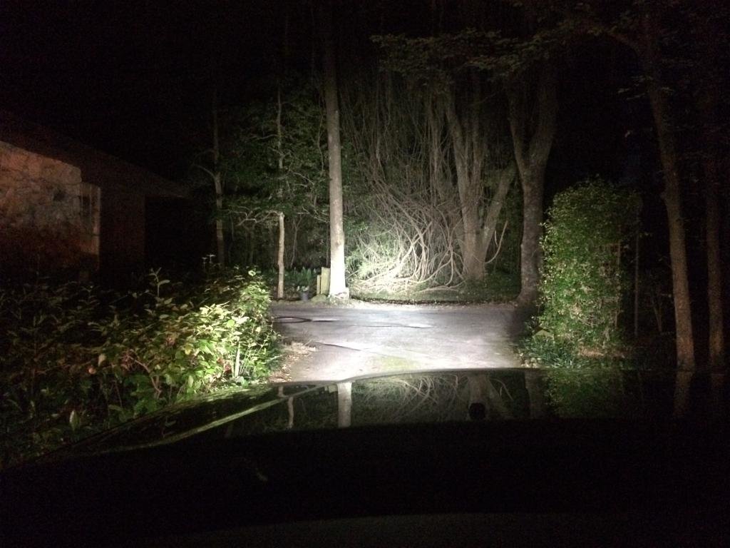

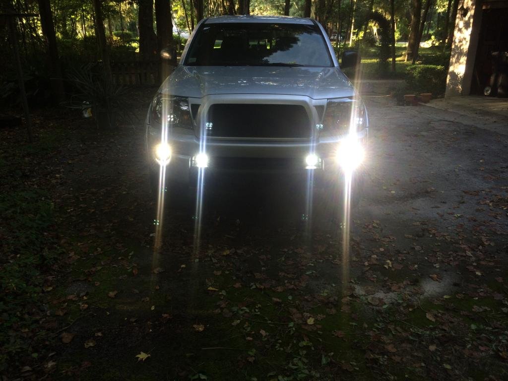

    So I got the wiring done this afternoon, couldn't have been easier. I used the plugs in the harness for the Rigids and cut the wires about 10 inches after that and attached them to the factory fog light wires with some butt connectors, then electrical tape.
    FYI: Green is power and White with black stripe is negative.
    Here are some pictures but they don't do justice. For the night pictures, the trees are about 40 feet away give or take.
    Flood lights only (and dtrl's)
    Floods and Spots (and dtrl's)
    Floods, Spots and low beams
    Floods, Spots and high beams
