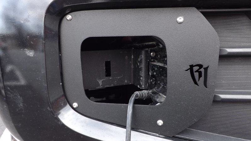

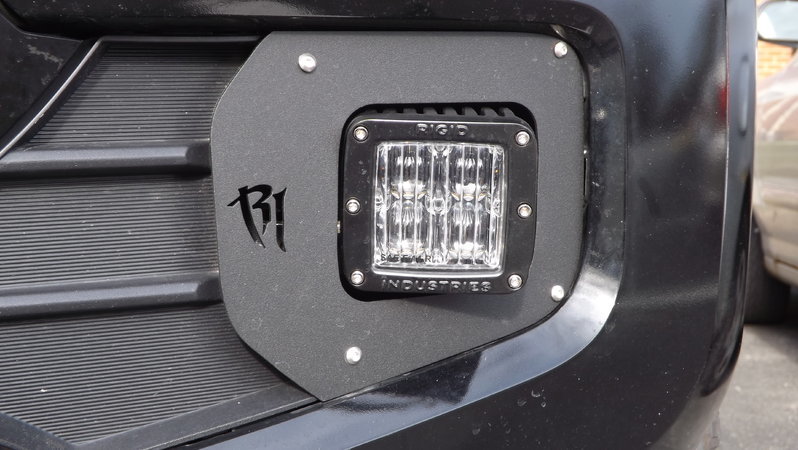

    I received this kit for Christmas. At that time it was $229. These are SAE and street legal.
    https://www.amazon.com/gp/product/B01H81SHX0/ref=od_aui_detailpages00?ie=UTF8&psc=1
    The instructions are kind of sparse, but if you look at the parts it is not hard to figure out.
    1.) Remove the bezels or bezel blanks by releasing the tabs on the back side of the bezel.
    2). Hold the flat plate against the opening and mark and drill the 4 13/64" holes.
    3). Slide the long flat brackets into the tab slots. Secure from the front with 2 1/2" screws through the tabs. Install one more 1/2" screw from behind the plate into the screw boss.
    4). Secure the flat front trim using the 8-32 screws and washers into the previously drilled holes.
    5). Assemble the bracket to the light. Secure using the bolt to the mounting bracket after attaching the wiring harness.
    This shows the mounting bracket inserted into the factory tab slots.
    Finished product
