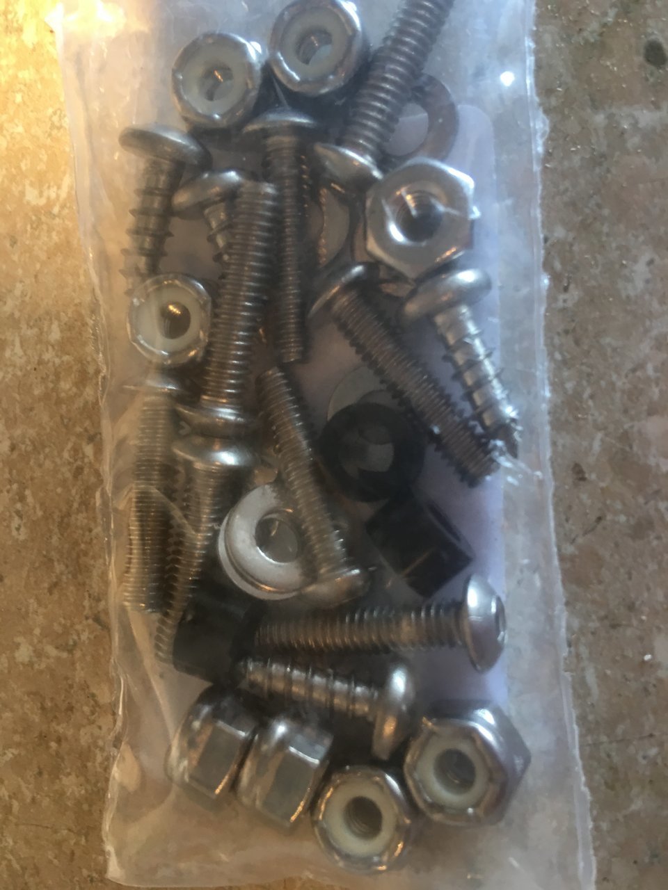

    Only 3 black spacers in the parts bag! Shouldn’t there be 8? Waiting for a call back from Ridged.

    No you don't need 8, the spacers are just for the holes where the plastic and plate aren't flush with each other. I think I only used two per side. I can't remember exactly.

    There was one frustrating part.... which led to the redo... but i can't remember offhand exactly which part. You use 2 screws instead of bolts to mount an adapter to part of the truck that is plastic. I found this connection super weak, and my light came completely loose a few weeks later. I went back in and used small blots and all is fine.. At work, so sorry i don't have the exact install point.

    Just got off the phone with a woman from Ridged, she said the black spacer goes on the L-Bracket, and the 3rd on was an extra, but she wasn’t sure because she wasn’t able to pull up the PDF File on her computer. Still waiting to hear back from them. Tick tic on a Friday!

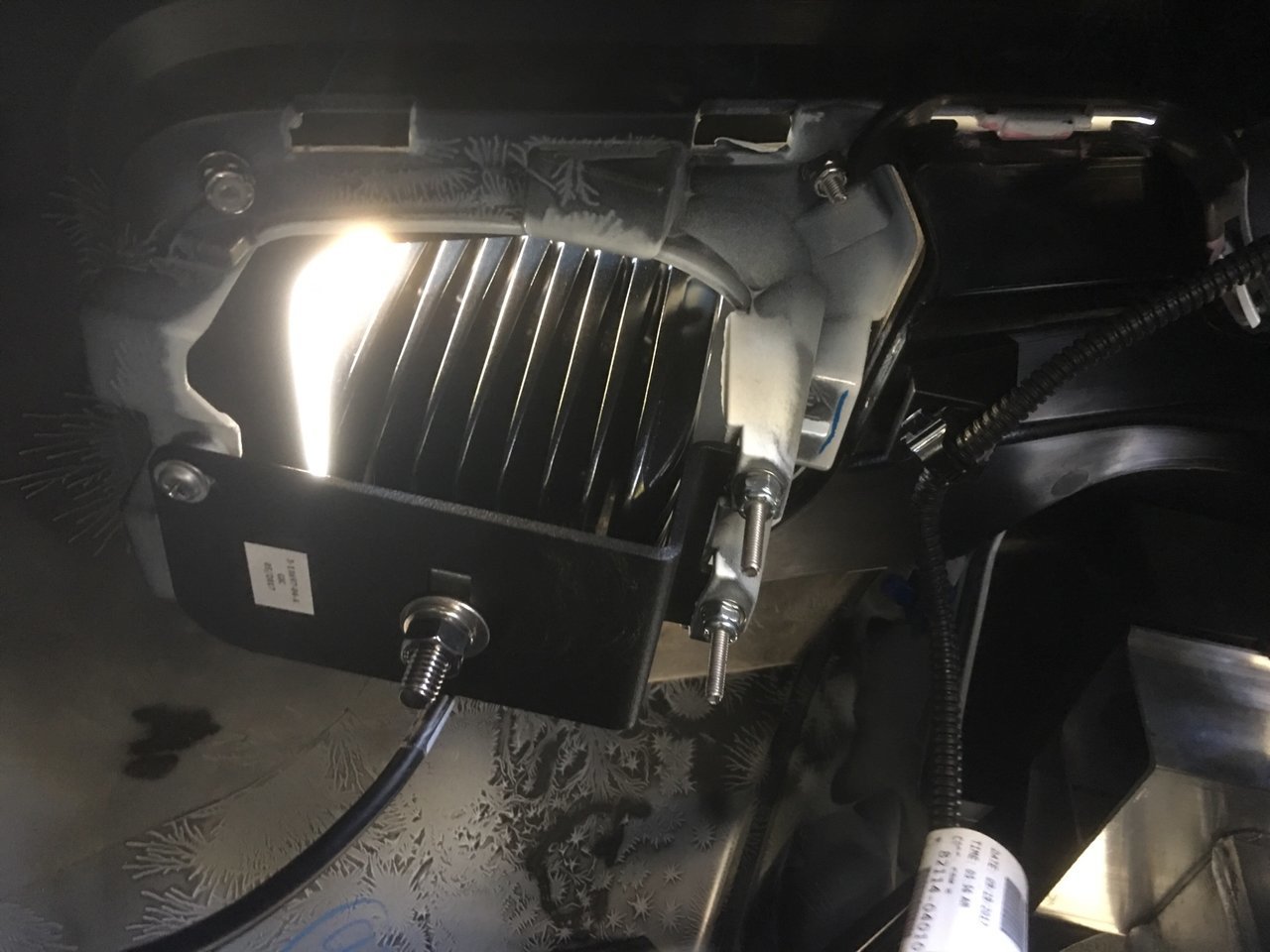

    Start on the drivers side first, there’s more room from the top down, and when you do the passenger side you’ll have a better understanding of the install process, but it is tighter on that side. When you back that one screw out on the OEM fog light make sure to use your fingers to back it the rest of the way out because it will be a bitch to get it out if you drop it. I used 1 1/4” #8 machine screws. They were too long, but it helped to feel where they were by hand. I wouldn’t go any less than 3/4”! I would definitely use machine screws becauselike Old Man said his lights were loose after a week with just the screws!

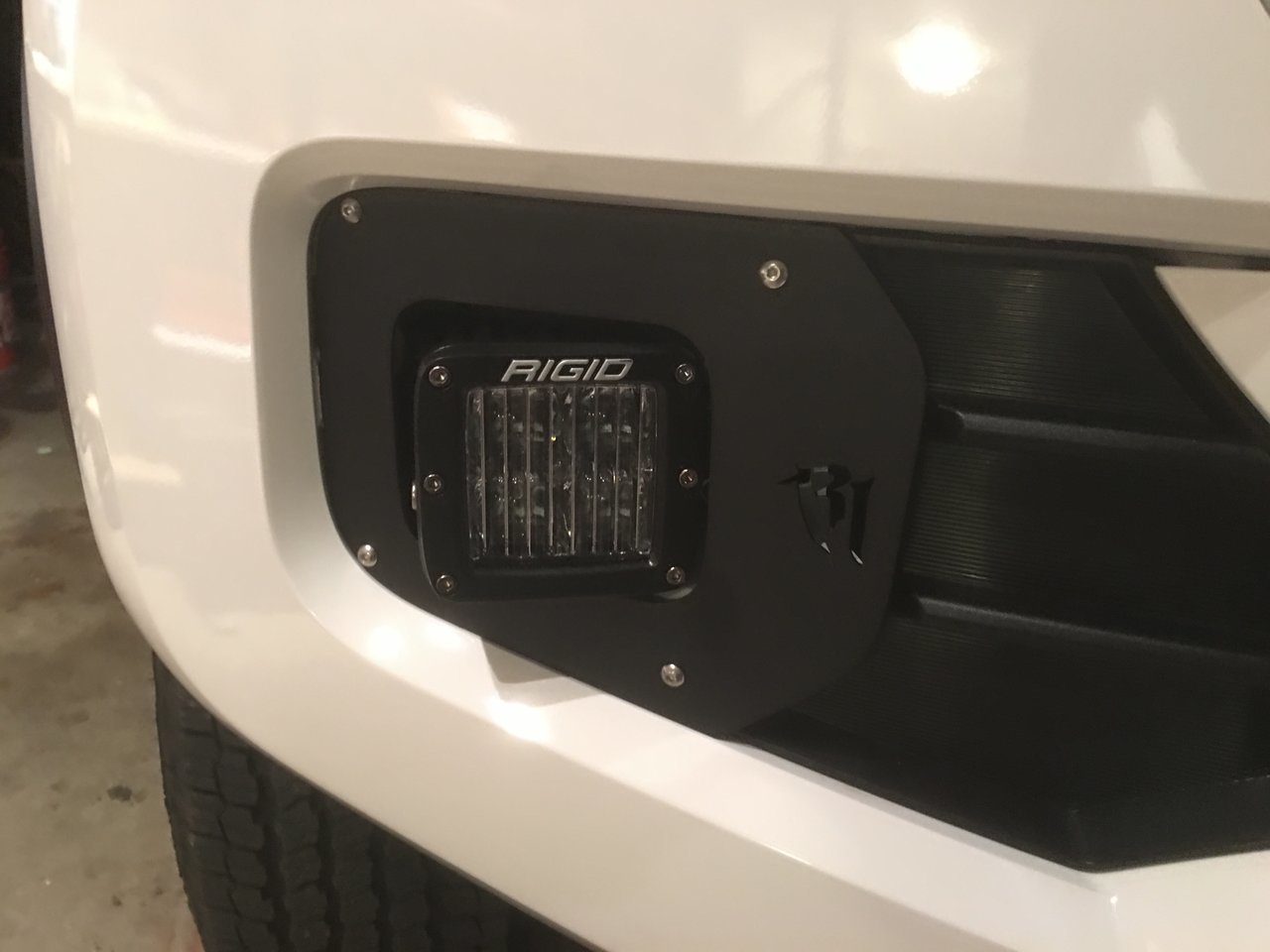

  12. Jan 20, 2018 at 1:43 PM
    #52
    SanPedroTacoLover
    SanPedroTacoLover Well-Known Member
    Dec 3, 2017
    #237556
    71
    2017 White Tacoma TRD-Off Road Double Cab
    View from behind.

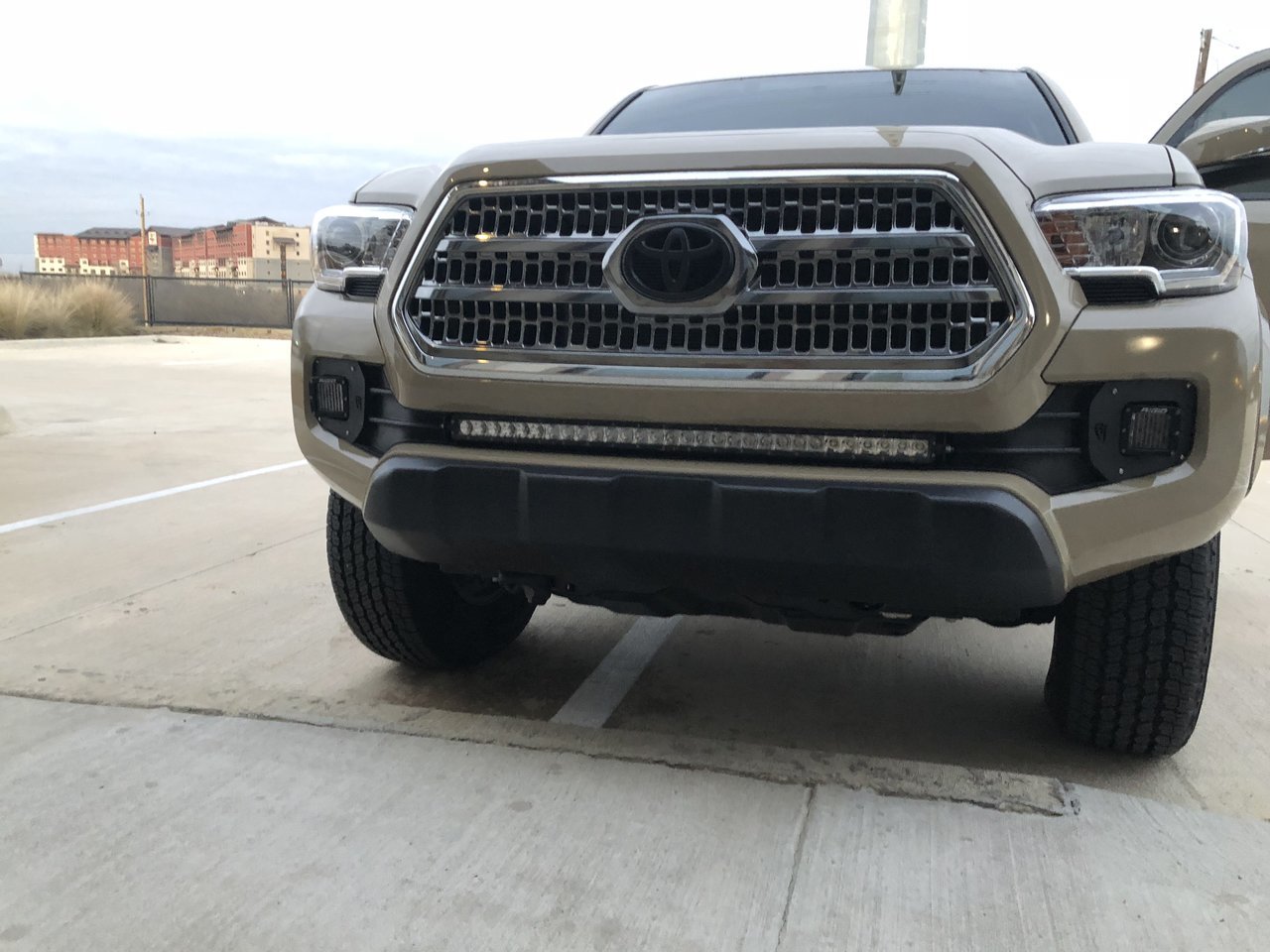

  14. Jan 22, 2018 at 7:06 AM
    #54
    Tacoaric
    Tacoaric Well-Known Member
    Nov 21, 2017
    #236579
    3,298
    Dallas, Texas
    King Ranch F250 Powerstroke
    installed mine last week finally.
    Kopasz and SanPedroTacoLover like this.
