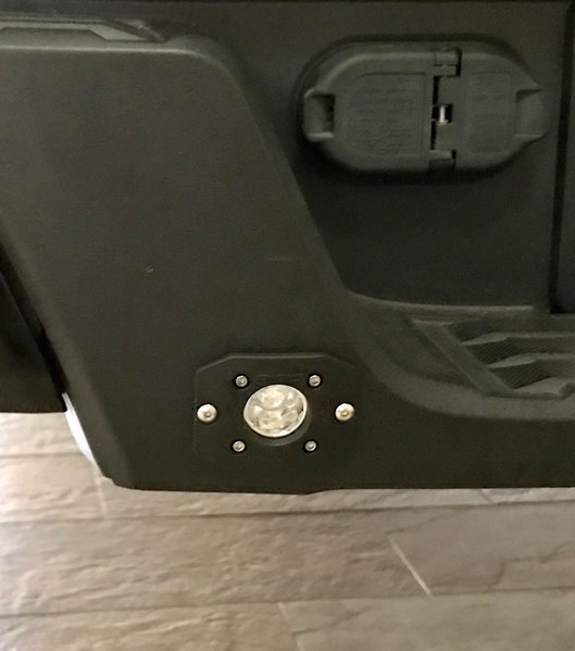

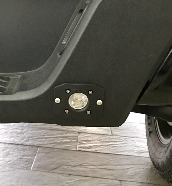

    I needed some extra lighting behind my truck at night so I did this mod.Followed @Siblue idea and added the Rigid Industries Ignite flush mount pods flood (part #20621) light output is amazing. Added a relay and a rear light switch hooked up to the bed light switch so I could choose wether or not they turn on with the bed light and this is what I endend up with. Very happy with it.

    Nice work, I love a clean install

    Looks awesome. The output with these little lights are pretty good too. Great work OP.
