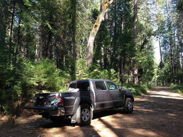

    Took it on a camping trip with the new BFG All Terrain tires- this is at Jerseydale campground right outside of Yosemite. This was our first long road trip in the new truck!

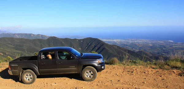

    On an afternoon drive up nearby Figueroa Mountain Rd this spring

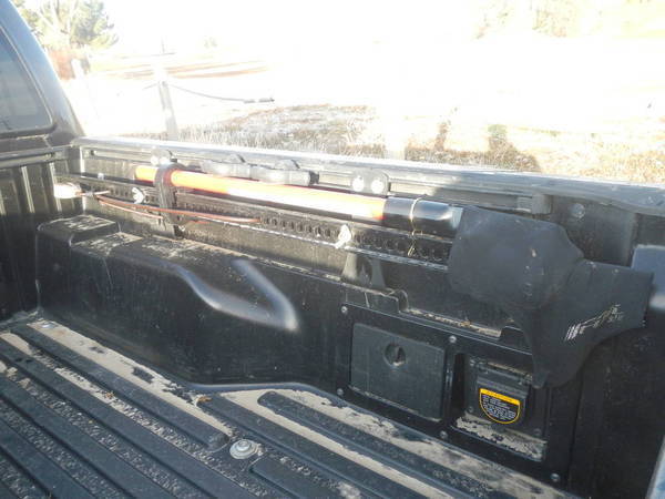

    Hi-lift installed on Relentless Fab mounts

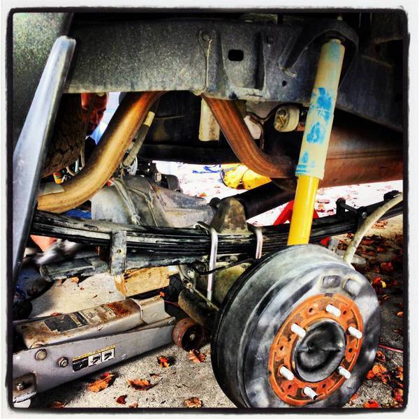

    A buddy of mine installing my Wheelers 1.5" HD AAL set- he is a one man machine!

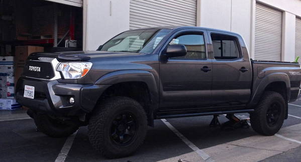

    Finally level and I'm happy with it. For now…. heh heh

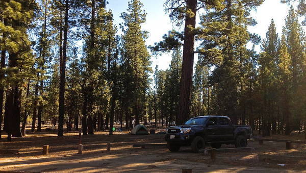

    Took the truck for a camping trip down to Holcomb Valley in Big Bear 2 weeks ago. Some cold nights but there was tons of dirt to play in. I'm not big into rock crawling but I love big scenery, exploring and driving down dirt roads, which there was plenty of! Here is the truck high above Baldwin Lake at the remains Doble Mine.
    Camping at Holcomb Valley. We were the only ones there for the first night. It was awesome. And quite cold by cali girl standards- in the 20s at night, up to 50s during the day.
