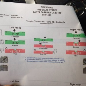

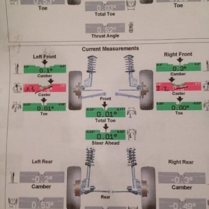

    Very productive day. Got me a Lifetime Alignment at Firestone, told them I wanted to see their work before I decided on the Lifetime and asked them multiple times if they would align my truck if I were to go up in size on tires. They promised me that what matters is the size of the rim because their alignment tools can only do so big a rim. So after an hour at Firestone, I got these readings
    Before (after I added Built Right UCAs):
    After alignment:
    The tech was nice enough to come up to me and explain that he couldn't get the caster down to 2-2.5 OEM specs (even though I asked the guy signing me up to get caster closer to 3 per what I've read here). He went back and got it as close to 3 while getting the toe to almost 0. Good work buddy! Now it drives so much better- no more crooked steering wheel! And no more steering wheel wiggle-n-shake when slowing down from hwy to about 20-30mph, oh man that wobble was horrible!

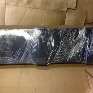

    Also, once I got home, this baby was waiting for me- Tailgate reinforcement in aluminum and black powdercoat from Relentless (nicely packaged with wrap and some foam blocks. and they threw in a free sticker. More bling to add to my tool chest). Can't wait to install it!
