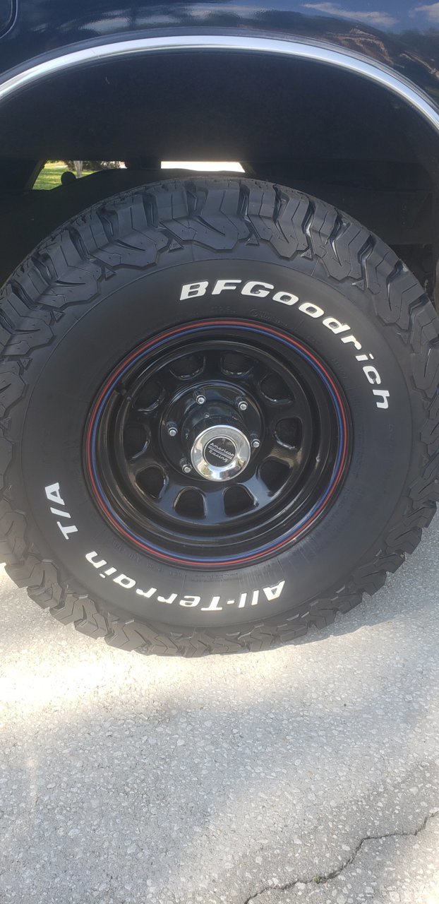

    Not sure if this helps but I just installed a set of 15x7s on my Taco with 4" backspacing and I had to take maybe a 1/16" off the caliper.

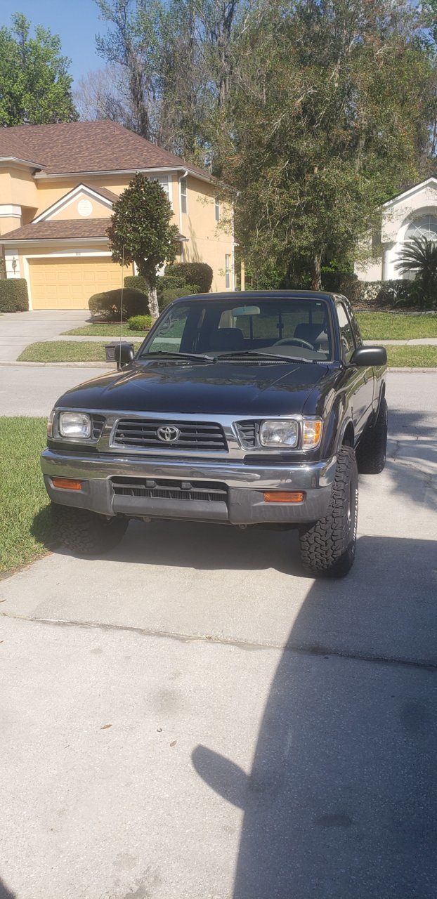

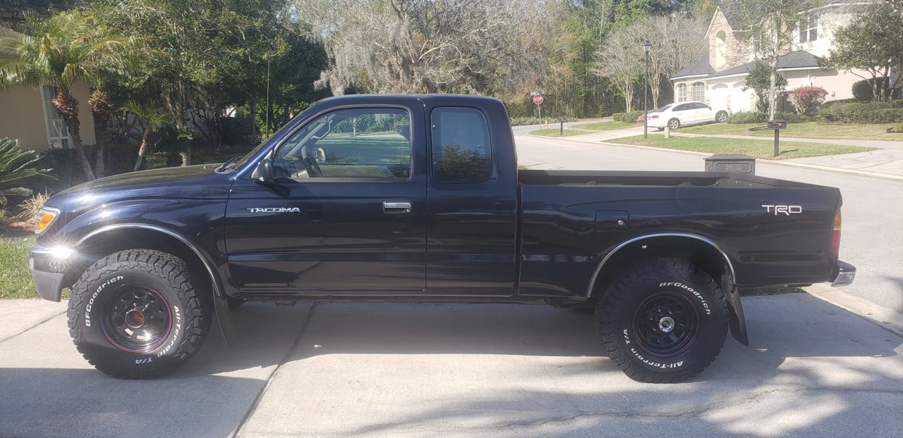

    I went with the American Racing AR767s with 31/10.50/15 BFG KO2s
    16157522152473561418973520170045.jpg 16157522392435587965877777564683.jpg 16157522870486903544856772914784.jpg

    Dang- i love the look of that. Have the more aggressive tires changed your MPG much?

    I haven't had them on there for 48 hours yet
    But I don't expect them to change MPG too much if any
