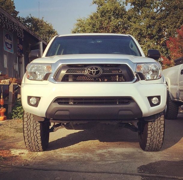

    Yep. I ran 16x8 0 offset wheels on 265/75/16s. Truck got totaled but I have a pic, not very good but enough to show you how it sat.
    Don't recall the backspacing, but if you Google Level 8 MK6 16x8 0 offset, it'll tell you the backspacing.
