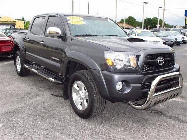

    I have finally purchase a 2011 Tacoma Prerunner double cab TRD sport with the 17 in stock rims
    I have finally narrowed my rims to the ATX Crawl 17x8in, 0 offset.
    Can anyone tell me if these can fit without putting a lift kit and with some decent looking tires for occasional light offroading, (I want them to look somewhat aggressive) Stock tires size is 265/65/17 I was wanting do do either 265/70/17 or 265/75/17 ....will these rub? Do I need to do any trimming?

    Look further in the Wheels & Tire posts here. There is a ton of info regarding tires and rims. Here is a copied post:
    For 2005+ Tacomas: 265/70/17, 265/75/16 or 265/65/18, depending on what size wheels you have
    For 2004 and below: 265/75/16
    Lifted 5 lug trucks can run up to a 31" tire, depending on the lift used.
    Compare different sizes with our tire size calculator

    Thanks. Should the offset be ok at 0 ?

    Yeah, the 0 offset will give you 4.5" of backspace so you'd be good with the 265/70/17 with some minor trimming if anything.
