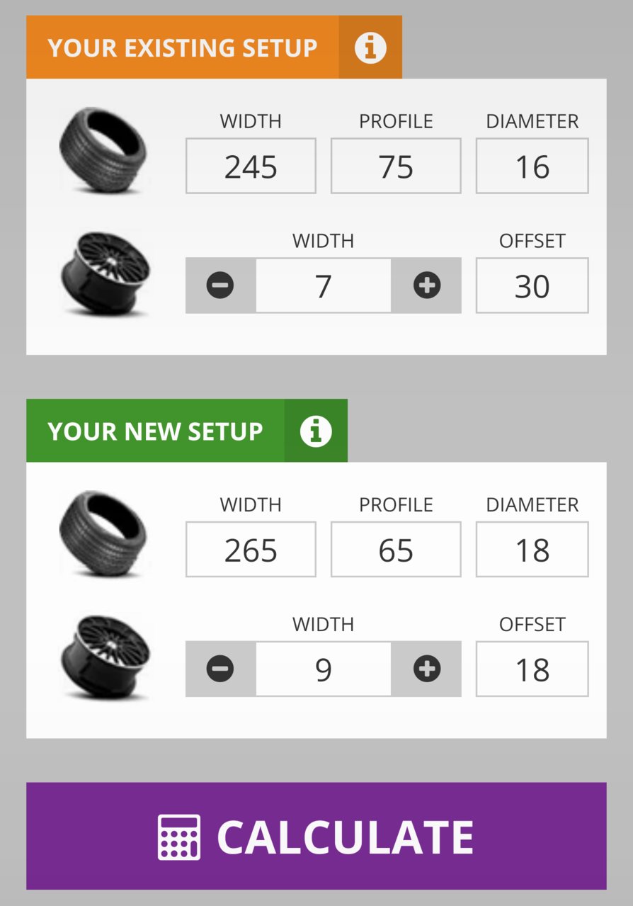

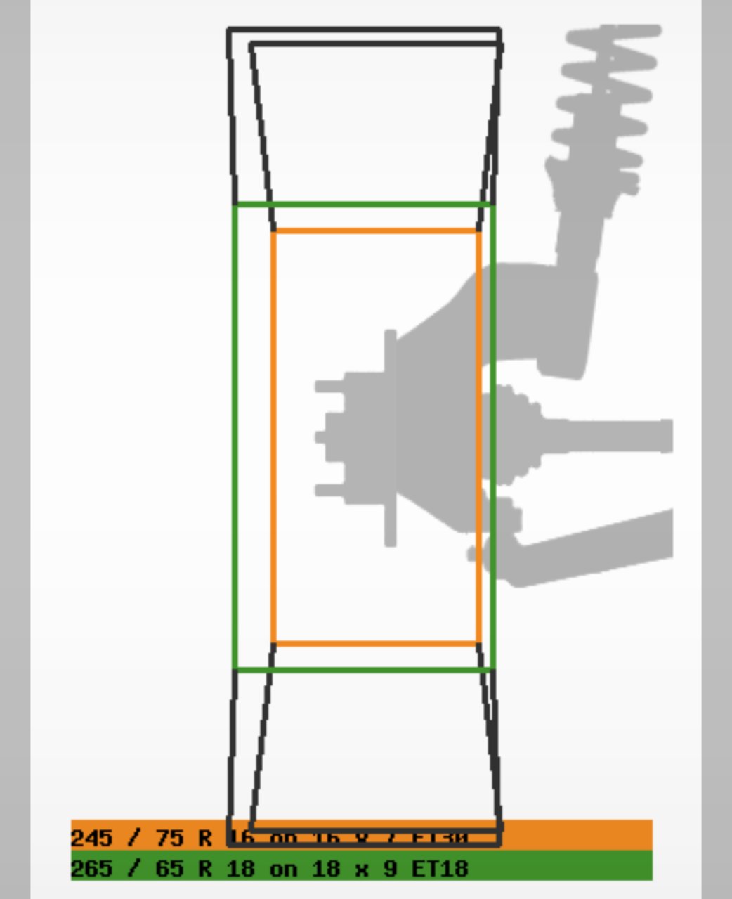

    As an example, assuming you're going from an oem 16" off-road wheel with stock tires, to this new wheel setup with a modest 32" tire, this would be the comparison.
    Seems to be about 1.5 inches of poke over stock as well as slightly closer to the control arm.
